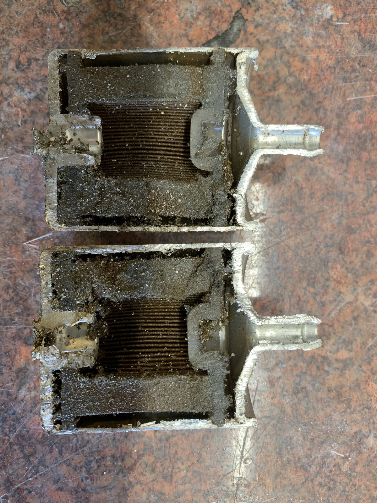

  3. So if you’ve ever wondered how a fuel filter would look internally if you fitted it in 2006 then cut it open in 2019 (I’m aware that’s fairly specific, but you never know) then here’s the answer!
    Full of crap. That’s how it looks.

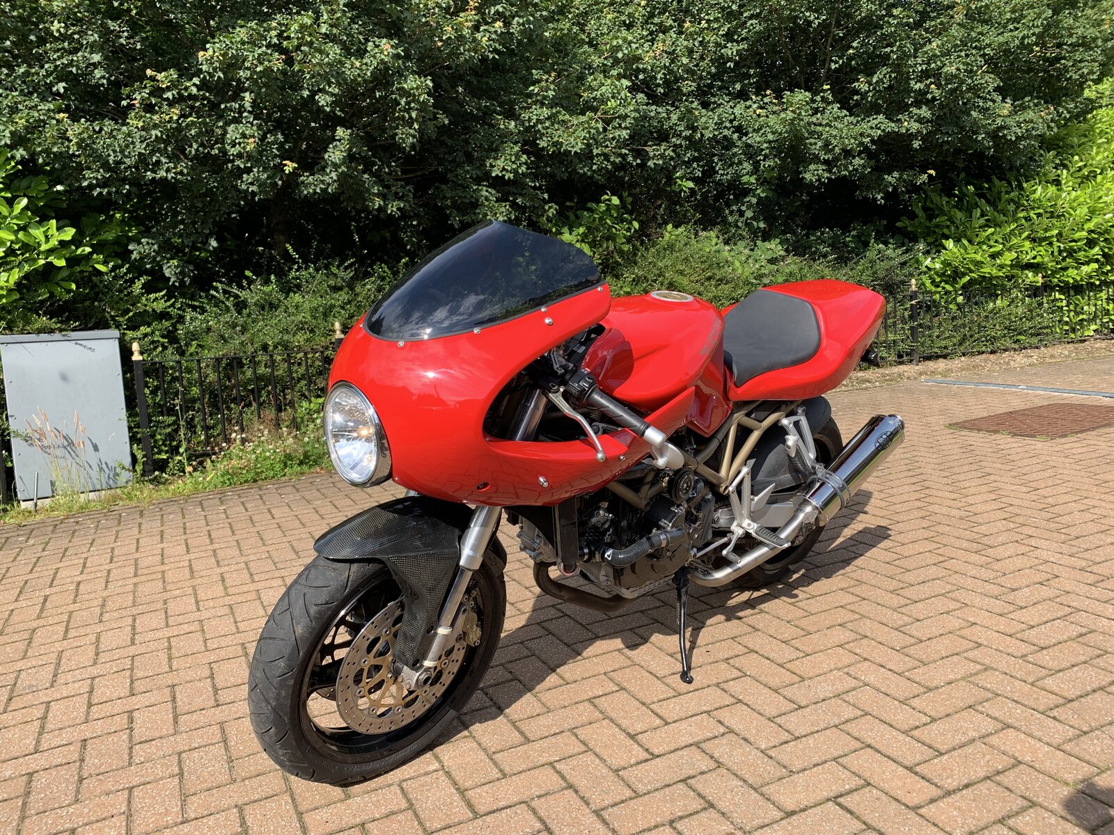

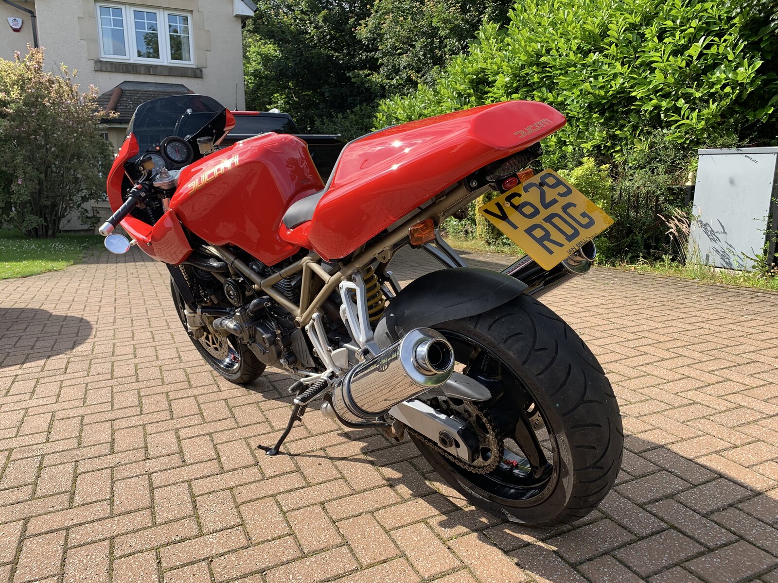

  4. 9C36E6CD-297D-4BC2-9D0E-DC8A0CF61299.jpeg 99DD972E-C8AC-4FDF-B5AE-21A7B75C1218.jpeg 9991E15D-B4B8-4810-A7F4-7BF98C0202DE.jpeg C9FA531F-CFDB-44AF-96F2-44AAB406B867.jpeg 2DB605B1-D141-4110-B4F2-7D9F75F31DDE.jpeg D7821C5C-2F2C-4951-8E77-C7D75CD8DEC8.jpeg
    Ready for the MOT, MTC exhausts really came through and sorted the link pipe issue immediately.

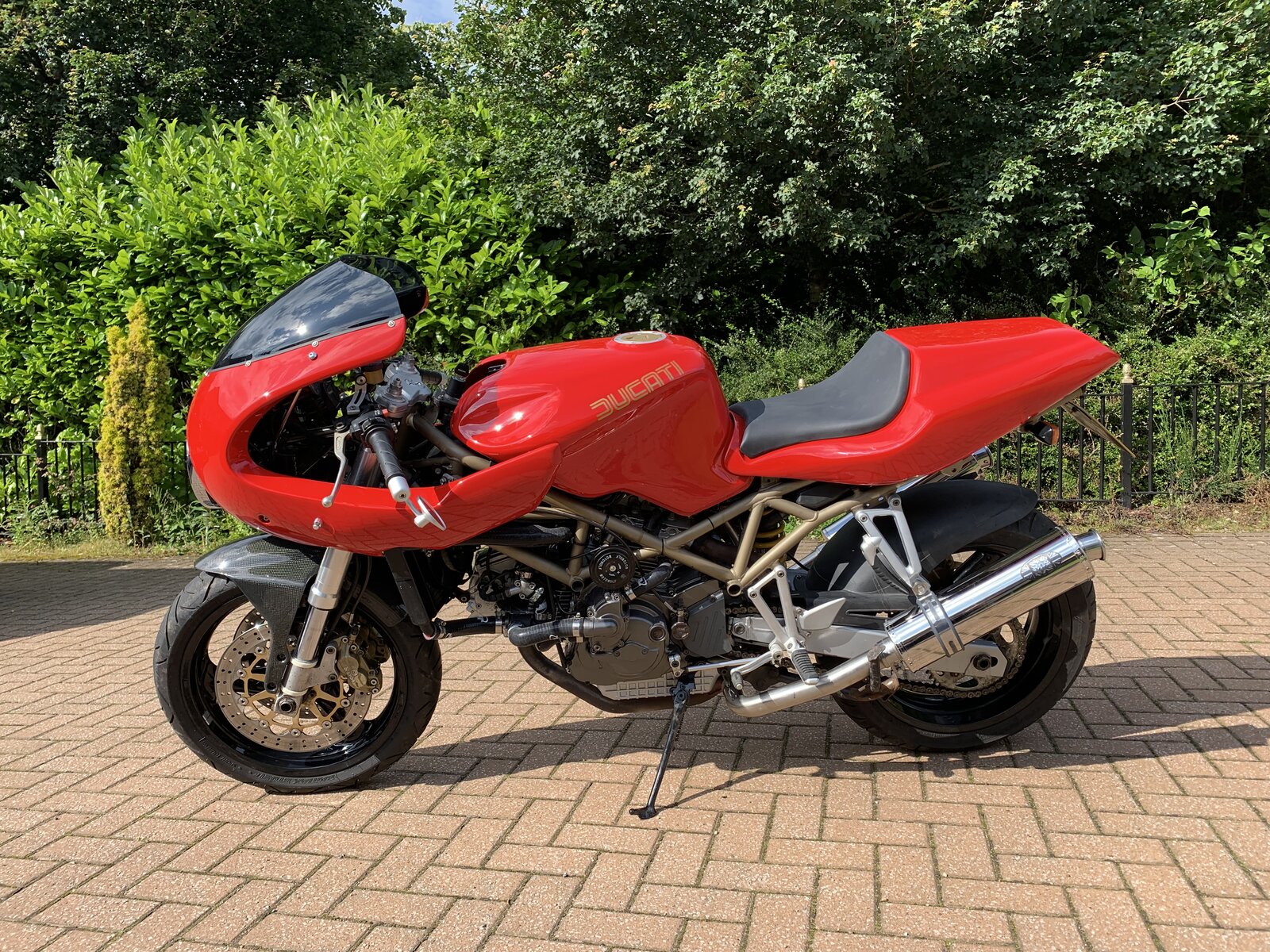

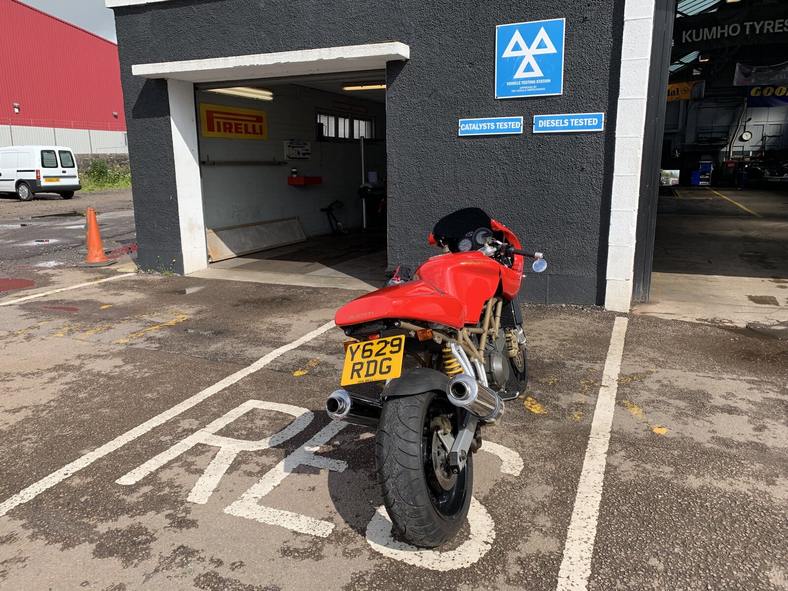

  5. 733B49DA-011D-47A1-87DE-9F360151C969.jpeg We have an MOT!
    And I found out on the way home that it’s waterproof.
    It’s the first time I’ve ridden the bike and the MOT place is about 9 miles away.
    Initial thoughts were:
    Bloody hell this is uncomfortable
    Good noise
    Surprisingly grunty
    Might have to change those bars
    The noise is even better up the Rev range!
    Think I saw some Tarrozzi adjustable bars that would fit
    Brakes and handling are good
    I’ll also need to look into a meatier battery, this one is a little marginal for starting it.
    Oh, and new bars. These ones are not friendly.
    Otherwise I’m happy with the bike, it certainly draws more attention than I’m used to!

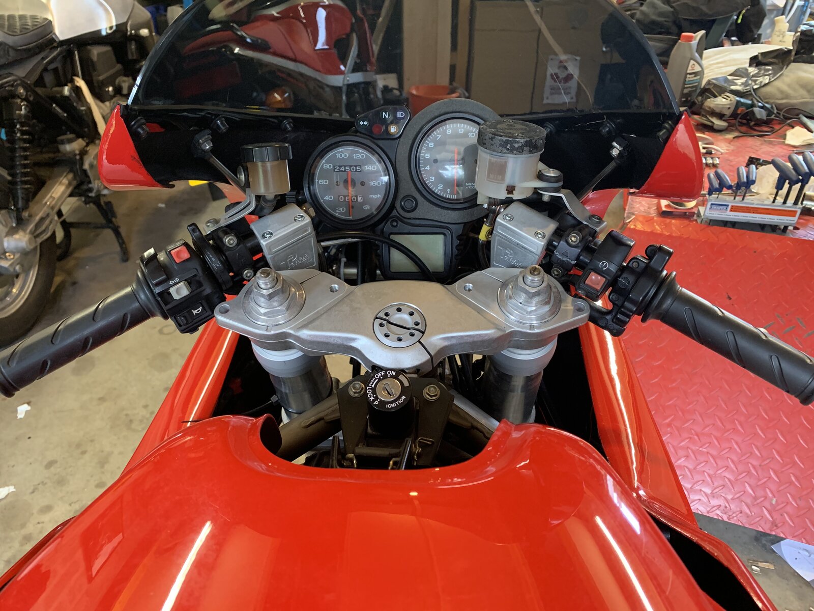

  7. I bought new bars to make the bike a bit more usable on trips that were longer than about half an hour
    They’re a bit tight on the upper fairing but far more comfortable in normal use. It’s taken the bike from being stupidly uncomfortable to moderately uncomfortable.
    I did an 80 mile run this morning and it’s fine at speed. The new bars allow more leverage so cornering is improved too.
    They took ages to get lined up. Turns out the good point of adjustable bars is that they’re adjustable, the bad point is adjusting them in about a hundred different directions to clear the fairings at both ends of the sweep, then trying to get them both the same.
    Annoyingly I managed to snap the clamp on the front brake during installation!

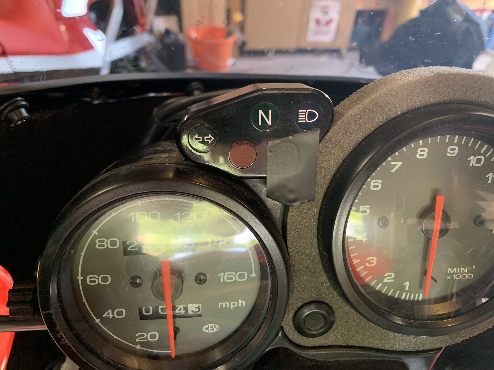

    When I filled up the bike today the fuel light stayed on, and the gauge didn’t register.
    I’m not sure if it’s a stuck float or something more significant.

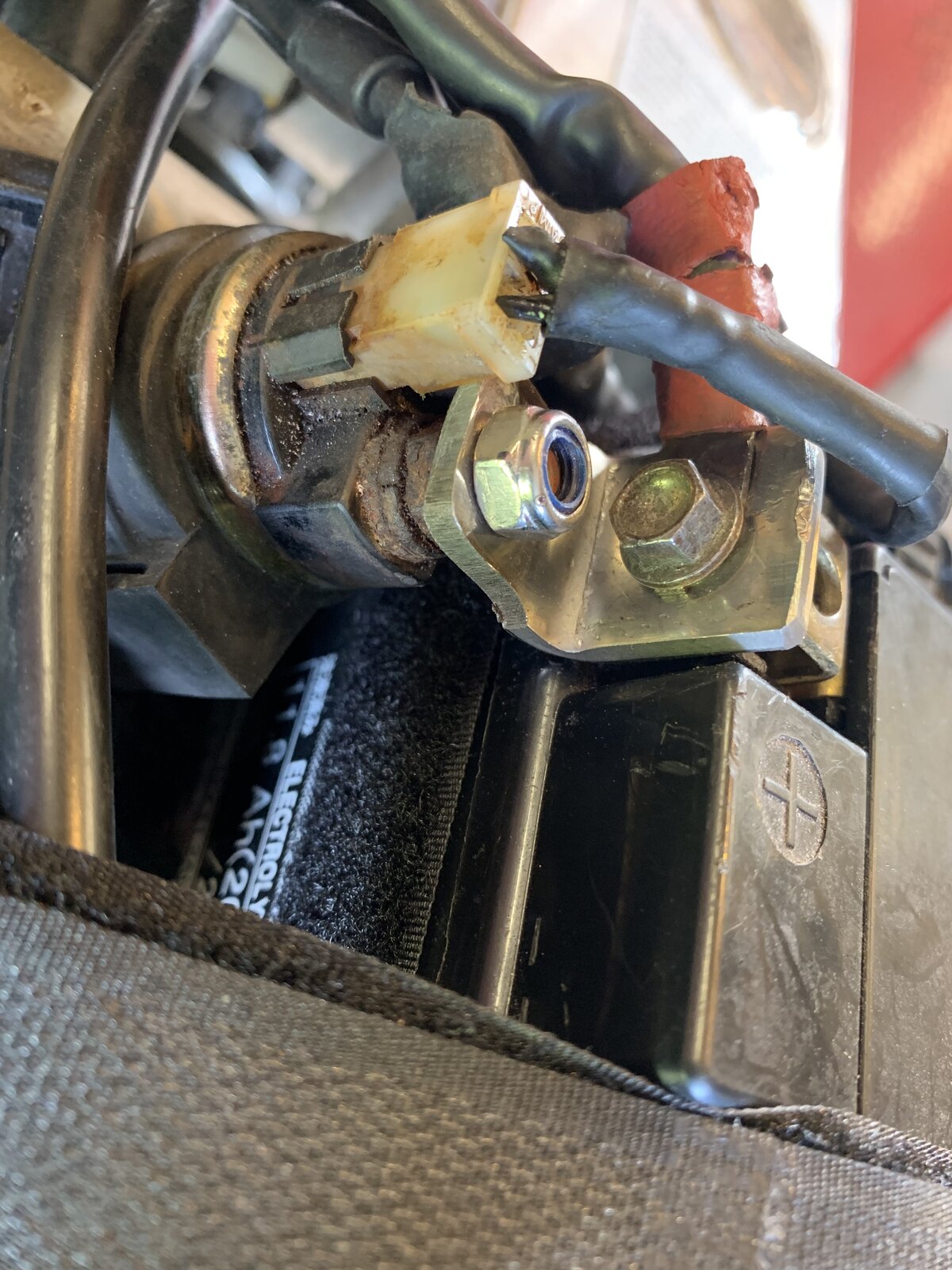

  8. I decided to hard link the starter relay to the battery to get rid of the last section of old wire.
    Starting has been a little reluctant a couple of times, I’m not sure if this was the culprit or the battery isn’t big enough so it’ll narrow things down at least.

    Decided to go low tech with the fuel light until I’ve used enough petrol to be able to lift the tank and see the internal connectors.
    Seems effective so far!

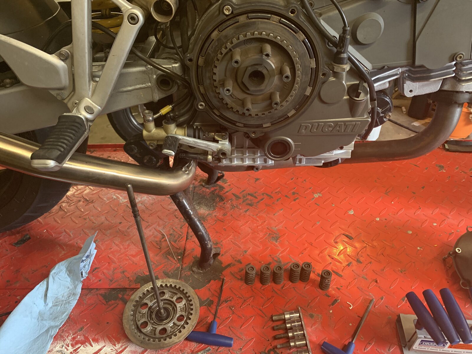

  9. When I bought the service kit a bearing for the clutch was also included, I didn’t fit it at the time because it looked like the one behind the clutch basket and loads of work.
    I’ve been getting a little high pitched whine from the bike, only when the clutch was engaged and while accelerating so I had another look today.
    20 mins to fit, mainly spent removing the old bearing and looking for the right sized O rings.
    Really not a bad job at all. Made loads easier by heating up the carrier with the heat gun then using an appropriate socket as a drift.
    The dogs that go into the basket are looking a bit battered, but I’ll just run it until the clutch starts to slip. It’s certainly working fine just now.
