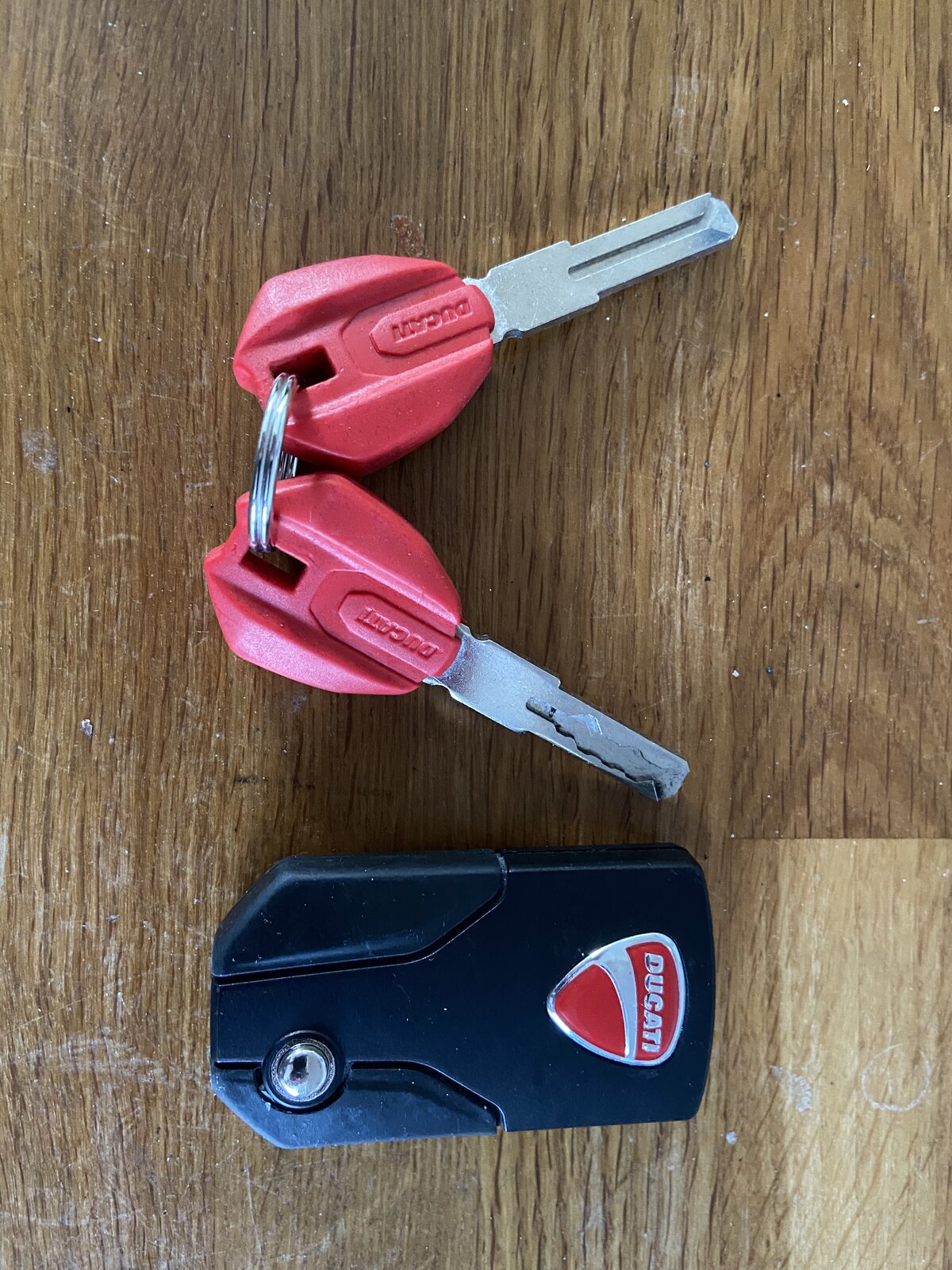

  11. 16E4553A-2721-4CE6-90E6-9FF200AAA851.jpeg My ‘13 bike came with 3 keys, 1 red cut key, 1 red blank and the remote key.
    I would contact a Ducati dealer and ask them the cost implications of a bike with a missing RED key?
