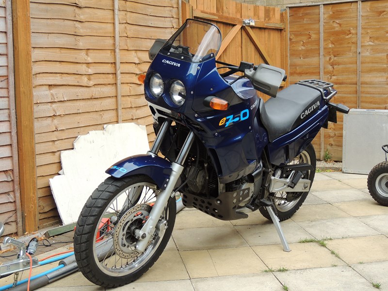

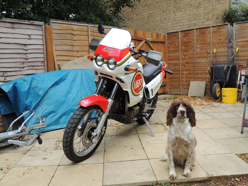

    lol, 5 !!!!. nice one Chris.
    Nick, Hiya, they are fairly std bikes ( well the LE is in bits ) and there are already some great pics on here.
