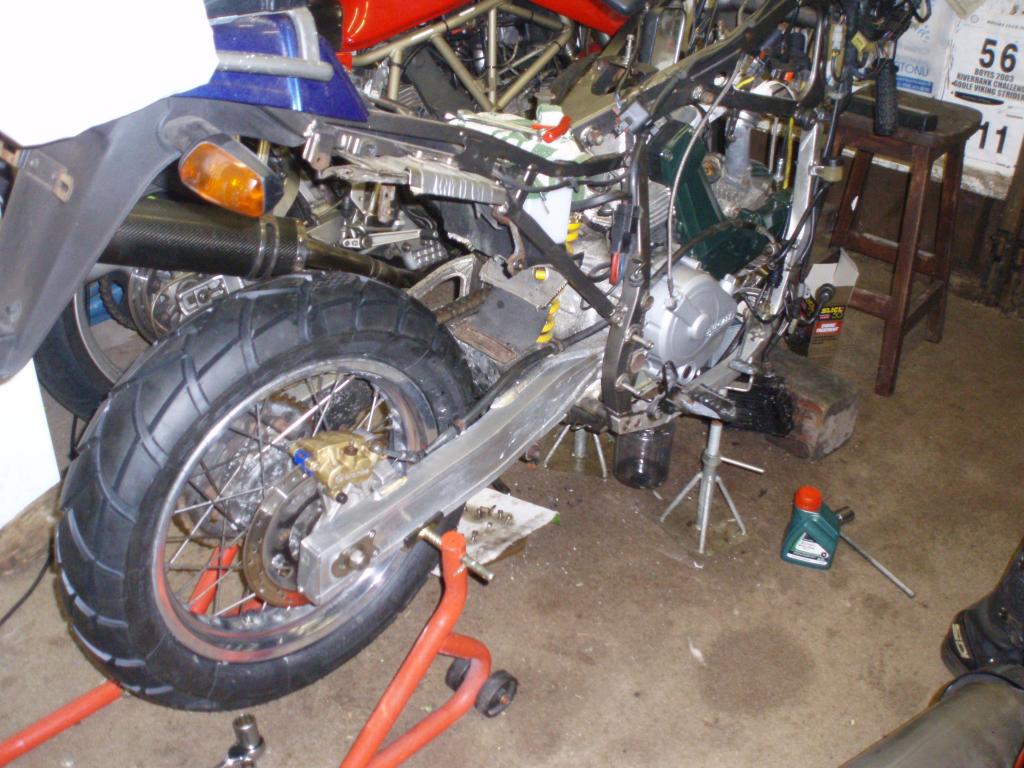

  7. Elefant Rebuild Starts
    Hi Guy 'n Gals, we have turned the corner and the rebuild has started, albeit slowly. Clutch and Alt cover sprayed up with silver Hammerite smooth, look fine, belts tenioned and covers back on. These I have sprayed Hamm smooth Green, - dont ask me why, seemed like a good idea, and it is my bike !! Rear brake master renewed, all bled through. Fork lowers to strip of paint tommorow; I have bought a tin of the real macoy stripper, it has got more health warnings than a night out with my sister, so it must ge good ! Next I will fit the carbs, and am wondering wether to go for a pair of K&N cones, rather than the monster sized air box - any comments ?? Happy New Year - with lots of safe miles to All, cheers dp

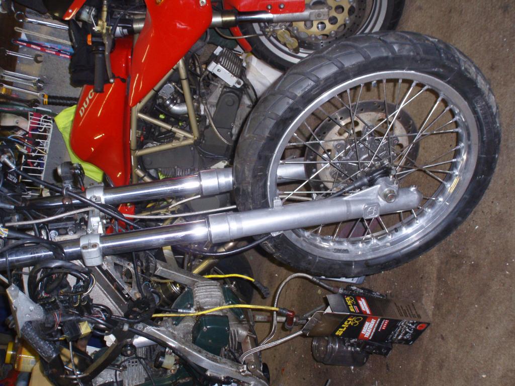

  15. Been Busy
    Best Wishes for the New Year Guys n Gals, I have started off as I mean to go on, been busy in the garage !! Got the fork legs stripped and buffed up, look OK and I will keep them bare, polished ally looks good, and spraying up a cylindrical shape would be tricky. Got the front wheel back in and- oh bums - the disc looks a bit ropey. :biggrin: Anyroad, and thank goodness for impact wrenches, both wheels are now disc-less. Still, no rush, and will let you know where I get discs and new bolts from - cheers dp
