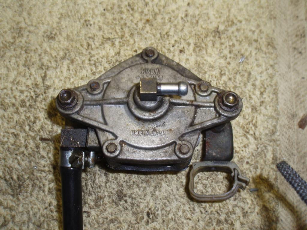

  2. I'll pop one on later - had to do the discus ( snail infetation ) , and now a bottle of Tesco's finest calls ! For once I engaged brain; the bike only needs a pump when the fuel level is below the carbs !! Filled her right up, direct pipe tank to carbs, and back in business !! The cause of the poor running was a shorted out plug, some crud had bridged the electrode !!

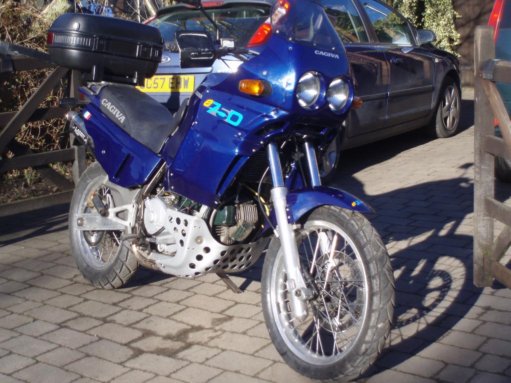

  3. MOT'd at last !
    Another cracking day to make up for the bodge yesturday; she sailed through the MOT !! The Heflump rides well, not that you can do much on damp slippery roads !! I have bought a Mikuni pump, (ER500) for 12 squids from ebay, it should do the job if not an exact replica. There is aslo a guy there who looks like he has broken a 750/900 so I have enquired there too. The bike dows seem undergeared, ( low speed high revs) so might juggle with sprocket sizes to bring the revs down a tad. Anyway here she is in all here glory, bit of a messy snap with the ford in the background, but you get the idea.

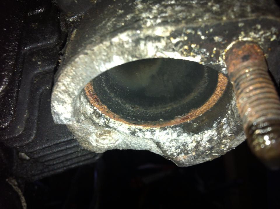

    The engine is out and ready to go to the painters. Still a bolt stuck on the front engine brace/frame with no intention of budging.
    Also noticed a huge bite out of the aluminium cylinder at the front exhaust mount. Luckily not the studs but enough to mean a new cylinder I guess.
    I hadn't banked on an engine strip but think I am now going to have to bite the bullet.

    Pop a photo up for us to have a butchers when you have a mo ! regards dp
  18. The offending article
    Here we go:
  19. you have done well to persevere this far.. I have two more if you decide to go further as i'm not sure when I will find the time now. I quite understand you being tempted by plan 'B'. Don' forget that above damage is on head ans so can be fairly easily removed for building up with weld.
