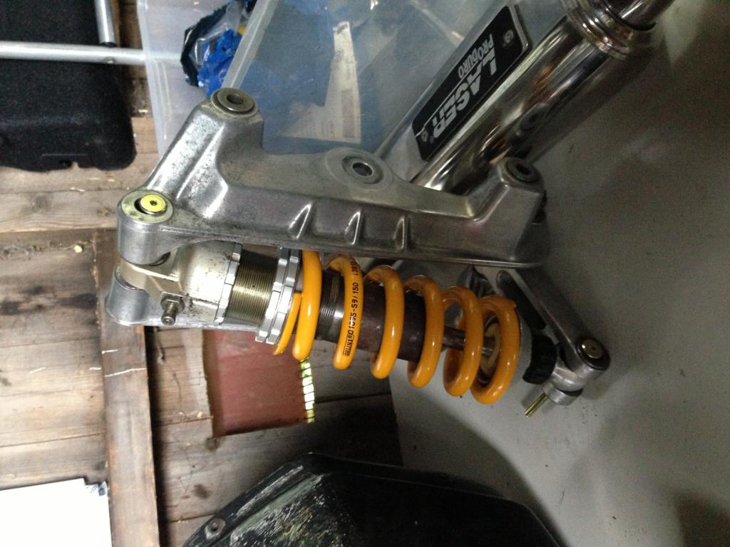

  4. Just got my rear shock back from its rebuild. £360 but completely rebuilt. Had the remote reservoir removed too.
    Going to start rebuilding the rear linkage but need to send the swing arm off to be stripped and reanodized.
    Woundering whether to just send the engine off to be rebuilt rather than attempting myself.

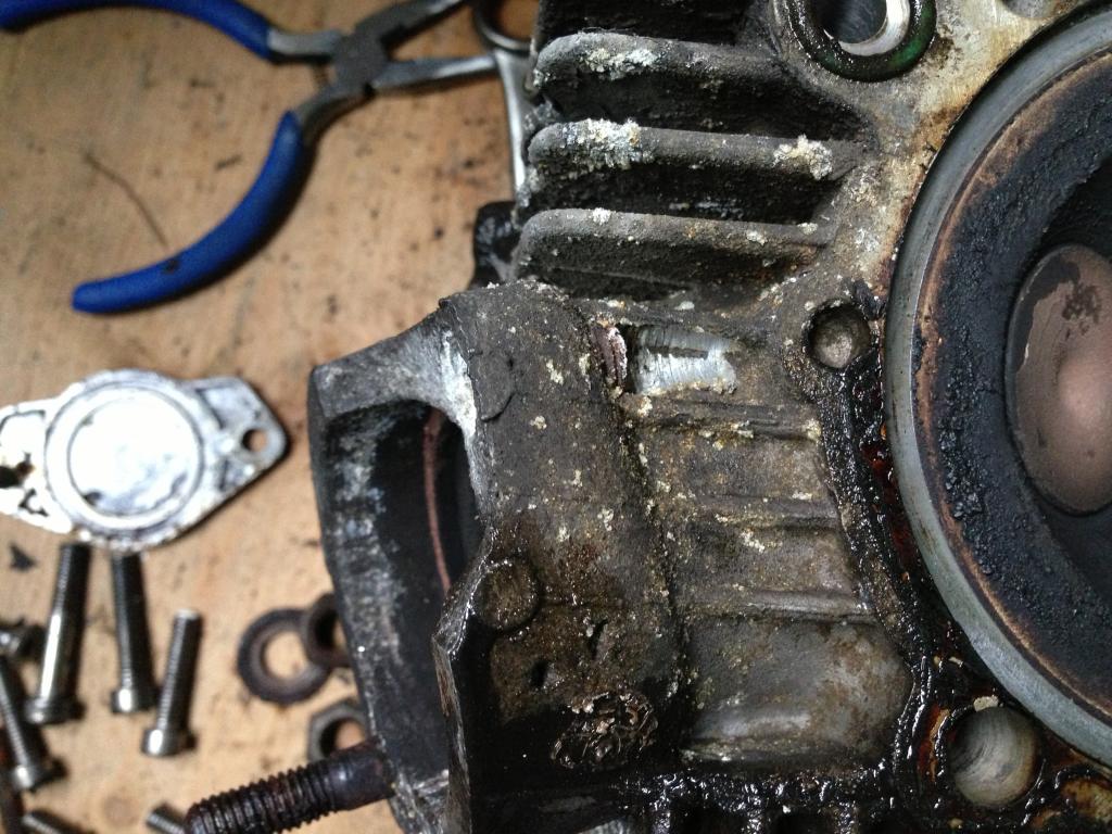

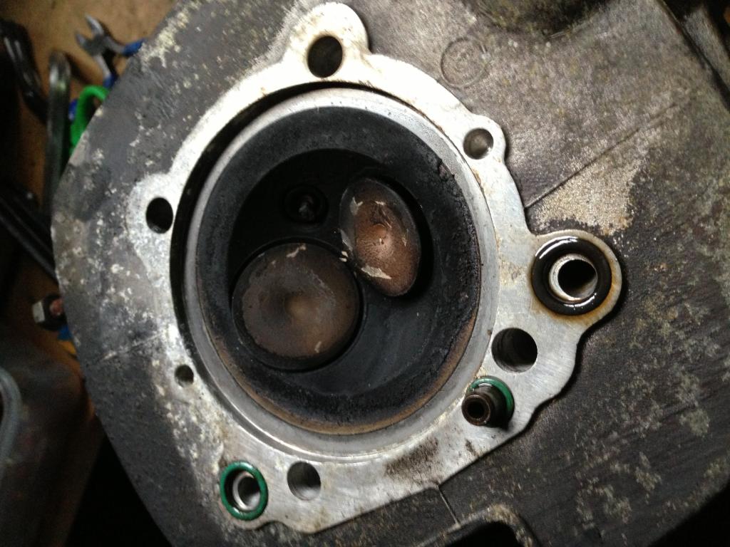

  5. Couple of hours in the garage this afternoon and managed to get the heads off the cylinders. Valve clearances were well off.
    Can see where a stud has obviously been drilled out previously. That'll be how the large chunk was missing of the exhaust outlet.
  6. And the valves
