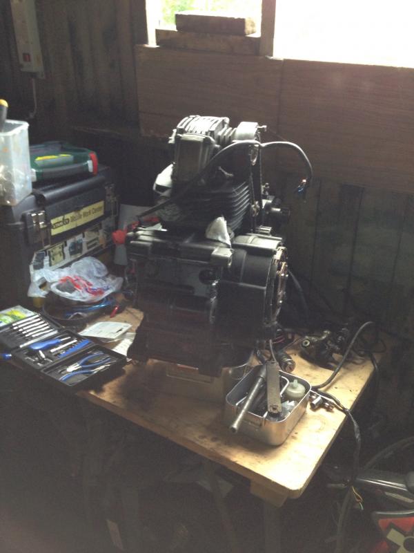

  4. This is where I'm up to:

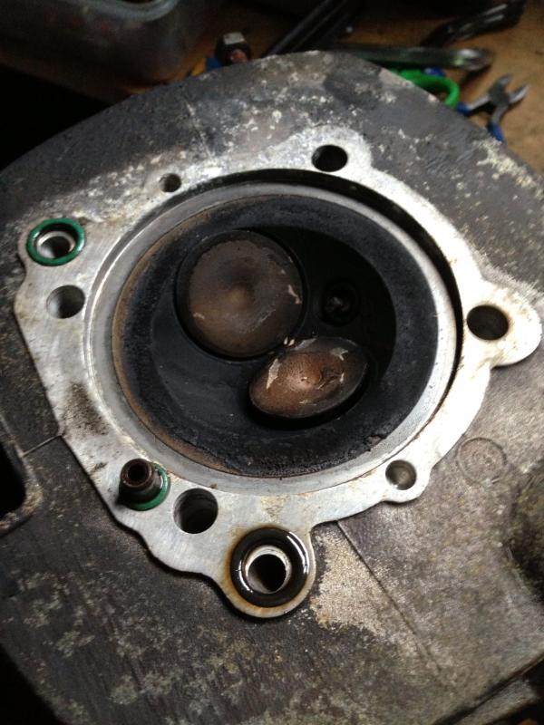

  5. Here's the heads off:
  6. Any progress is good Matt! Yes I'm happy with the deal, it's got panniers, top box, front crash bars, Garmin gps, a complete spare set of bodywork inc tank, a complete spare exhaust, and a few other odds and sods. I reckon I could sell the spares and have a cheap Elefant! The bodywork needs some minor repairs and paint, but I got a spare set of Lucky decals with it so I might paint up a spare set for the bike over the winter.
