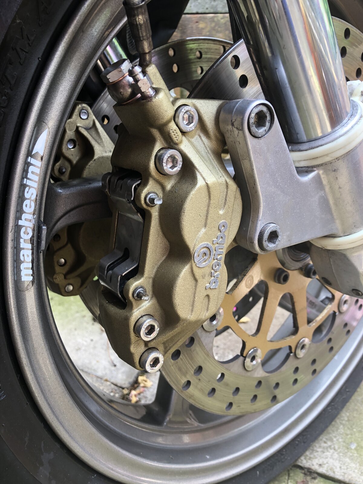

    Back to the subject in hand. I replaced my calliper pinch bolts with A4-80 from Accu. To replicate what you have on the machine you will need the low profile cap head bolts but Accu only do the regular A4 in this cap profile, and from memory they torque to 35 Nm. Also interesting to note that the low profile cap head and the button head bolts have a smaller hex (by 1mm) than the regular cap head bolts.
    The regular cap profile bolts don’t look too out of place.
