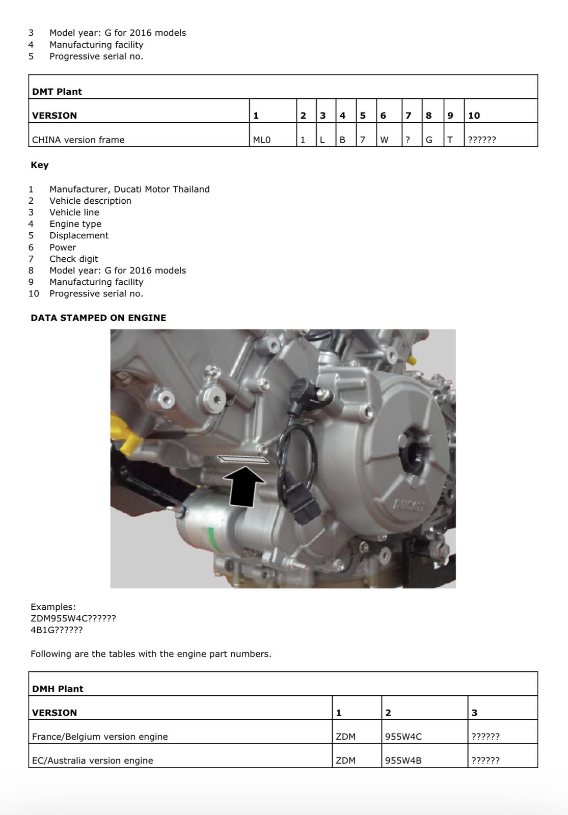

  1. Engine number decode
    ZDM is the WMI (World Manufacturer Identifier) for Ducati’s produced in Italy
    Z = Italy
    DM = Ducati Motor Holding. (Some people have decoded the M as Motorcycle- this is incorrect) The WMI code for Ducati Motor Thailand is MLO for example.
    Next comes Engine capacity
    eg 998
    Then Cooling type eg W = water cooled
    Then Number of valves (if present) = 4
    The final code before the production number has been described elsewhere as the fuelling type eg C=Carburettor. I’m not so sure about this.

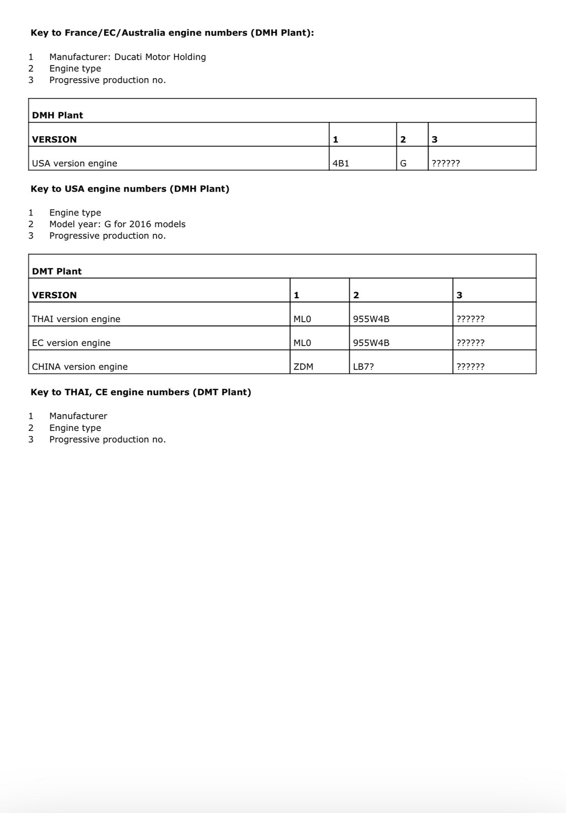

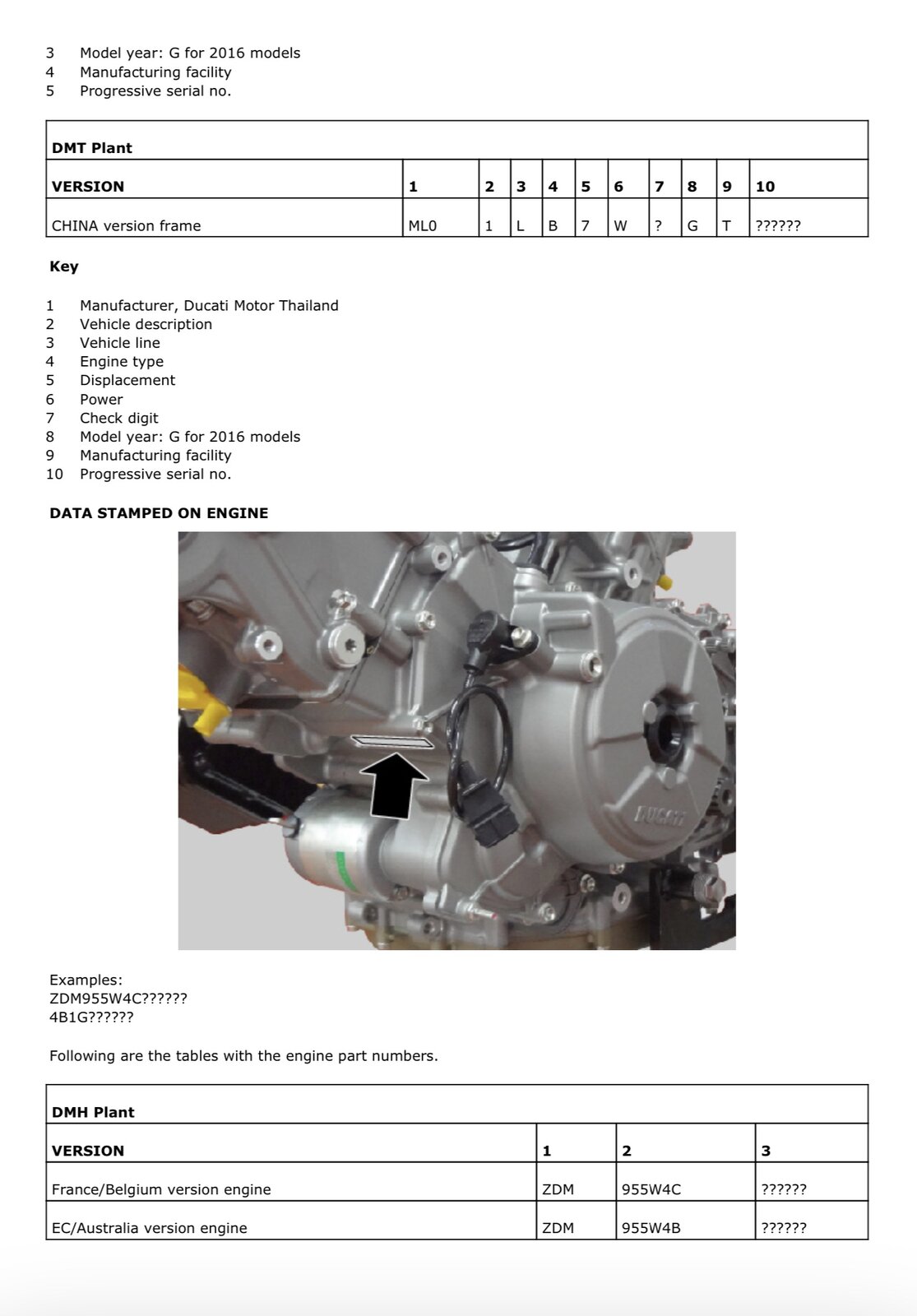

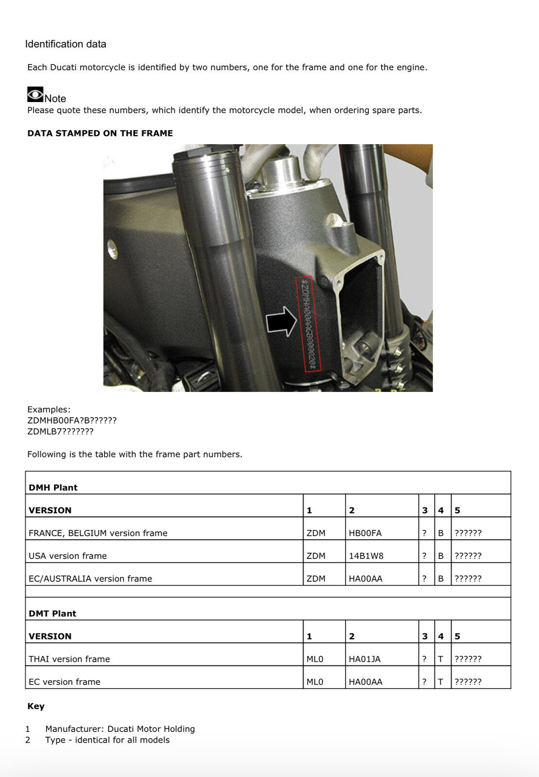

    Looking at the service manual for the 959 all of this is explained - and according to that C would denote a France/Belgium version engine and B an EC/Australia version engine.

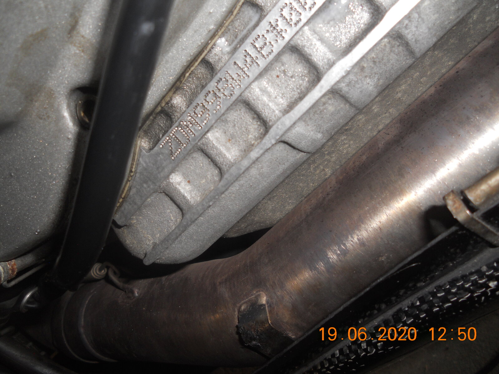

    Take a look at the attached and see how you interpret it.
    F76A0998-FB0D-4DD1-8209-27CF6BF4E7F1.jpeg 5BEDA669-FC7D-4C8E-B40B-71B46733FDDC.jpeg B9B26C83-DFB9-43ED-8E39-3CD4009F463C.jpeg

  3. So part 2 is deffo the engine type eg 748W4B but that would seem to indicate the B denotes an engine destined for EC/Australia but then, as an example 748s sold in the EC had W4* whereas 748Rs had W4B. Likewise 998Ss have W4B but 998s have W4* afaik, and I’m presuming 996s have W4* but the 996R will have W4B - can anyone with either of those confirm/deny that please?

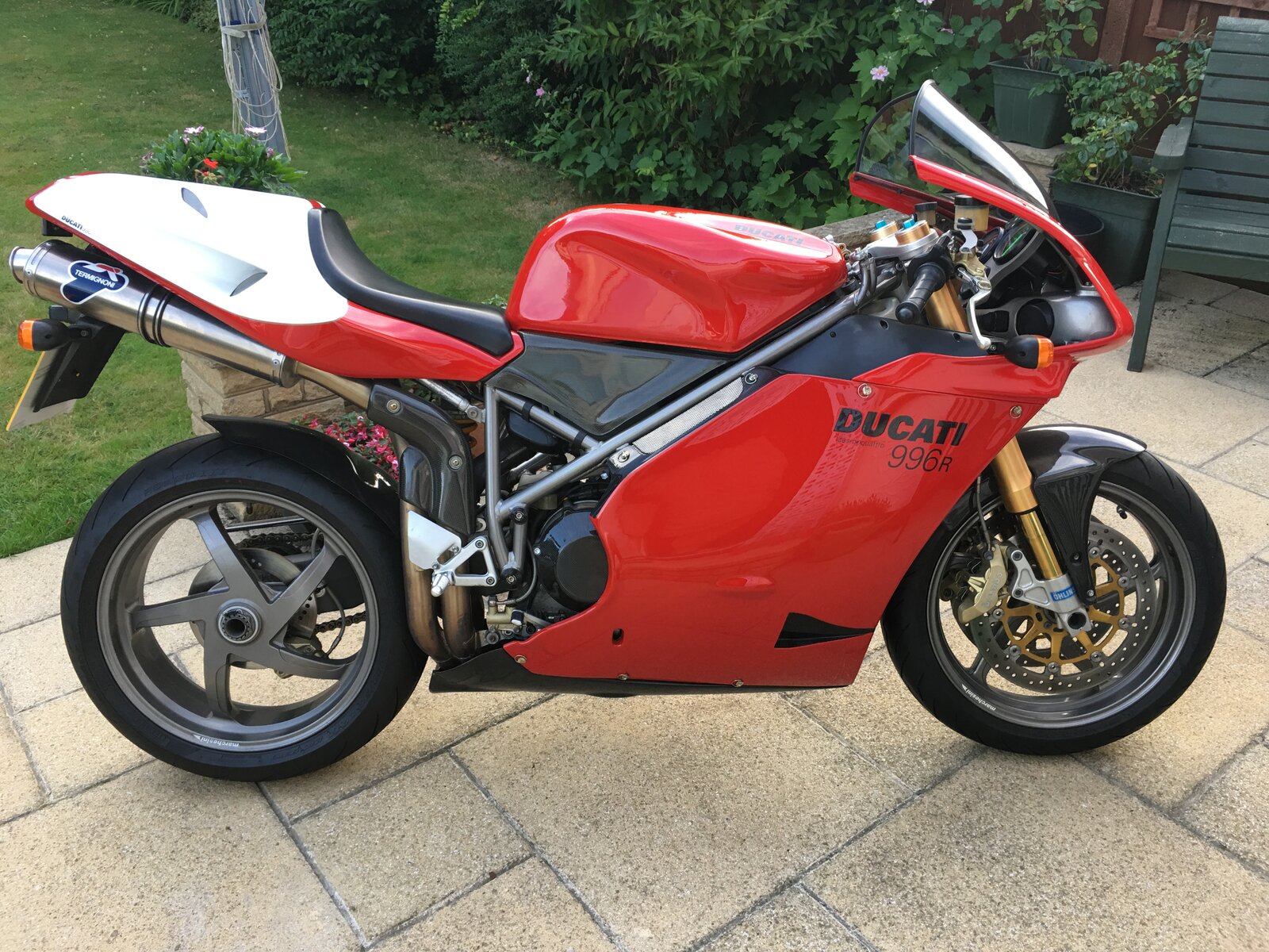

  9. 996R I think.
    @XH558 ?
  10. yup my 996R has ZDM998W4B....
  11. 996R - I’ve got a B

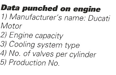

  14. My 2000 748R follows the pattern of ZDM748W4B etc.
    The 2000 748R Workshop Manual states as follows:
    • Useful Useful x 2

  18. Next observation. Looking at your 749R engine number Ricky and looking at @LiveFast...... ‘s post #21 above it would seem to indicate W4C was an engine that was destined for Belgium/France, did yours come from there ? Or was it a UK supplied bike?
