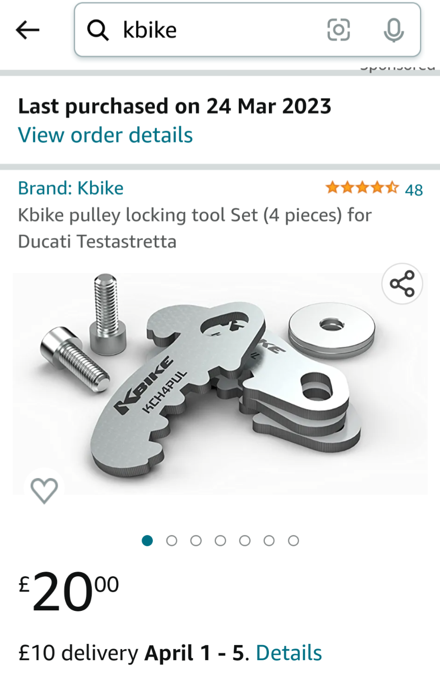

  5. Noticed that natty gadget too:upyeah: - just ordered from Amazon...

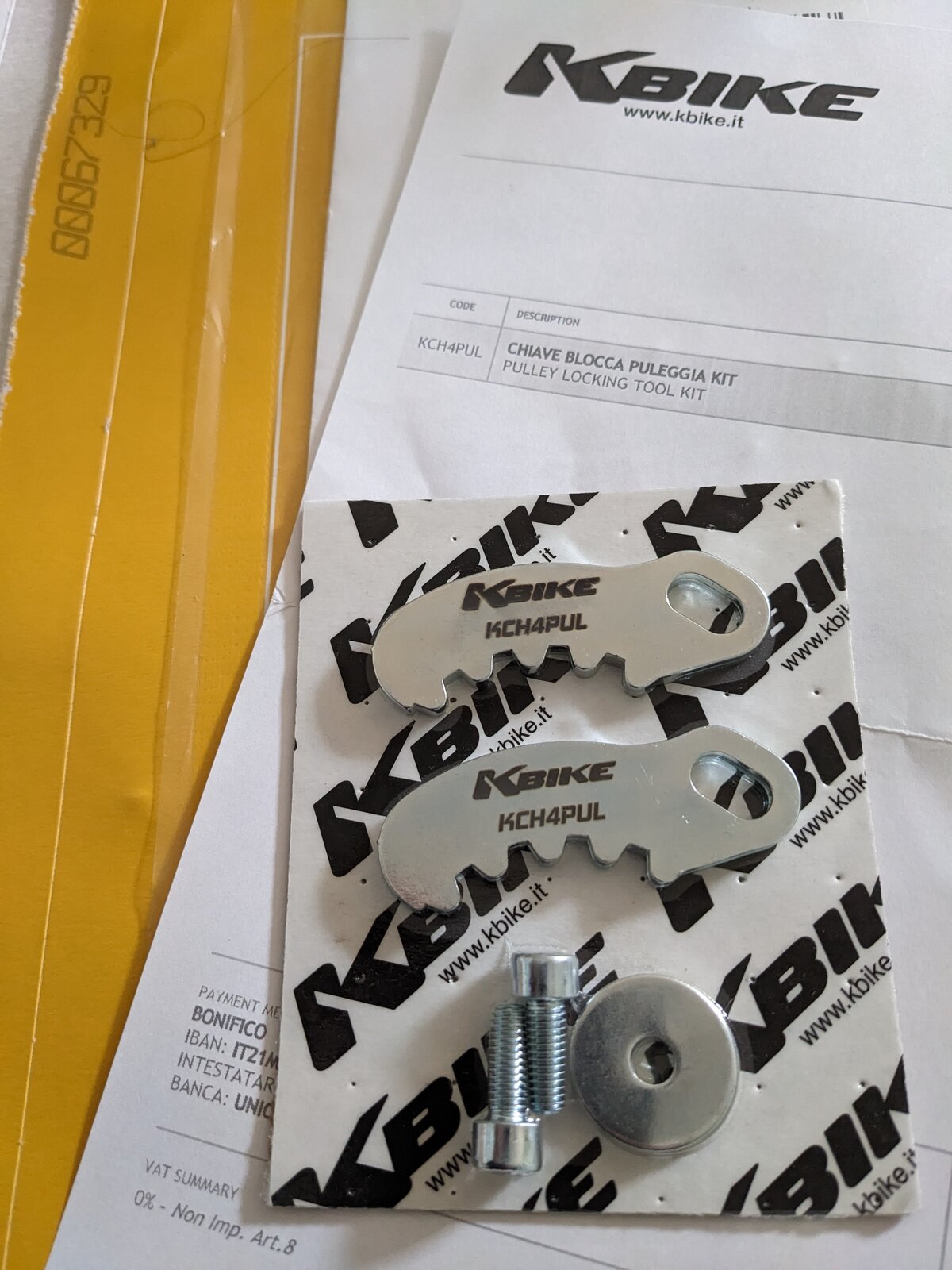

  8. Received today via DHL:)
  9. Amazon - but came directly from Kbike. £30 incl delivery and the Kbike paperwork shows €28 (no Italian VAT), so I think I got a good deal:upyeah:
  10. You did,I had to dremel a little out of one of the pieces to get the holes to line up,all good now,doing the belts this weekend,should be pretty straightforward…..
