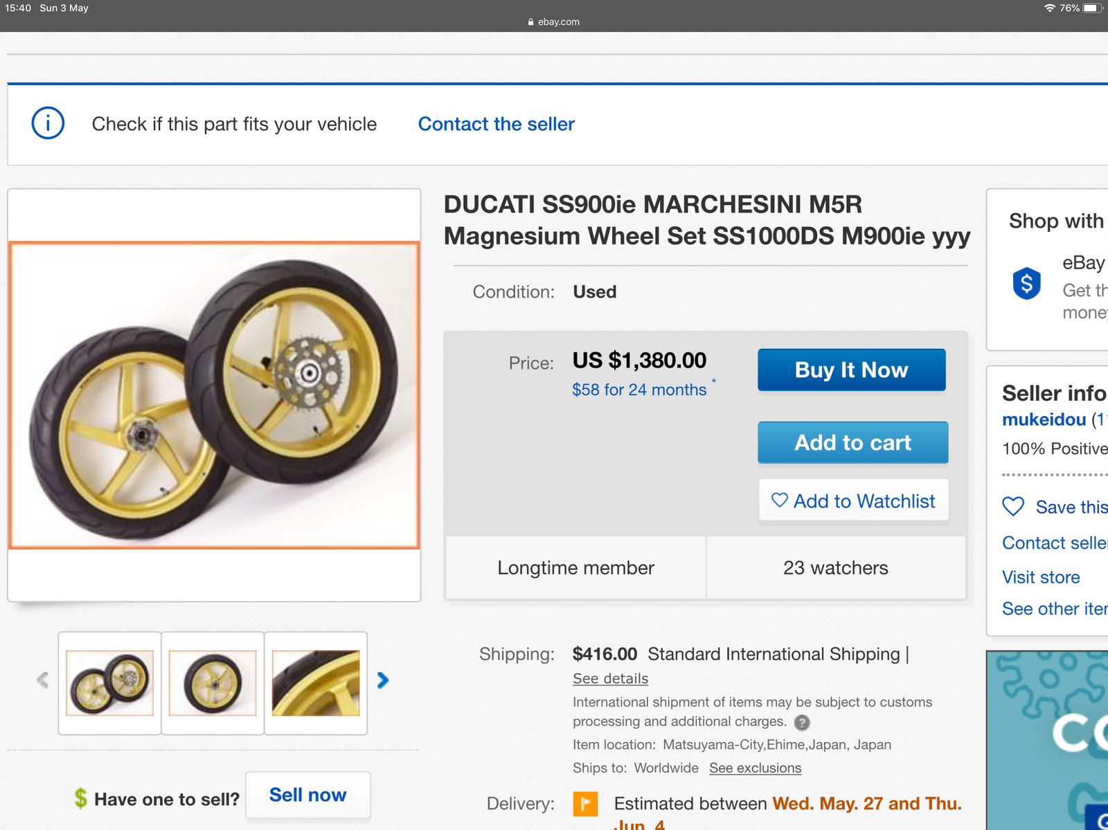

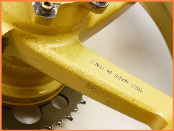

  2. Well after a bit of trawling, I have found the wheels. Not any close to understanding any key dimensions yet, but I have something to refer to at the Duc dealer now.
    That’s why there are no makings, as this printed information has been painted over. Of course..

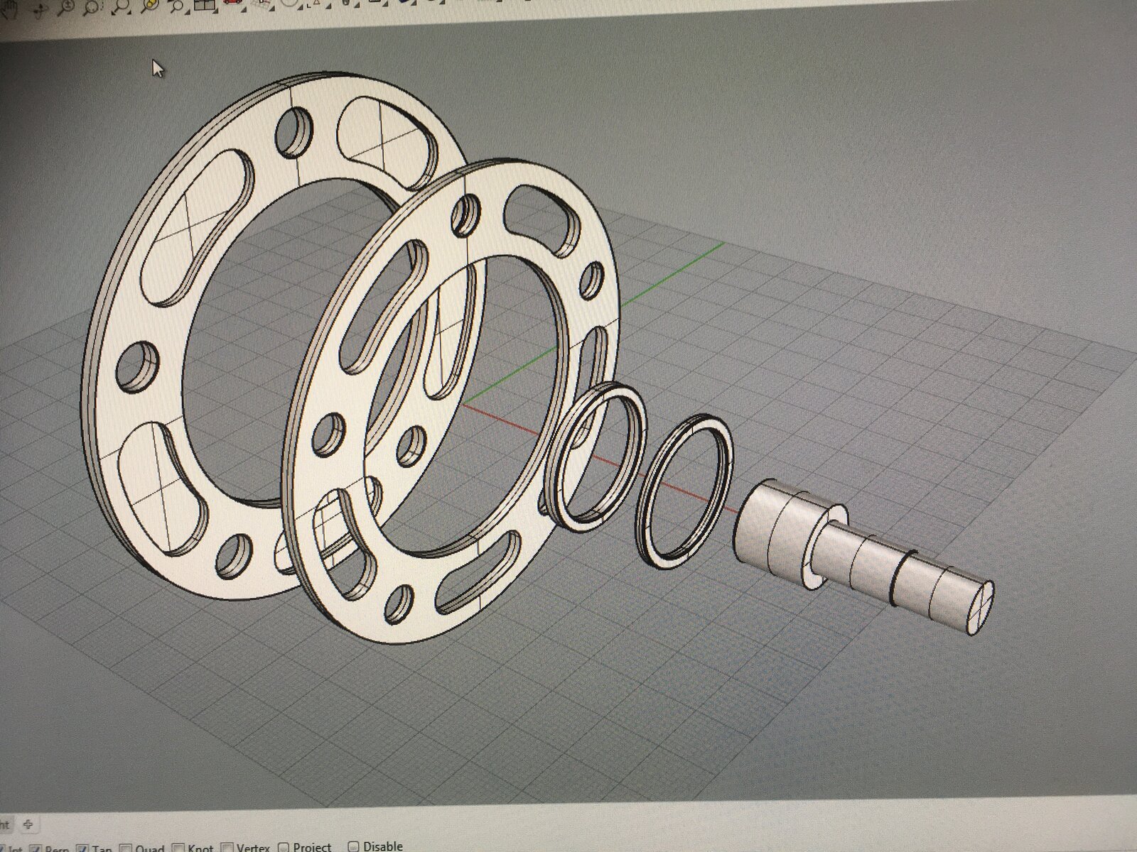

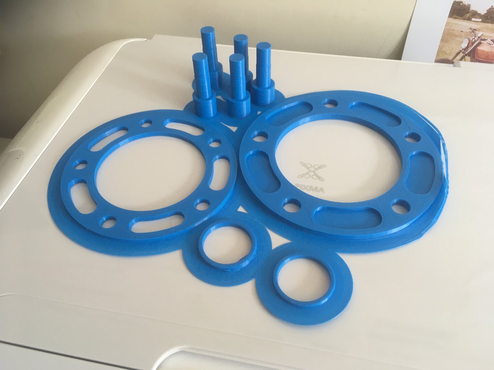

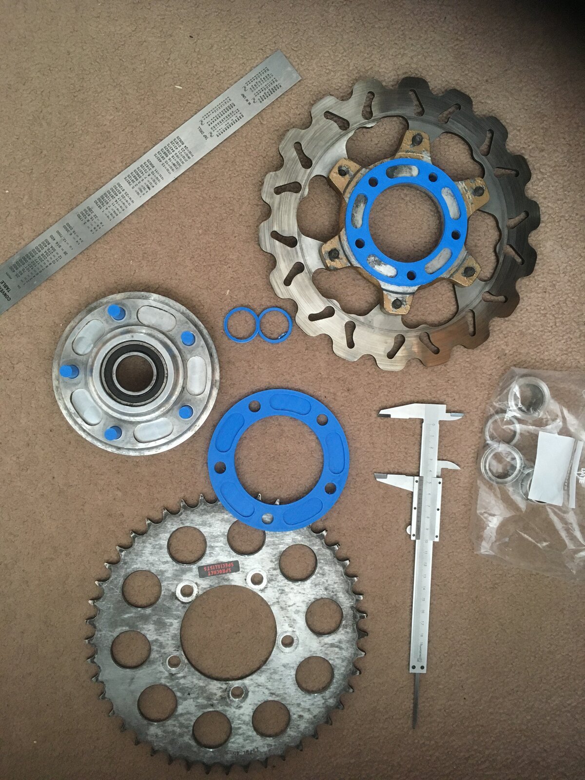

    I have now measured, measured again, made some 3D printed spacers to check the assembly and alignment.
    I am happy now and am getting some new spacers made to include the tweets I have made.
  9. This was part of the investigation checking the stack of the wheel and play with the sprocket and brake offsets to establish what is aligned correctly.

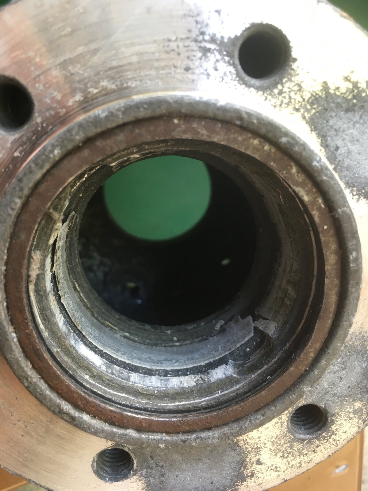

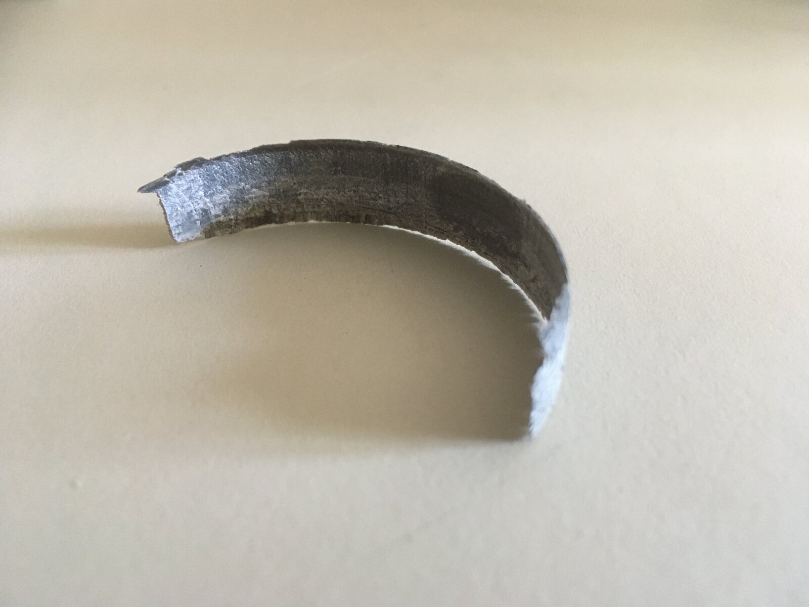

  13. Oh dear. After all that faffing around getting the wheel alignment right and learning about magnesium wheels in preaparation for correct treatment and paint.. it was time to knock the bearings out and start the strip and refinish... the bearings did not want to come out.. because they have been bonded in place..
  14. 0.5mm ‘shell’ of what looks like epoxy glue...

  16. Can you not turn them out and go for a bigger bearing. There might be one that is close to the original size or you could get some ground to suit? Perhaps turning the rim out by 2mm diameter is possible and fit a steel or bronze sleeve to accept new bearings. Seems a shame to scrap those nice mag wheels.
  17. Like your thinking, I was on the same idea today. Went to visit my local engineering shop. We measured up the thicknesses and decided, front wheel could be honed and fitted with a larger diameter bearings. The rear cannot jump up a size, as the next size up is too big, therefore rear wheel requires a hone and then sleeved. For the mounting adaptors and rear wheel sleeves we are looking at 400-500. Plus bearings and the refinishing costs which are there anyway.
    They are so nice aesthetically and weigh next to nothing. To replace these like for like it will be expensive. Thinking maybe ST4 5 spokes and a refurb to vintage gold, or Piega’s and paint them. I don’t think the shiny gold will work on my SC.
