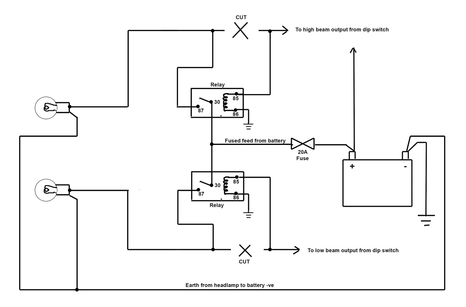

  9. It will depend on the bike as some models have a relay for one of the beams already, or a relay before the dip switch which not so good as the current still has to go through the switch plus various connectors. I'll draw up something generic and post it later.
