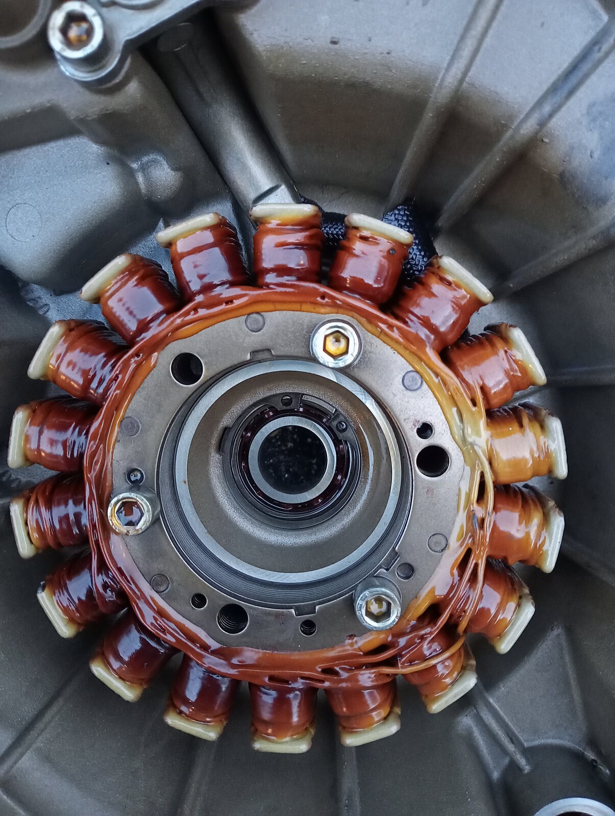

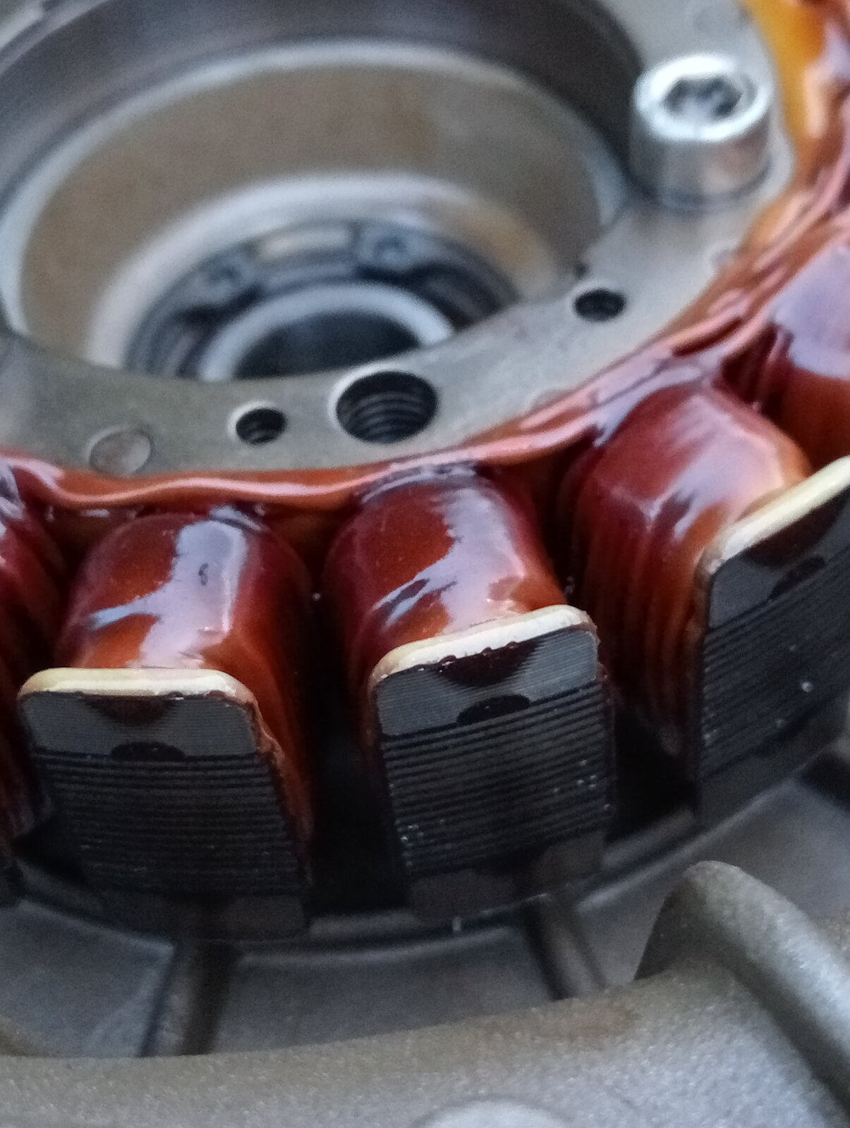

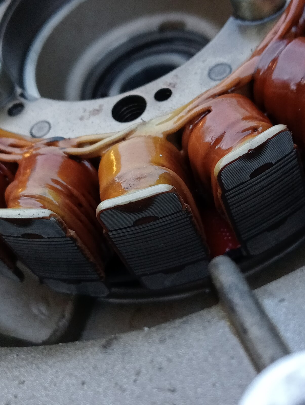

  13. does this stator look ok ,or should i replace it. discol IMG20241130154129[1].jpg IMG20241130154332[1].jpg IMG20241130154349[1].jpg oured on one side
  14. i,m getting 0.6 at all 3 wires with the multimeter set at 200 ohms
  15. That sounds right
