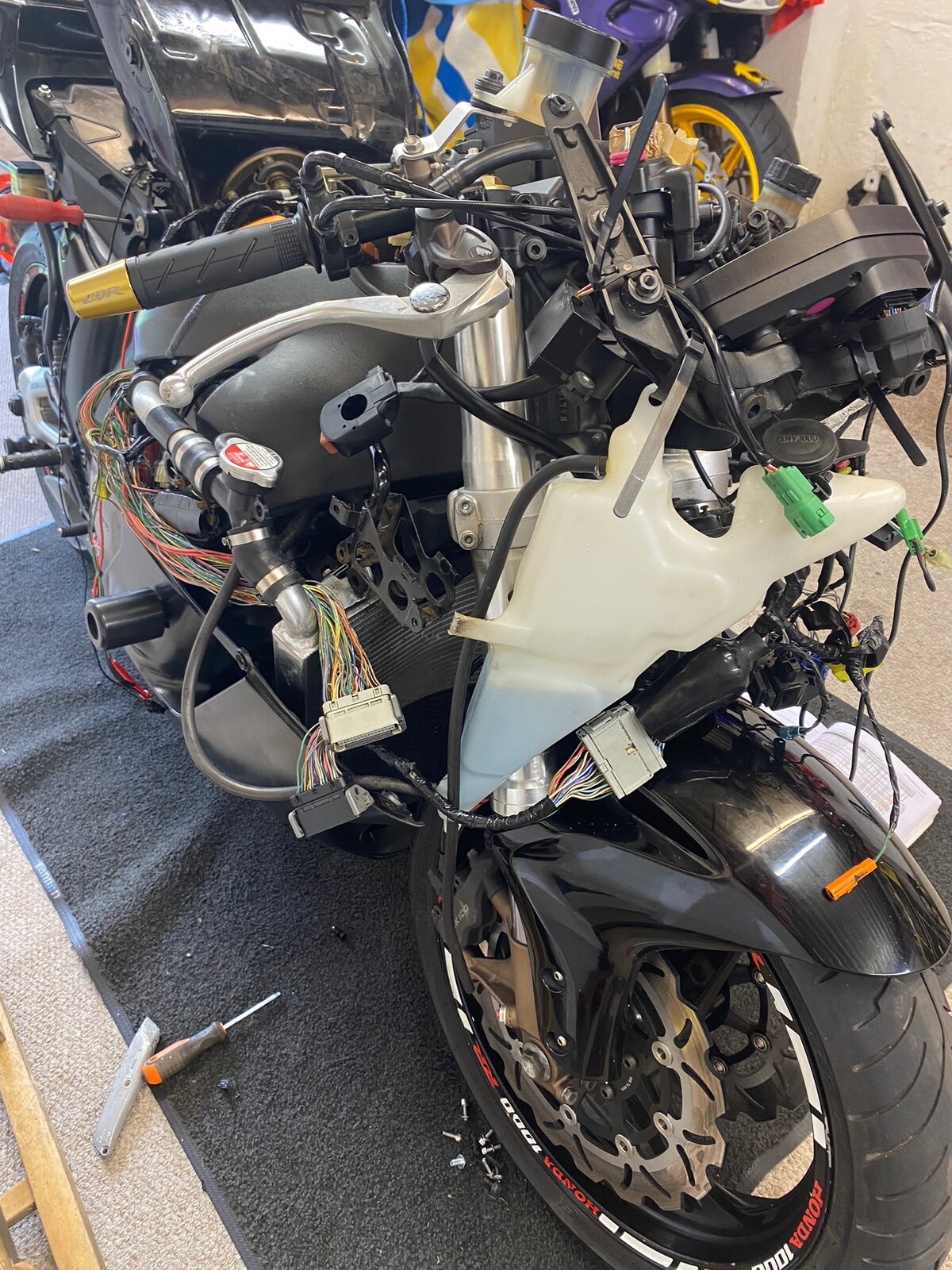

  1. F48B46F3-1737-4C4D-B1FD-906222176950.jpeg Firstly I’m not familiar with Ducati’s. Just my thoughts and I could be well off.
    Did you find your melted stator connections whilst you were investigating your neutral/ no prime issue?
    Is it possible that they are unrelated ? Does the bike turn over with the side stand up and clutch in, and only not start because the fuel pump isn’t priming ?
    Been in a similar situation myself as you can see !
  2. its possible that i do have two faults. when i was in the layby the bike would start but then cut out when put into gear. then with some of the wires bare i put the side fairing on and the bike would not turn over. i have the bike in bits at the moment and going to do some work on it this week. i will post again once everything has been installed.
  3. I think you do have 2, or more, unrelated issues.
    The burnt wiring at the stator r/r connector looks like it had been cooking for some time.
    The fact the bike started but cut out when put into gear is indicative of a faulty side stand switch or a faulty clutch switch.
    Error code 38 is a canbus error

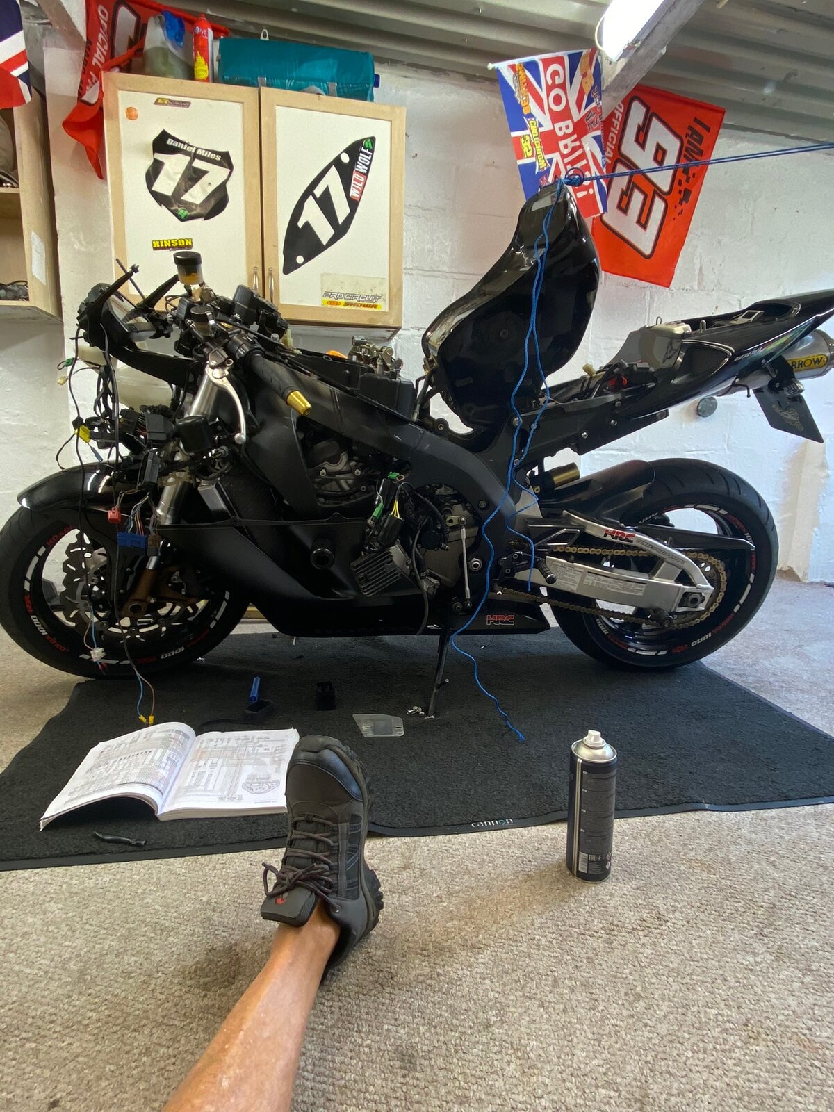

  8. 073F138A-81E6-4B7B-96DF-CFD7EFBD9464.jpeg I feel your pain mate, been there.
    When you found your blown fuse did you continue to check all the others with a meter ? You might like to try to get some easy start into your air intakes to see if she will run for a moment. I’m not suggesting this will resolve your issue but it would raise your spirits and narrow down the possible reason for your issue.
    I followed my workshop manual testing everything multiple times before finding a factory soldered joint had broken. I just had to keep at it, testing and proving, you’ll get there and proving it can actually run, all be it with a bit of outside assistance will help you keep going.
