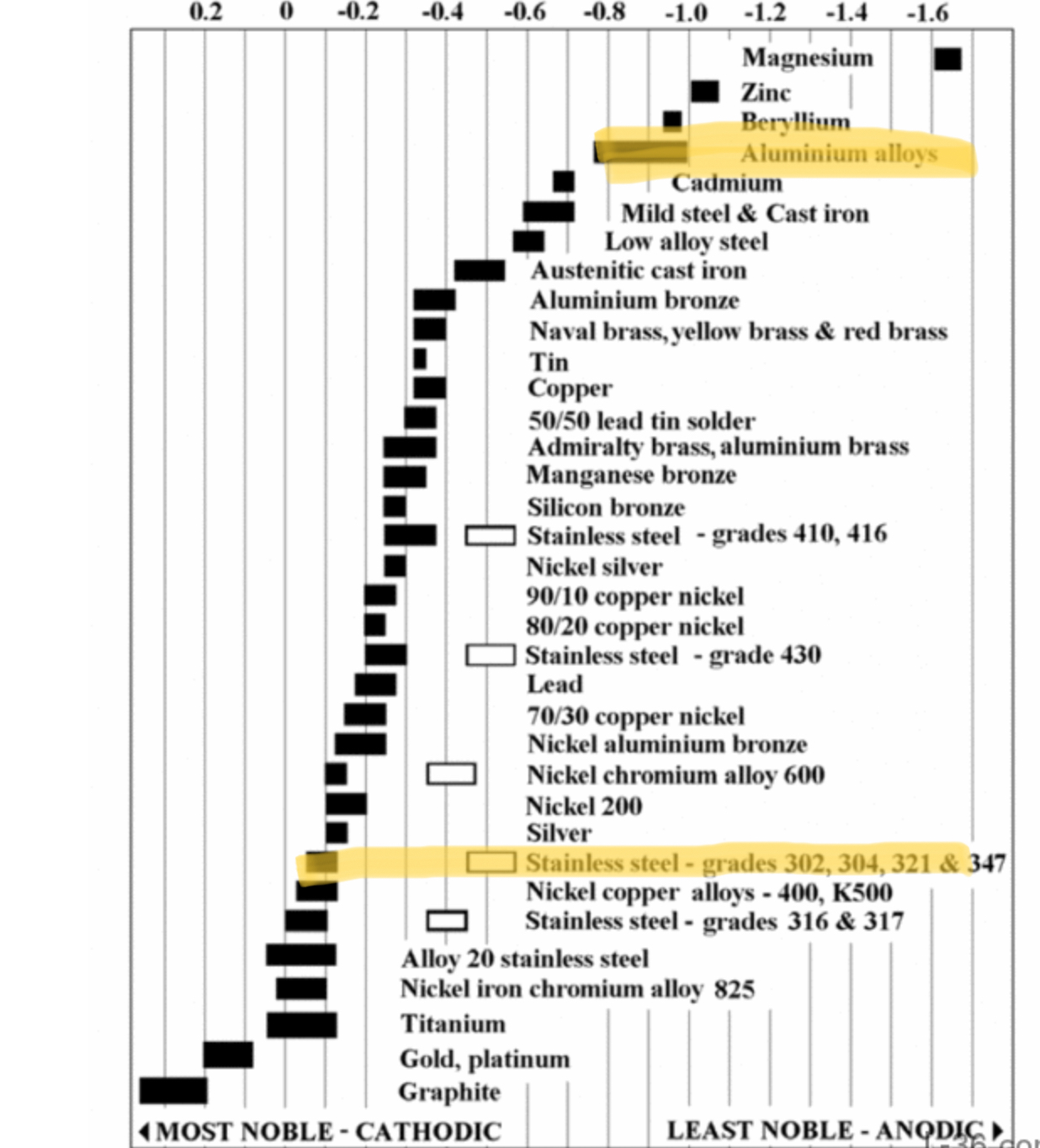

  15. See below.
    The bigger the potential between materials, the worse they will corrode.
    Materials to the right (Al alloy) will turn to powder while the ones on the left (stainless etc) will just get stuck in the nasty corroded products.
    You can see that graphite (carbon) to al alloy is a large difference therefore a guarantee of corrosion of the ally.
    Note that this assumes the presence of an electrolyte (water/salt/shite etc) that will allow the process to occur.
    Keep it clean and dry and you’ll likely never see a problem but for a horizontal cylinder head on a naked bike it’s going to be exposed to all sorts of shit from the road.
    Just saying...
  16. No I appreciate what you are saying
    So the nearer you get to the .8- 1 of Ali the better as far as reaction between the metals is concerned
    So may as well save a few quid and use mild steel just keep it clean and lubricated
