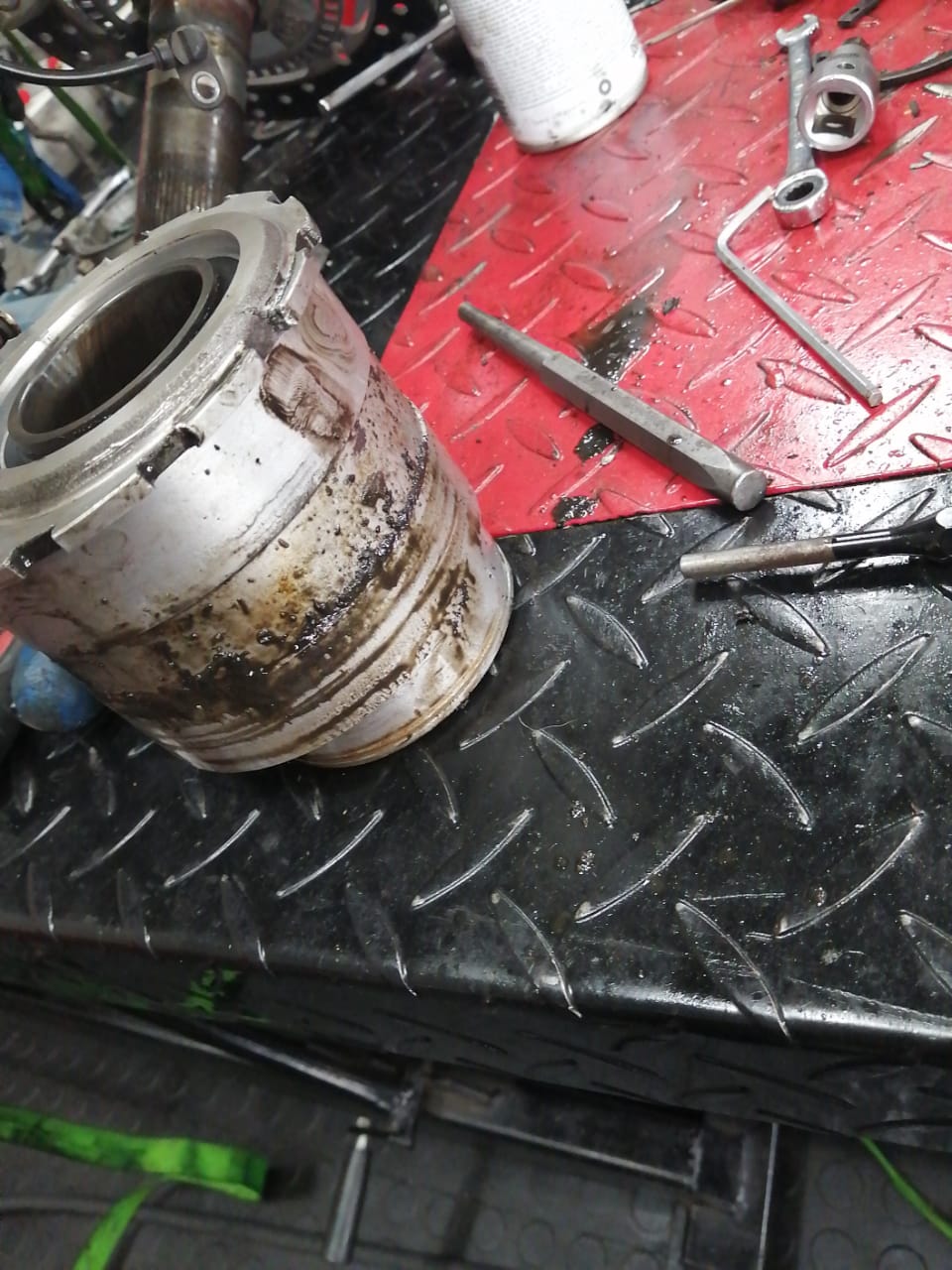

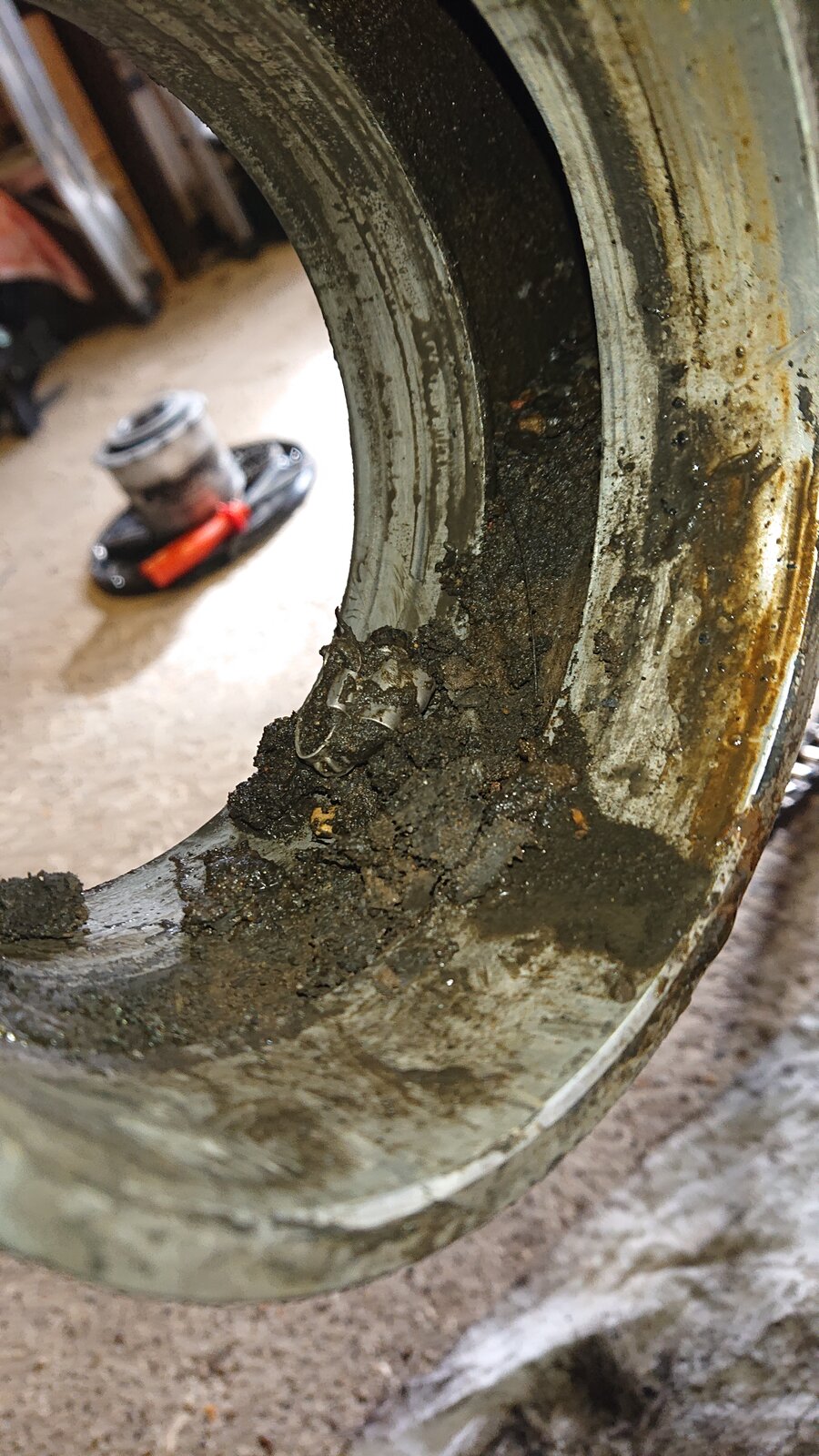

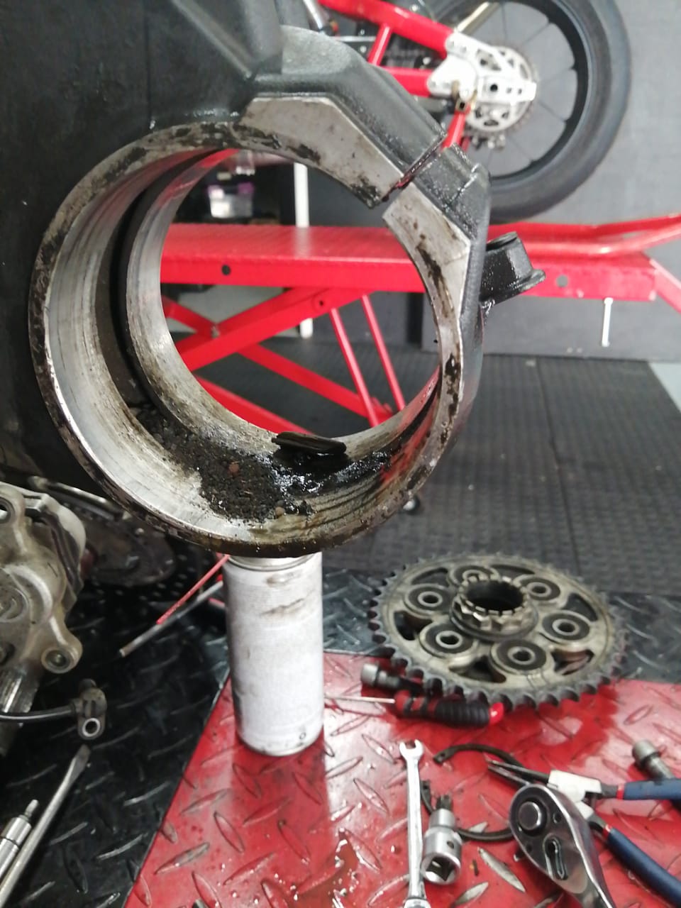

  5. Some feed back on this problem
    See the pics, they best explain what was found
    The amount of crud is amazing. When one considers how dry normal road riding is here in SA. In the UK this must surely be a bigger problem with wet and salted roads IMG-20220104-WA0000.jpg IMG-20220104-WA0000.jpg IMG-20220104-WA0001.jpg IMG-20220104-WA0002.jpg IMG-20220104-WA0003.jpg
  6. It certainty looks a bit of a poor design to accumulate that much crud!

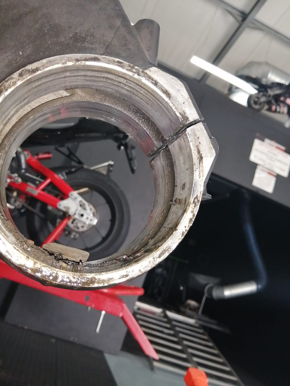

  7. This is what I found in mine... Ducati Multi chain eccentric cleaning (2).JPG Ducati Multi chain eccentric cleaning (2).JPG Ducati Multi chain eccentric cleaning (2).JPG
