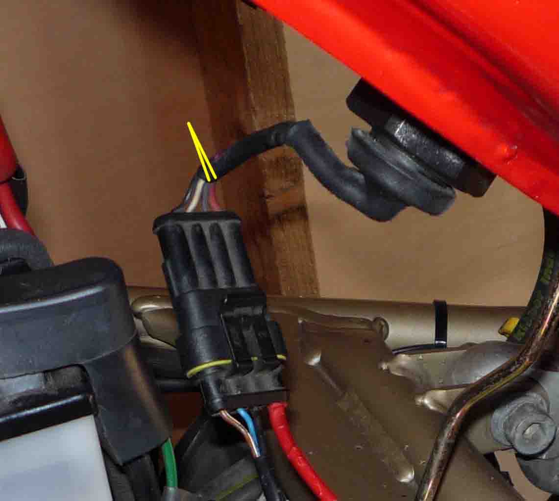

    On closer inspection, with filler cap off I find no blockages in tank tubing, nitrile tubing removed and with a partial refill, I observe the movement of pump that sounds so happy to work with my repair of soldered terminal to broken post. And LO! She is blowing bubbles!
    I've got the wires the wrong way round apparently. And, to tell the truth I discounted that earlier, thinking it would make no difference in positive and negative to such a pump. Did you know that? Can it be true?
    It's drying out and I'll re-do it.

  9. Just switch the wires over in the harness plug and slide a coloured sleeve over each to show that's what you have done.......you get the wires out of the plug with a very thin watchmaker's screwdriver.....push the tag down on the pin....(you can see it inside the hole) and pull the pin out of the back of the plug.

    From Haynes electrical diagram, I see from left to right the main harness female tank plug is ;
    - (1) Red/Blck to engine stop switch (+ve), (2) Blck to earth, (3) Blue to general relay via fuse 4 (also serving turn signal relay), (4) Brwn/White to low fuel warning lamp (+ve) .
    The male plug from tank unit has, to meet from left to right:
    - (1) Red, (2) Blck, (3) White, (4) Blk
    I found both (1) and (2) are in my electrical circuit testing, continuous with the pump terminals. (each continuous with both pump terminals - a closed circuit).
    Does that mean it is safe to swap the two, (1) and (2), and that the blue main harness wire (3) from relay is a +ve feed earthed finally by the warning lamp?
    (hope I am clear, with my question).
    Gracias,
    John
  11. If you are saying you have connected the two pump wires incorrectly in the tank; ie, you have got your wires crossed........
    ............then to save you the trouble of going back into the tank you could try switching over the two shown in the photo.
    You could first test it by separating the plug halves; then shoving a wire into the harness connector holes, crossing them over and then into the other half of the plug.....
    The red wire is definitely the pump +ive feed, because I have an inline switch in mine so I can test electrics without the pump running.
    The far left black in the picture, may have a white trace line as well.
