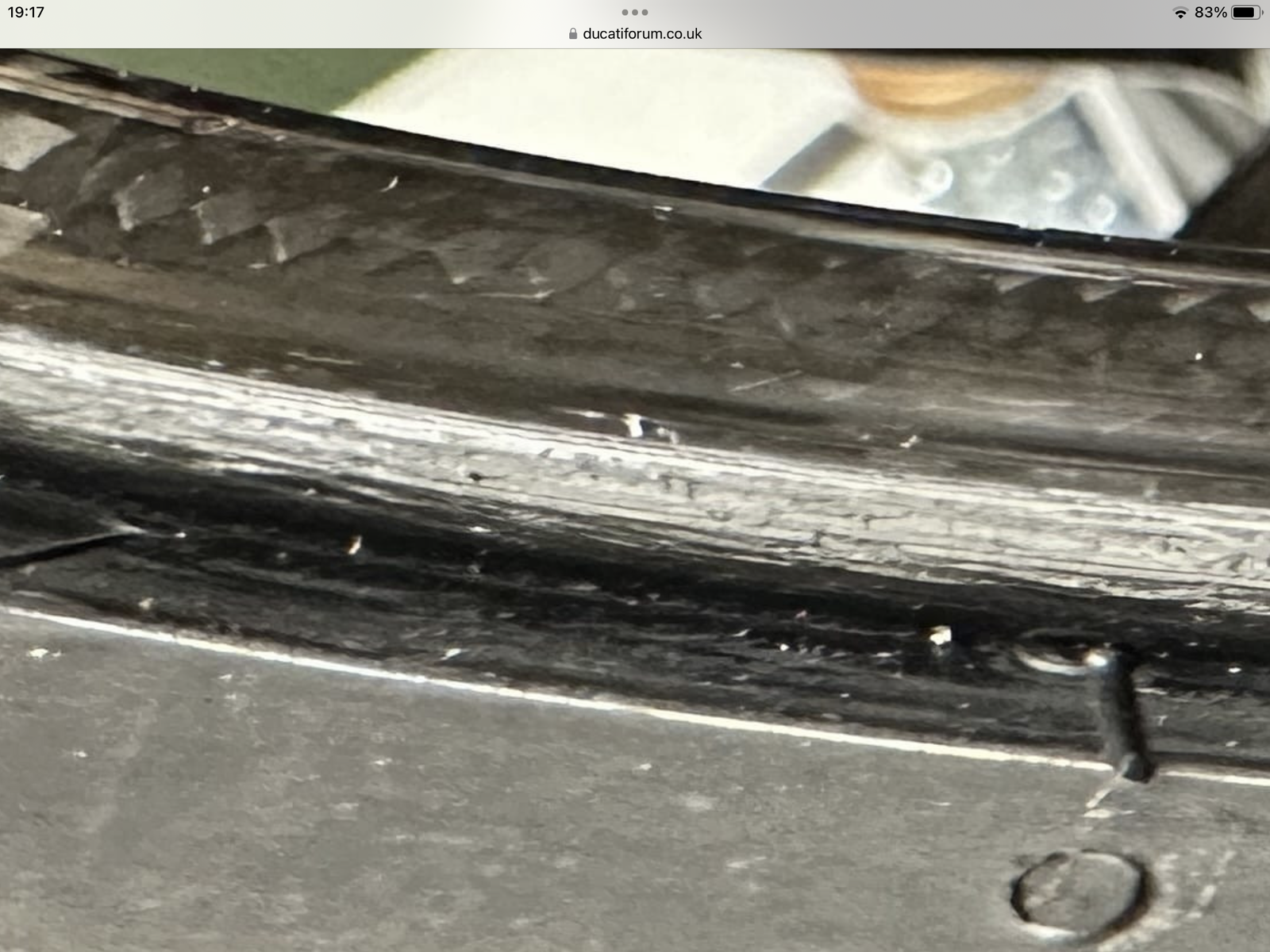

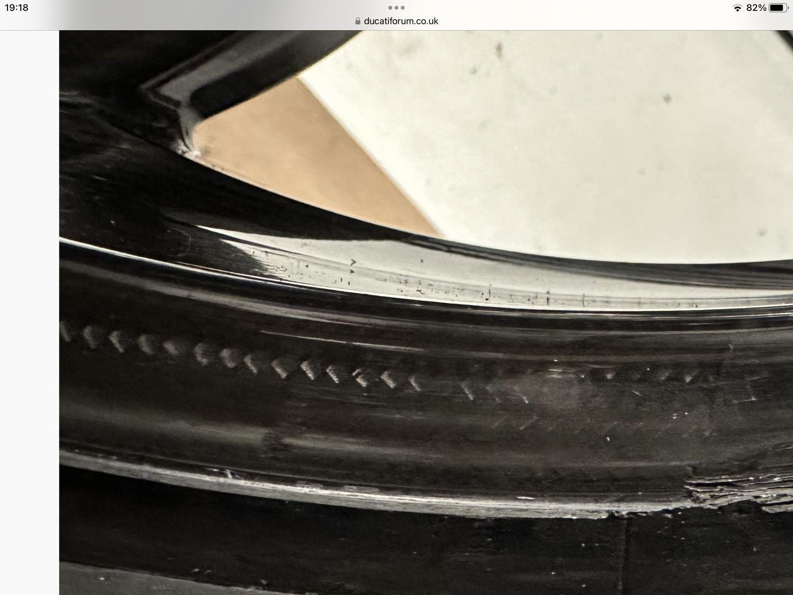

  10. One thing really interested me in the pictures, apart from the massive and obvious failure, and that was the outer edge of the supposedly undamaged part of the rim which appears to be raw and only partially consolidated CF, short on resin, with voids and an unfinished surface.
    0827FFB5-3F18-4FC9-A056-2D1E84F0745A.png 20A43DD2-3C6E-43A7-A586-3EF57384B531.png
    Is that really how new BST wheels are finished? I honestly can’t believe that it is - if it is, I think leaving them out in a slight frost would pull them apart as any moisture there would expand and delaminate the rims, making them entirely unusable on the road.
    If it isn’t how they are new, and these were damaged by a PO (looks like they did a quick lap to see how they felt before fitting tyres :worried:) or possibly they were scuffed up to intentionally mask previous damage, then that person is playing fast and loose with the life expectancy of all subsequent owners…. Not good.
    Maybe a third option if BST are as good a quality as their price and reputation implies, is that these are fakes. I guess it isn’t too far fetched- if counterfeiters can make knock-off very high end road bike frames that need close inspection to spot, wheels would not be that difficult. It doesn’t excuse them continuing to be sold as usable, but might better explain the failure and what the picture shows.
  11. BST's are not finished like that. The finish on the one's I had were, in my opinion, as near perfection as they could be, and no areas were thin on resin or lacquer. Mine were 6 or 7 years old when I sold them and still perfect.
  12. Counterfeiters can fake an iPhone so one would imagine carbon wheels would be a cinch.
  13. Carbon is all pre preg. Has been for many years. The cloth has the right amount of resin already in it and is activated by vacuum and heat in the autoclave. You can't ever not have enough resin. The carbon which looks perfectly lacquered is exactly that. Lacquered! The perfect finish adds nothing to the structural strength and is purely cosmetic. The problem with carbon rims is that they are incredibly stiff. Carbon allows for some elastic deformation but no plastic deformation. As a result, they break rather than dent or buckle.

  16. That looks more like the wheel was rotating as it hit something causing a scuff than lack of resin to me
  17. @J0n3s those wheels have had one heck of an impact!
    No way could you not have noticed that, particularly riding the bike when it happened, you would have crapped yourself at the impact!
    This video below shows BMW testing the TK wheels on the S1000rr , jumping a kerb and the rim is still intact-
    https://youtu.be/Gwb7ZDfwWqA?si=JGo4HFUnEFCBxlKg
    Regarding
    the finish on BST wheels, I bought a set in June 2021 for my 899 and they have been superb, I check them every ride as I wash the bike and apart from a few tiny stone chips they are still perfect..
    I should add that both my pushbikes have CF wheels and the cross section of these are tiny compared to the motorbike ones, the MTB in particular has taken years of abuse hitting/jumping rocks etc and the only trouble I’ve had is a couple of broken spokes in the back wheel .
    The main trouble with your wheels is that you don’t know where they came from ( genuine BSTs or not ? ) and you don’t know what abuse they have suffered in the past.
