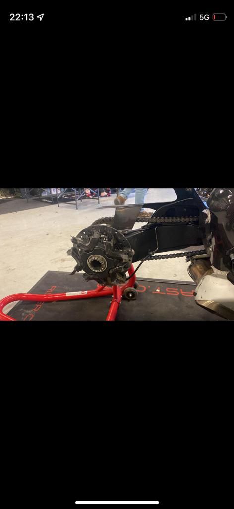

  1. I’ve run a set of CF BST’s on my track bike for years. No problem at all so far and obviously umpteen tyre changes.
    But I do accept that carbon fibre isn’t the most reliable material when used in stress related applications. The weave, lacquer and curing process will always lack consistency whereas dealing with a metal/alloy will give time after time characteristics. Remember that submersible attempting a visit to the Titanic last year?
    And I’m afraid to say OP, that wheel’s fucked. Do not use. But I think you know that. Not the end of the world and good that you spotted it… o_O

  3. Ultrasonic phased array (C Scan) NDT will detect internal discontinuities.
  4. What did the manufacturer say about the rim's catastrophic failure?
    The autopsy results would have been interesting.......
