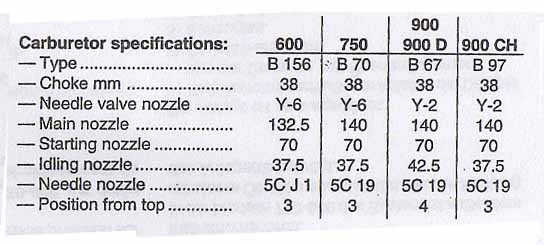

  11. This might help...........you can ignore the 900s.
    Also, if you look in the inlet throat you will see an air jet which may need changing over and there is also one where the diaphragm is.
    You may also need to change over the air cut-off valve diaphragms.
    The main thing about these carbs is getting the float / fuel height correct...........There is no specific dimension, but 14mm is apparently a starting point.........mine are at approx 13mm.....the smaller the figure, the richer the idle mixture.
    With the carbs off, take the float bowls off and with the carbs upside down, turn the float bowls around and re-rix with two crews so they hold the flaot assemblies in place.
    Tip the carbs slightly sideways so the needle is just shut (you don't want the floats compressing the spring in the needles) and measure the distance between the carb 'gasket' face and the rectangular float corner).
