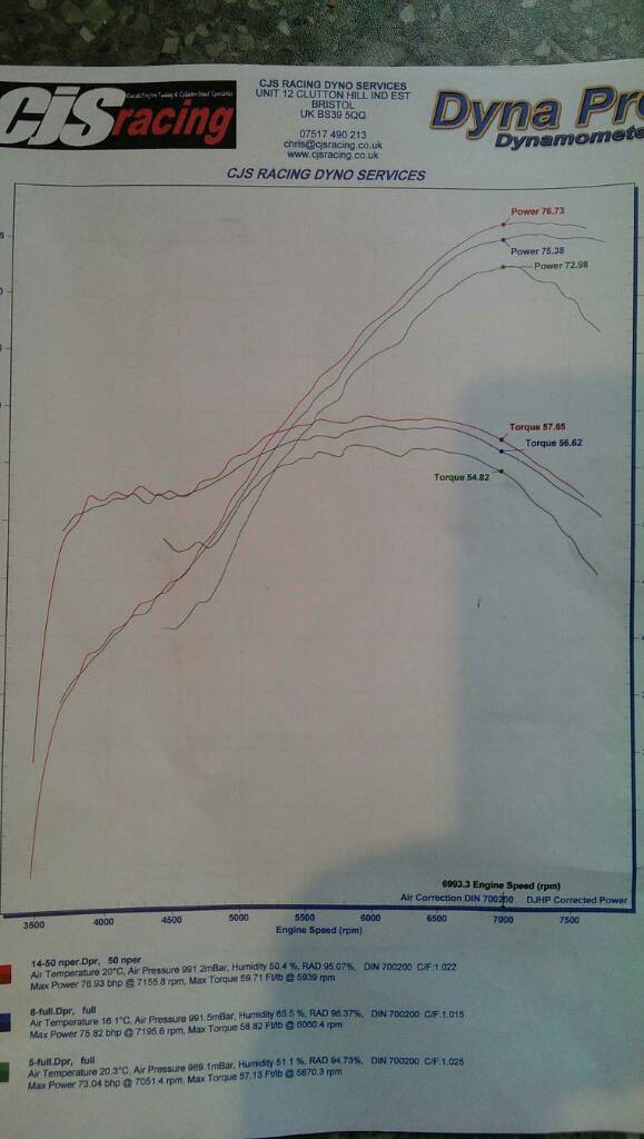

  11. Ok, final update. We started off with the 165 jets which were the smallest jets from a Monster kit. Way too big. 14% over fuelled.
    So we dropped the jets down to 140 which is the smallest set from the 900SS kit, set the eclip at position 4 and got good results. The bike is crisp and snappy and sounds great. That's running open air box, cored stock cans, blueprinted stock engine.
    Here's a chart with some lines and numbers for the geeks.
  12. Thanks Gilps - so green = 165 jets, red = 140 jets position 4 on needle, what was blue out of interest?
  13. That was the 140 jets but the needle on position 3, which is the recommended position with the 165 jets on the monster setup. Ive done a bit of digging and can find no evidence that the Monster engine is any different than the SS. I can only assume that the Monster exhaust system makes a difference, but I really cant see it needing that much fuel. I found with my 600SS DD bike that the smallest jets supplied were actually the best option when put on a dyno. I wonder how many people just stick the biggest jets in believing that it will give more power. The best way to get set up is certainly to grt the thing on a dyno.

  16. All sizes are for dj jets. I reckon 150 is too big for a stock motor with race cans. As you can see, with 140 fitted we gained an extra hp and ft/lb by dropping a needle position, even though the needle isnt supposed to affect top end. I reckon a dyno set up is the only way anyone will ever know what its truly doing. Anything else is just guesswork and gut feel. Sometimes people can misinterpret a change as an improvement when its really not, they just notice that its different and assume thats a good thing.
    I suspect we could have got away with 144s and position 3 as there was a slight lean spot on half throttle at 6500, but I dont ride half throttle at 6500 so we chose to live with it. Ill get it out over the weekend if I can get it motd. the real test will be how it actually drives on the road.
