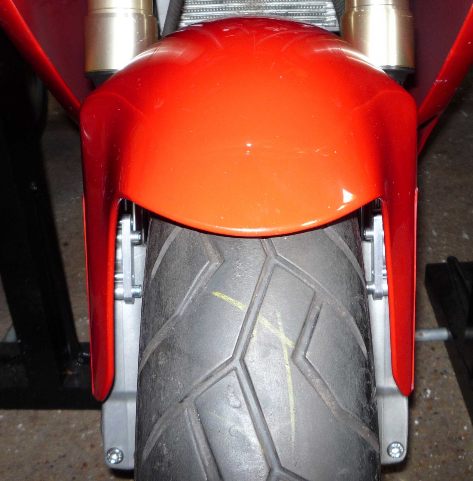

    Also, over time, the OEM front mudguard can sag which causes the rear of it to drag / catch on the tire (obvious from the scuffs and wear on the inside when it is taken off).....I developed a cure for this which works fine if you are careful. If instructions and pics are needed, let me know.
    AL[/QUOTE]
    Wouldn't mind hearing the cure AL, mines exactly like that and the rear of it was like thin paper !!
  7. Enlarge the 4 mount holes and raise it a mm or two. Its what I did to fit the 120/70 front
  8. Wouldn't mind hearing the cure AL, mines exactly like that and the rear of it was like thin paper !![/QUOTE]
    Sent by email..........but you can always do this...............

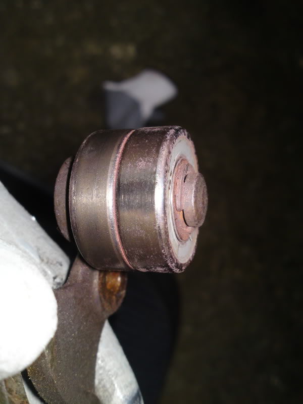

  19. I have a ducati 900ss 1999... I dont see how the front brake switch modification with the banjo bolt can work?? Are there any pattern ones available as paying £30 is a joke!
  20. Mine looks like this....https://www.ebay.co.uk/itm/NEW-GENU...018131&hash=item3fa9496991:g:SvkAAOSwK3ZbfsU-
