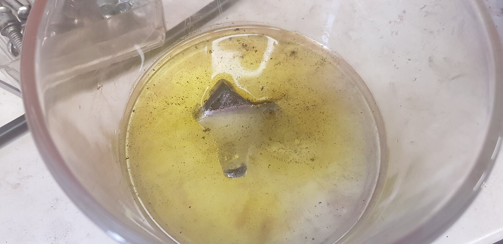

  1. For rust??

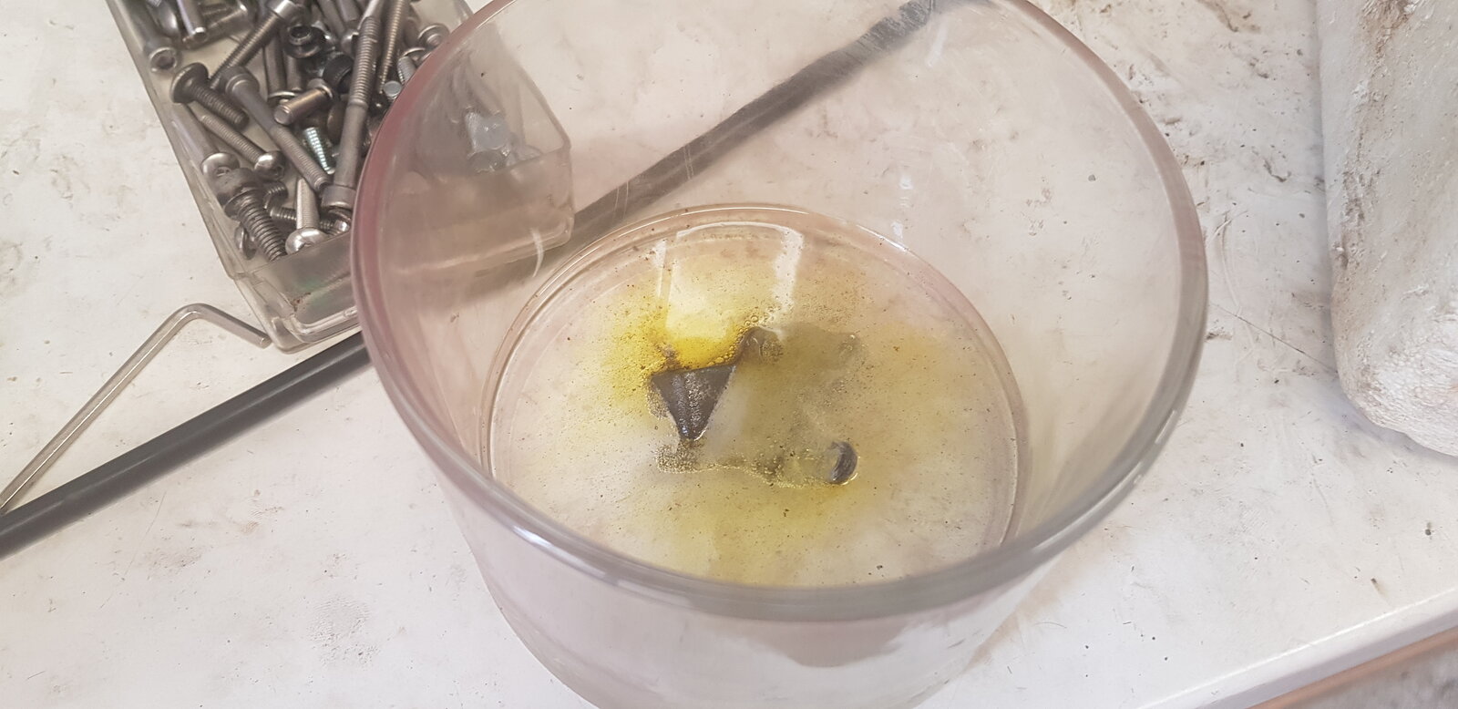

  2. Missed a bit... Quite a good demo of the acid doing its job...
    20190323_140244.jpg 20190323_141012.jpg 20190323_140103.jpg 20190323_140219.jpg

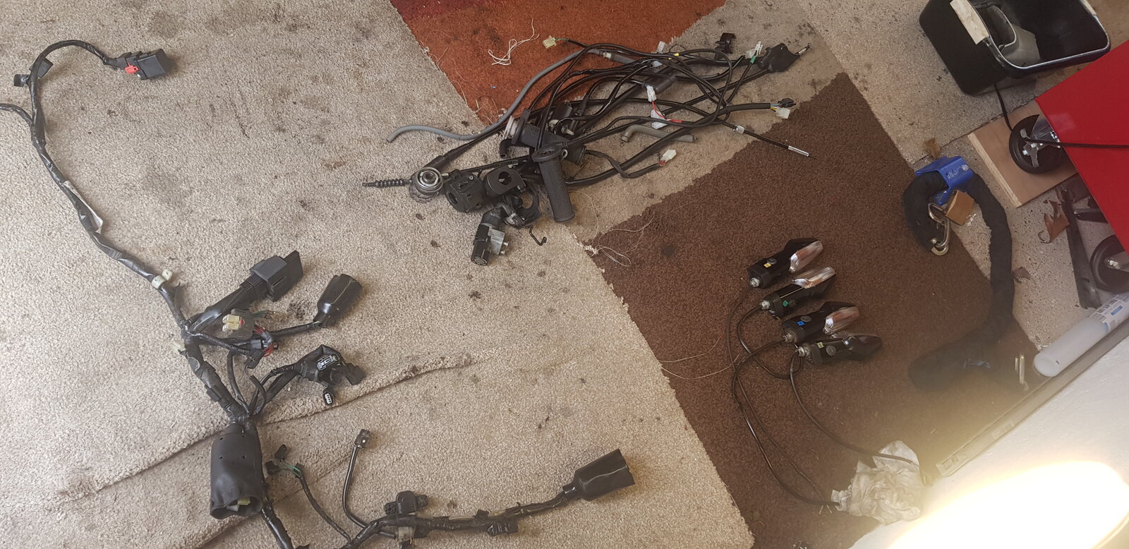

  3. All the cabling cleaned up.
  4. Yeah, take the nuts & bolts, put them in a jar & cover them with cider vinegar. I put the lid the jar on so as to avoid spillages and evaporation. A day or so later all the rust is gone. Cheap & safe!

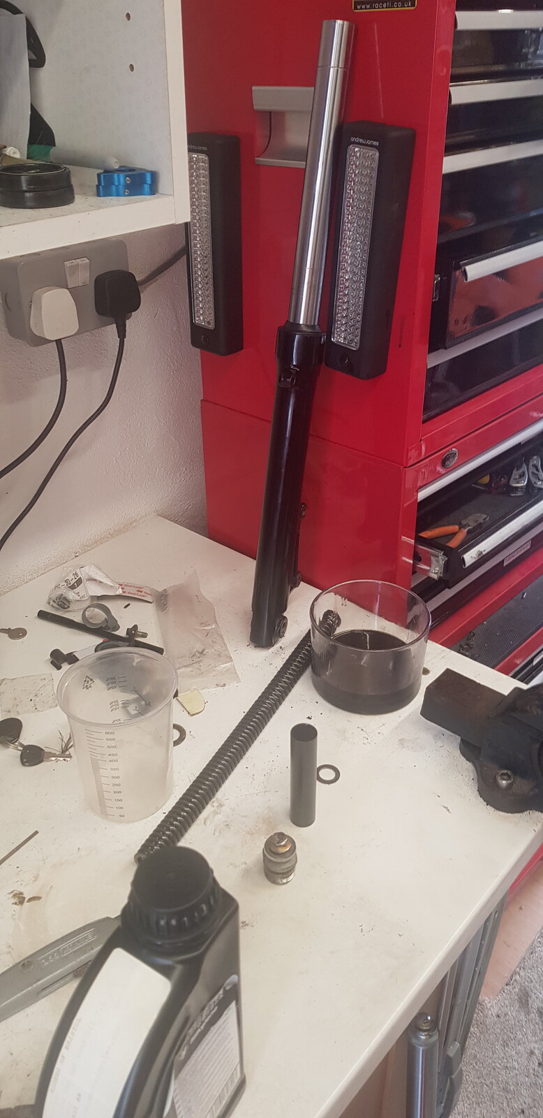

  5. Fork oil change... As suspected I think this is the oil that went in at the factory..

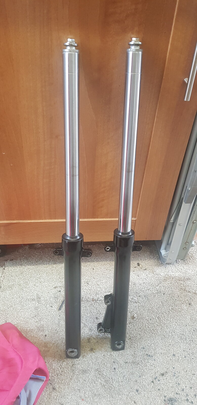

  6. Forks built back up.... Few other shitty bits cleaned too...
    20190323_144653.jpg 20190323_150328.jpg 20190323_150244.jpg 20190323_151036.jpg 20190323_151047.jpg

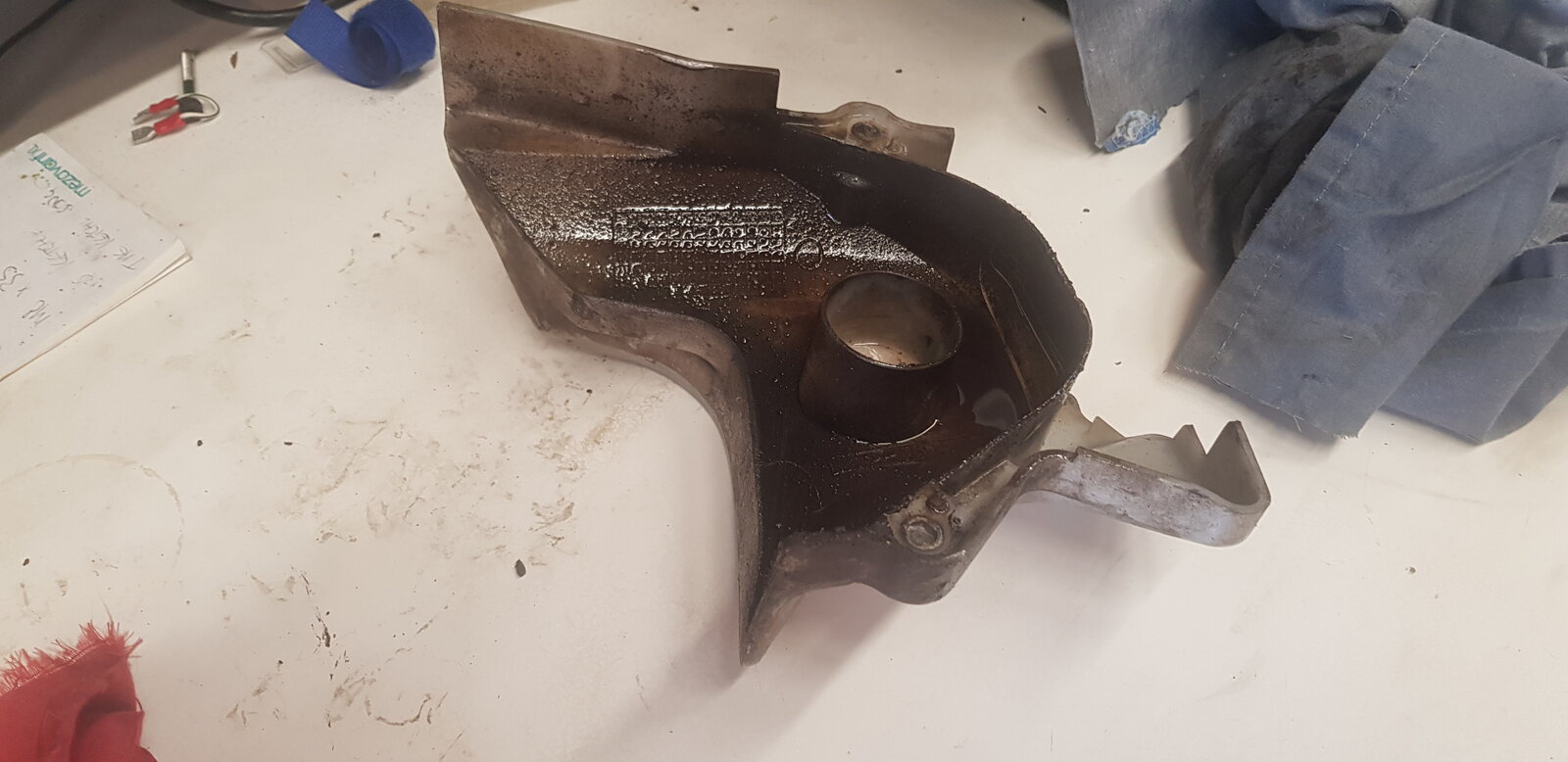

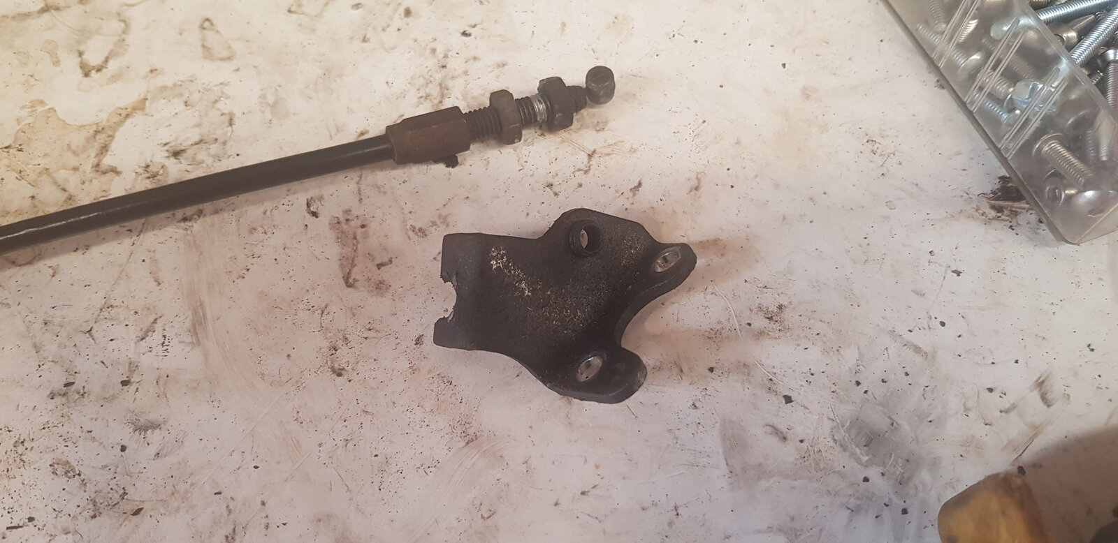

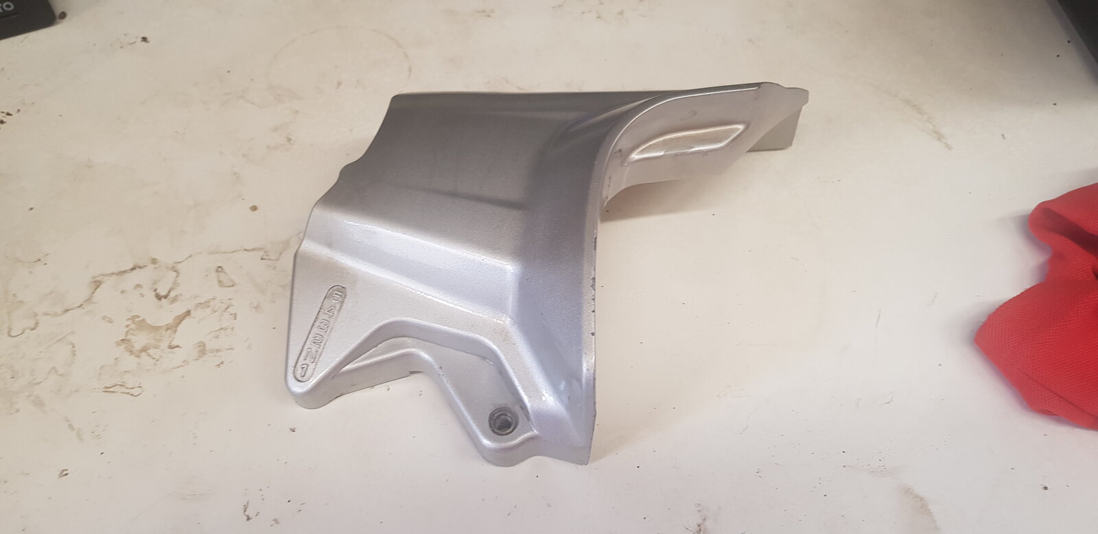

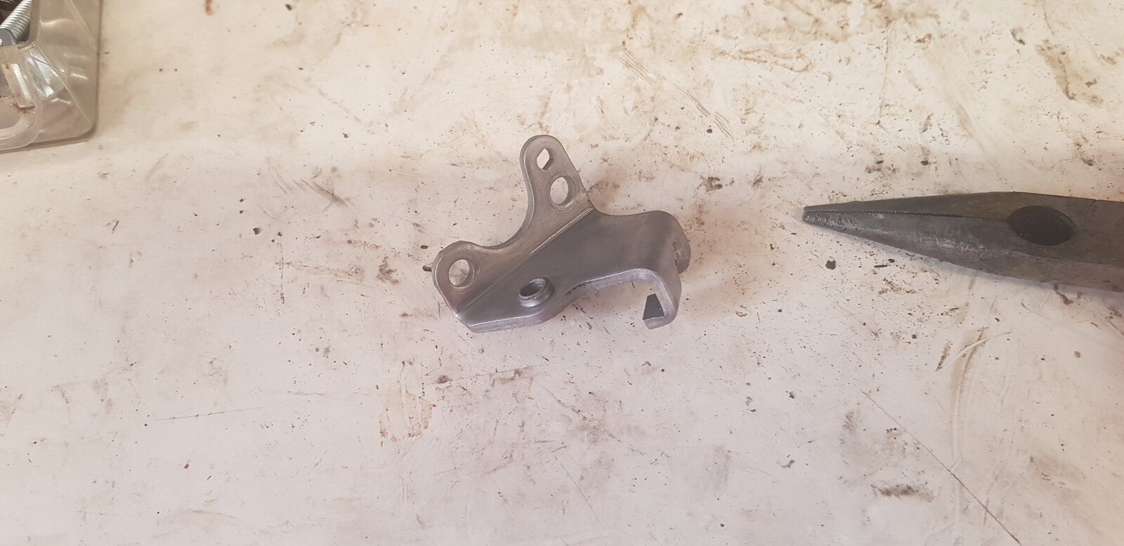

  7. All the coating will be ready next Friday.. So, hopefully building will start Saturday.. This week coming will spent concentrating on the engine...

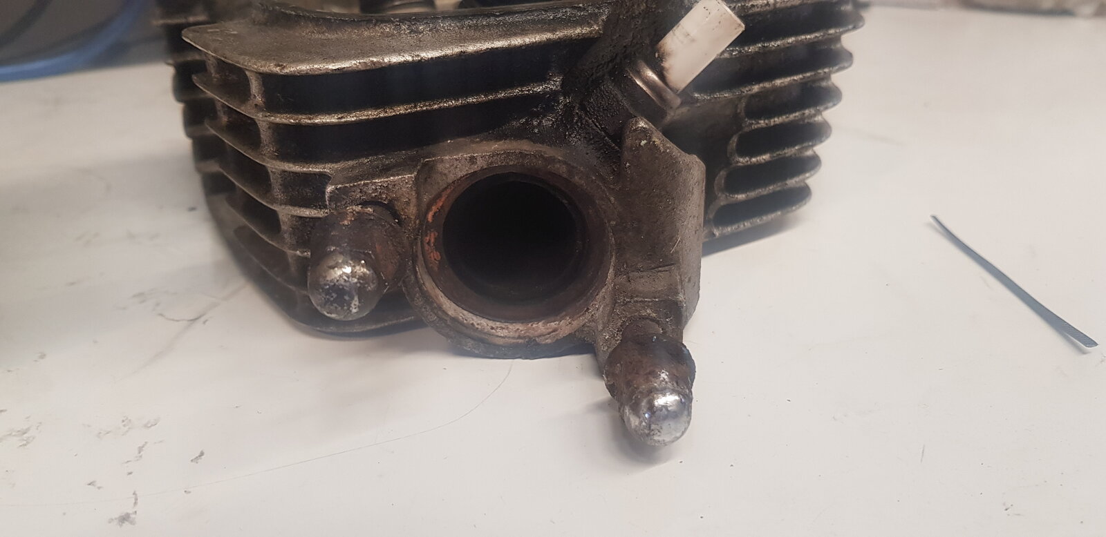

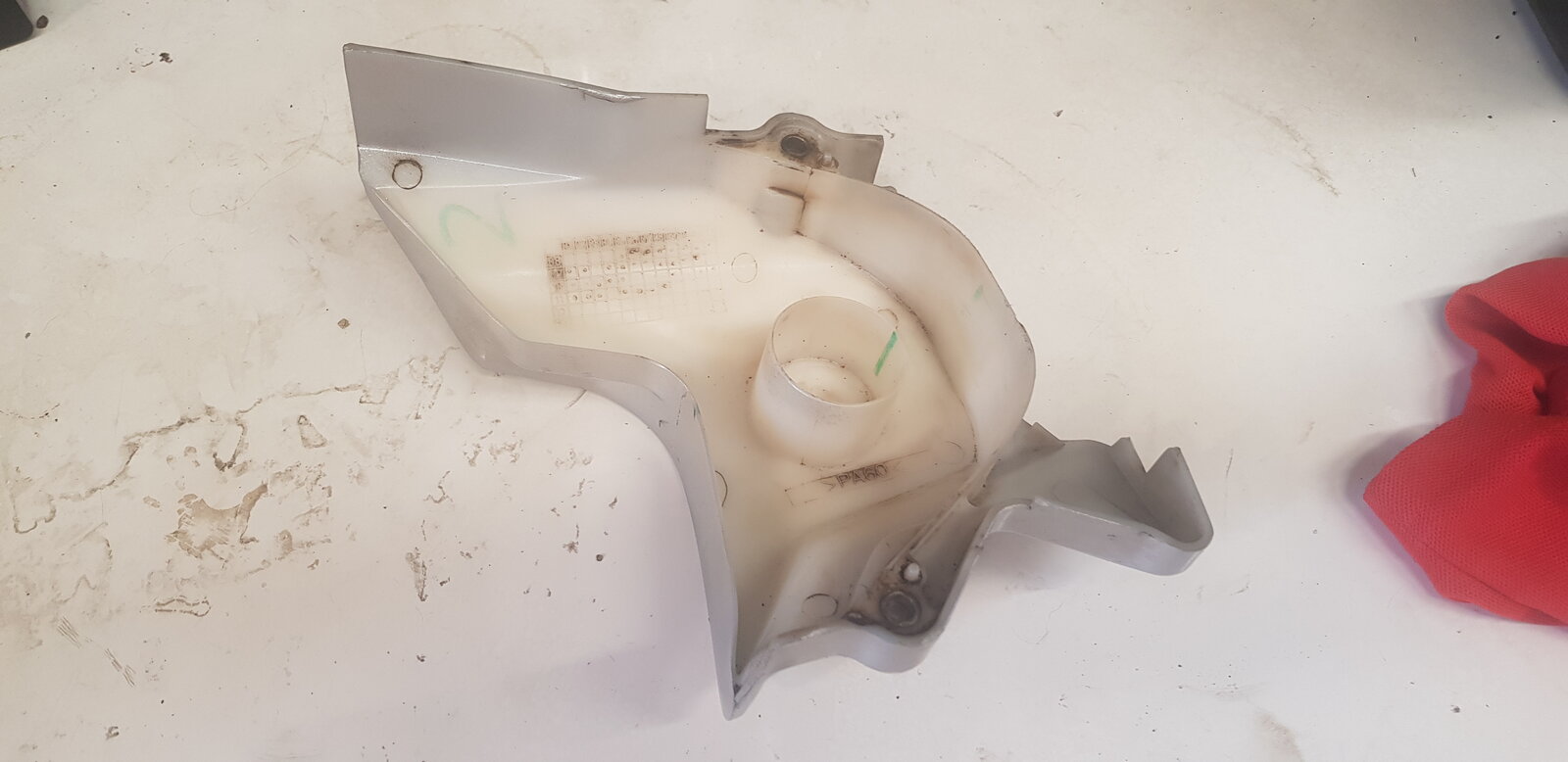

  8. Just been to pick up the top end for polishing the ports and then drop off to the powder coaters....unless he changes his mind the engine will go from silver to black.. Easier to keep clean...
  9. Looking at the pics... Yeah... It doesn't look like but it is silver...

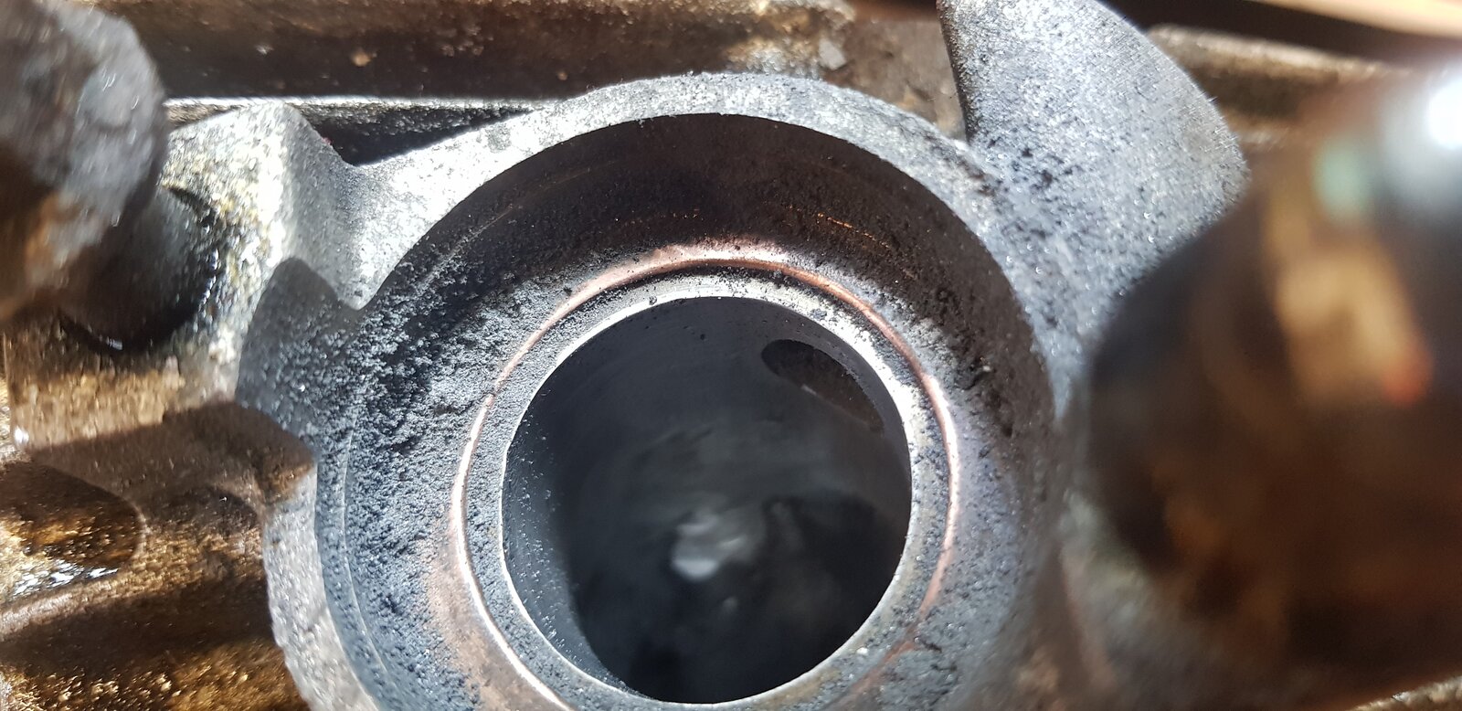

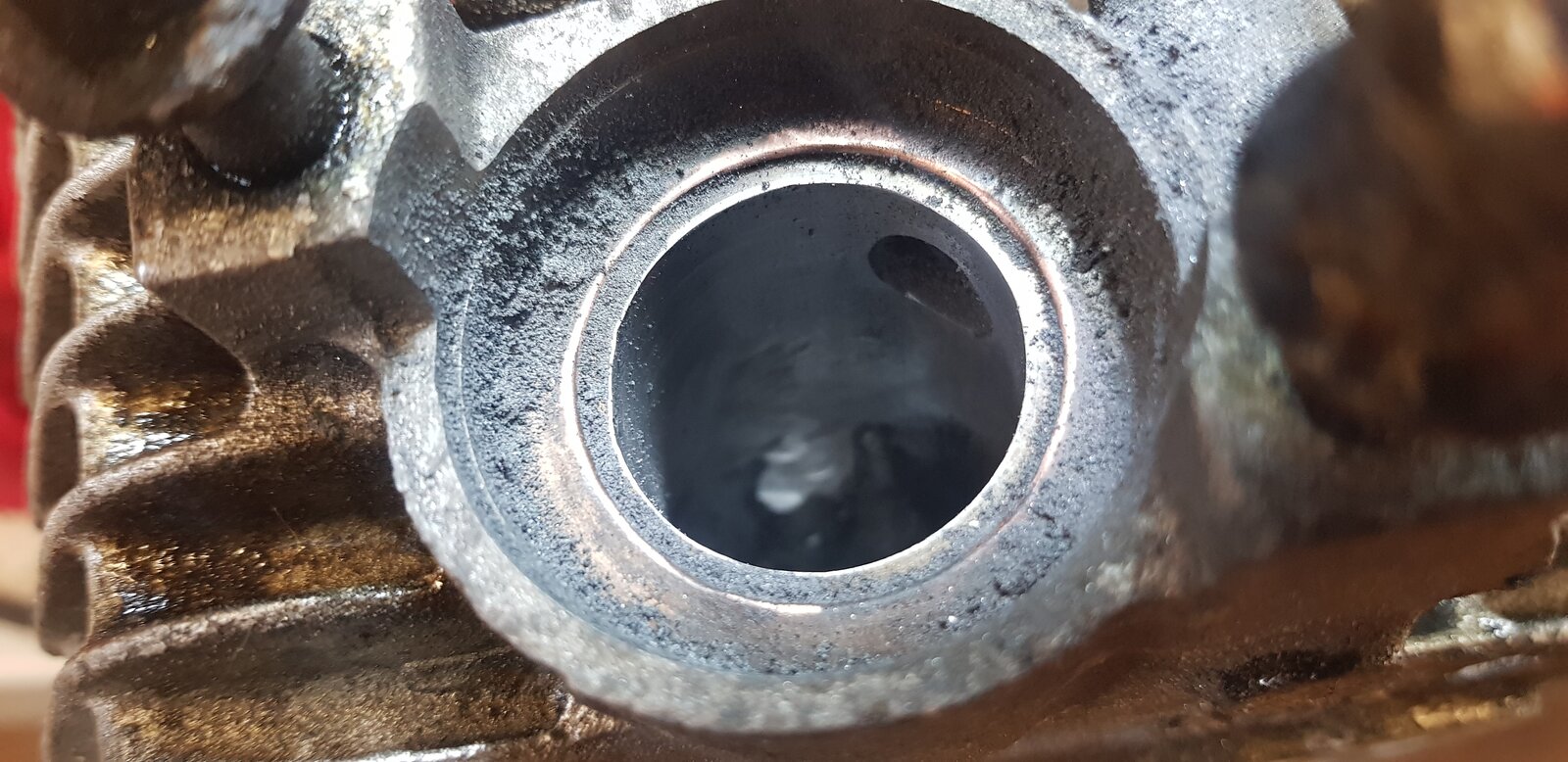

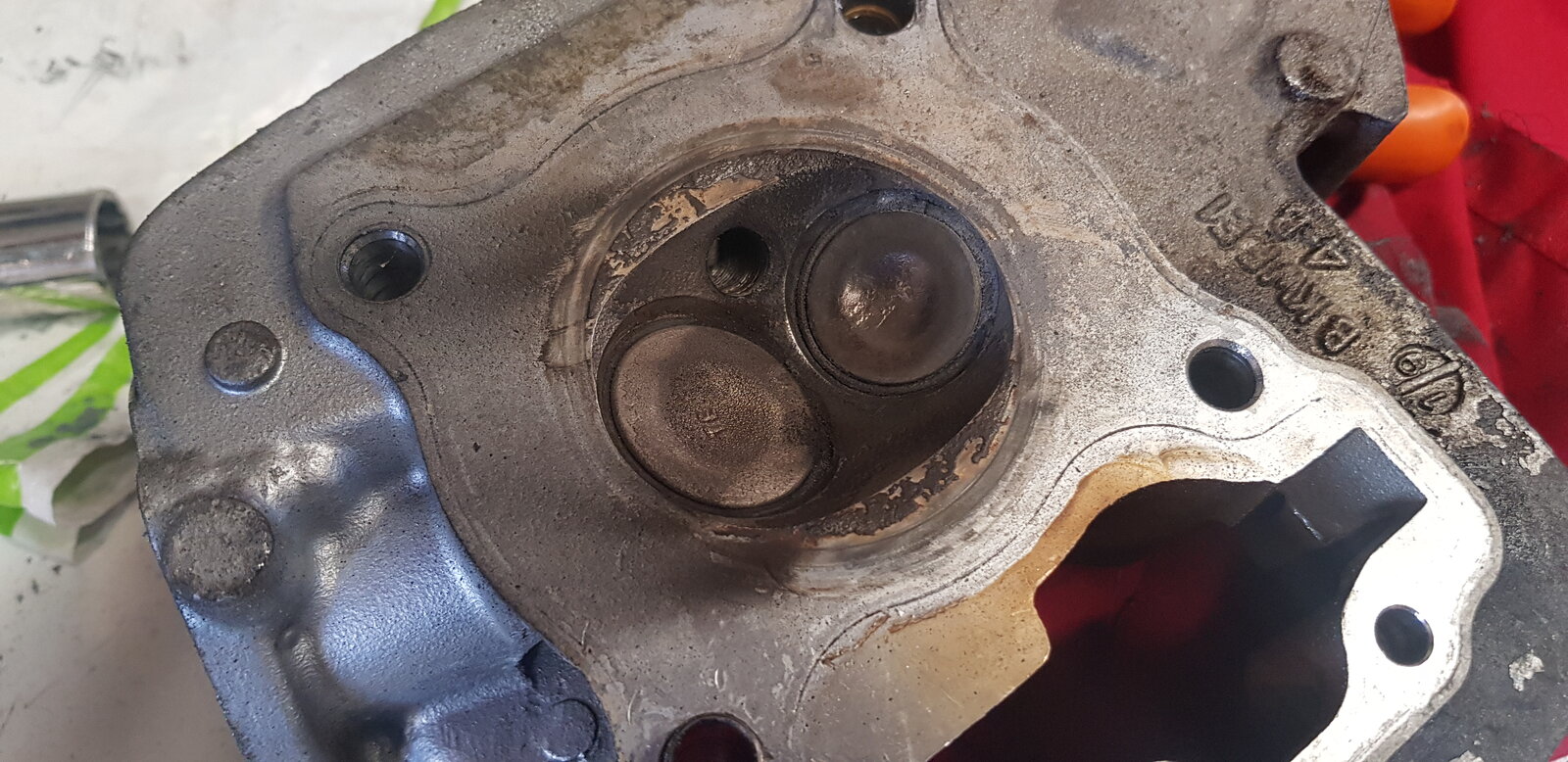

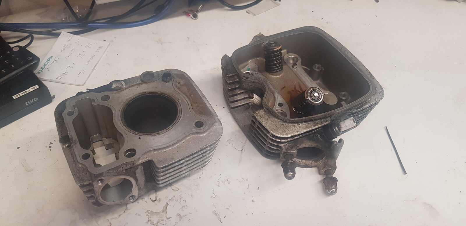

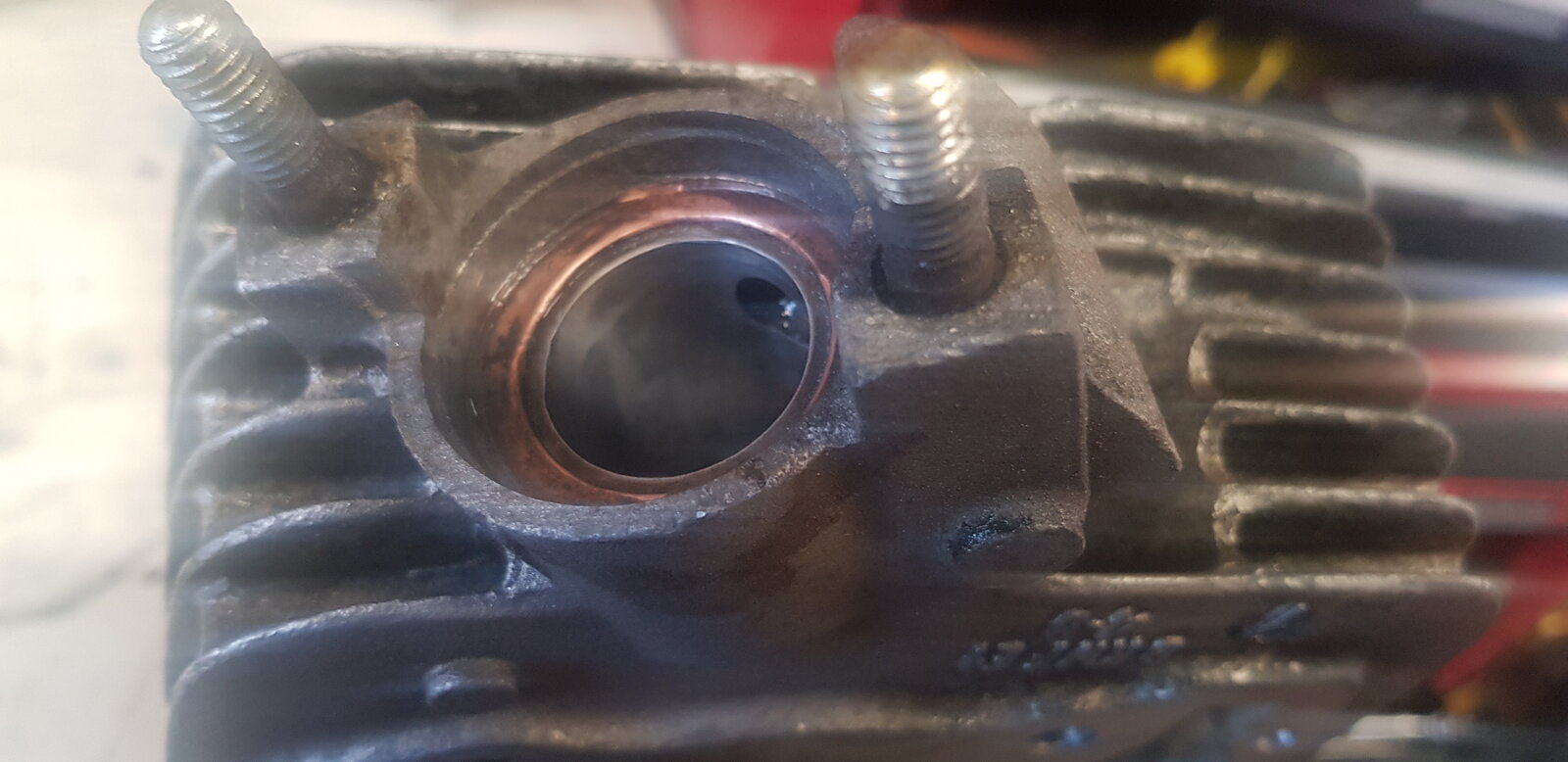

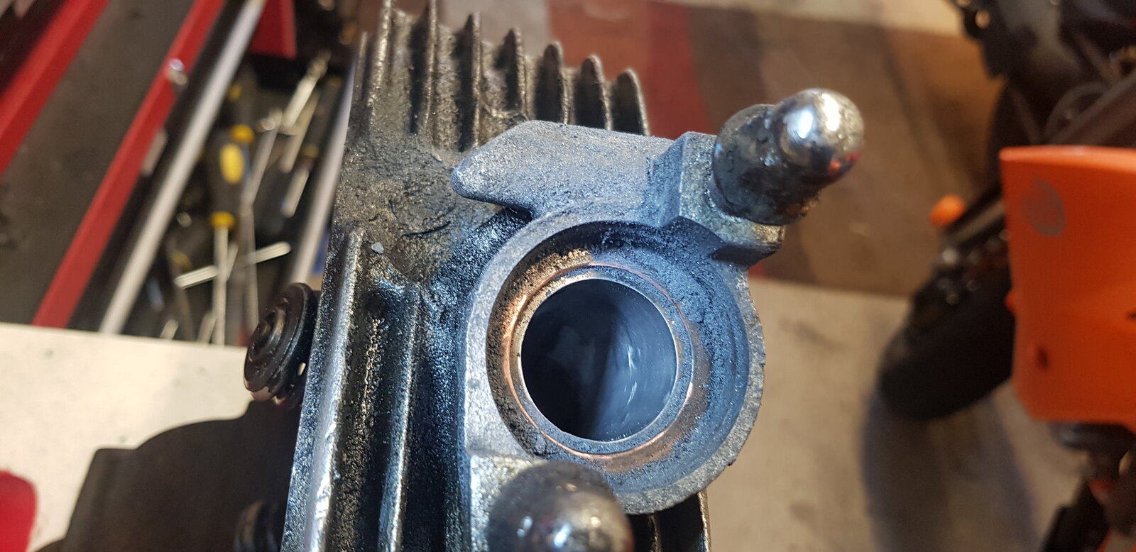

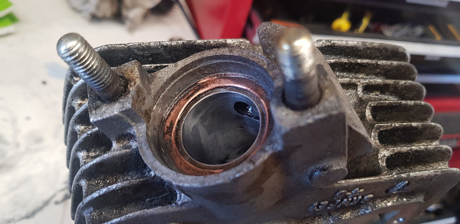

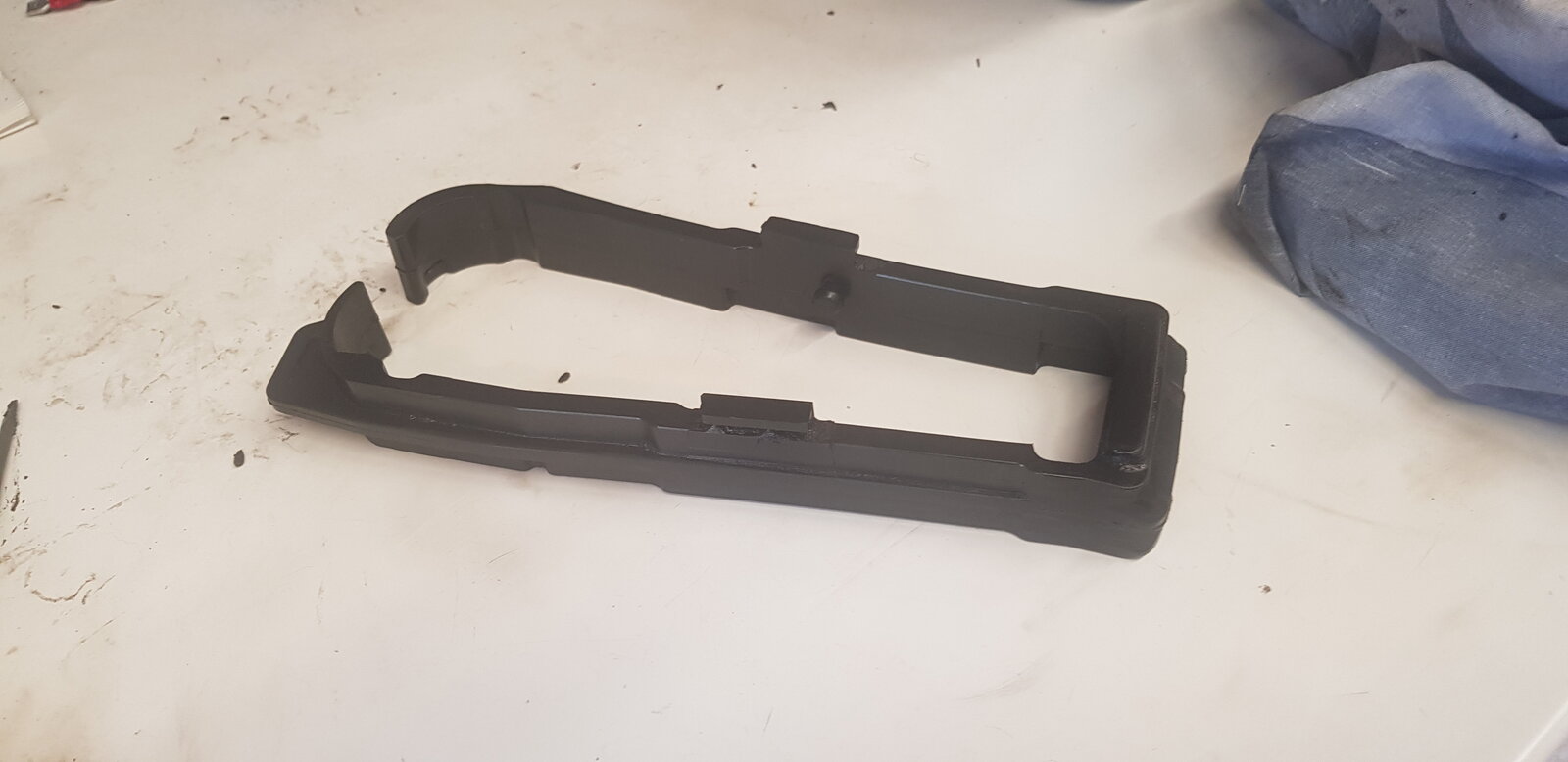

  10. Started work on the head.... Ran out of rubber wheels ... But doesn't matter... If it gets coated I can still finish after...
    20190324_135646.jpg 20190324_135648.jpg 20190324_135636.jpg 20190324_141645.jpg 20190324_140128.jpg 20190324_141636.jpg

  13. Cheers ET - i must confess i thought everyone might be a bit ...meh over it as its only a 125 and a commuter at that... were still in the downhill slope at the moment, but come friday it should start to turn around.
    Engine builder mate said that the bottom end is proving to be a bit of a pain as they (Fowlers) are trying to locate some internal engine parts...bit unusual but, theyre yer go....just about to order some more rubber wheels....its ok as it is but i think i can get a better finish in there...ive only got the one chance while its apart so i may as well...
