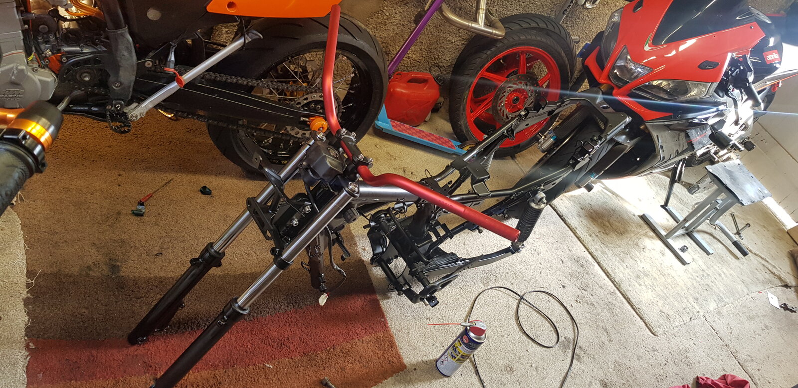

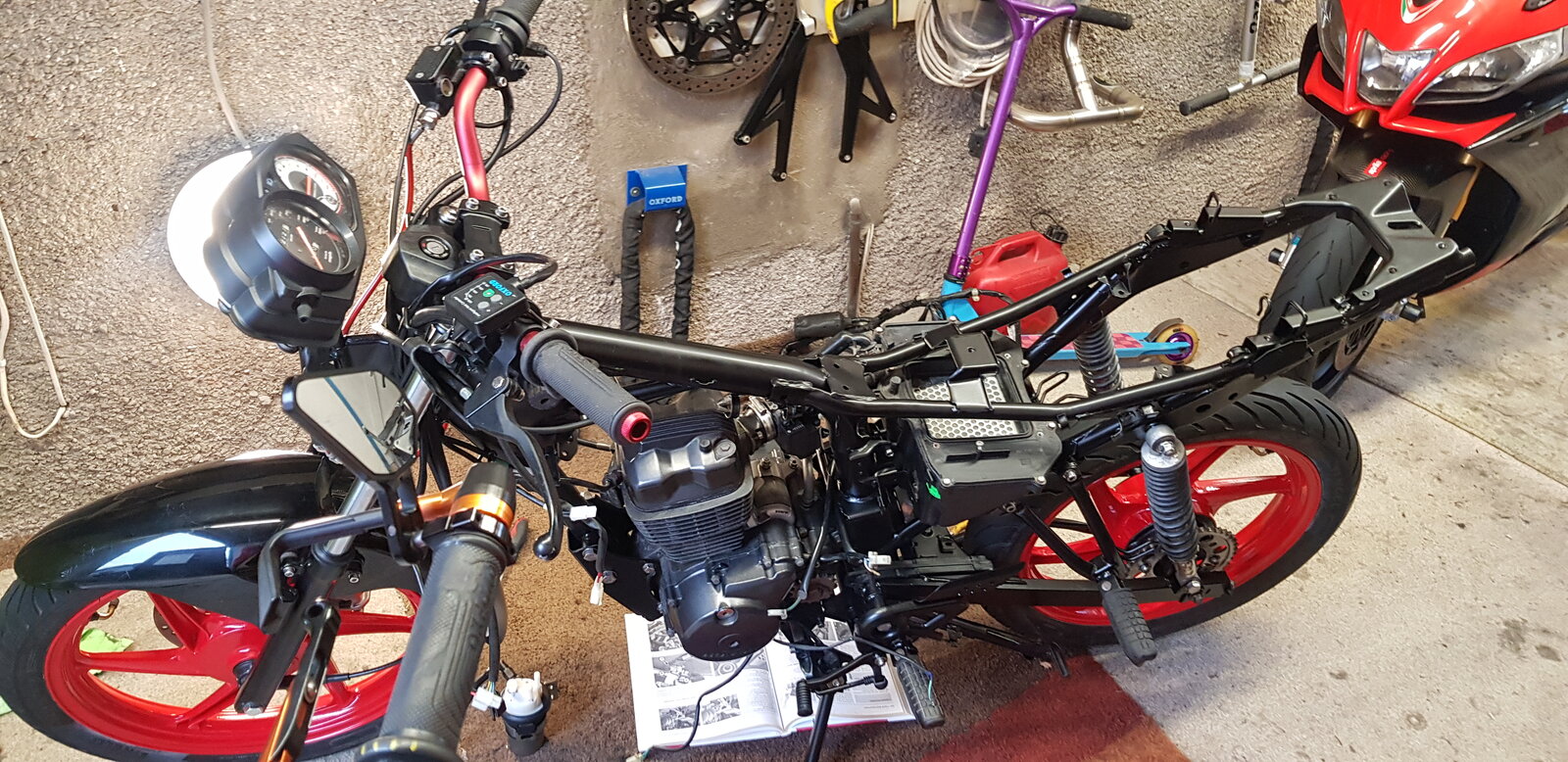

  4. Thought I'd make a start.... Get it in its wheels then go back to the wiring...
  5. 60% of the paint...

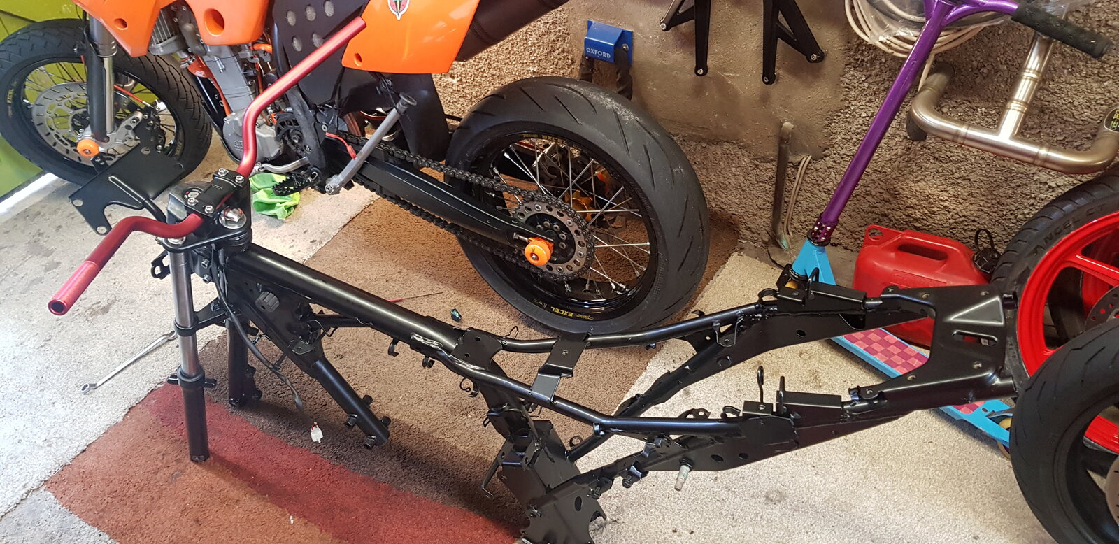

  6. I'll just keep randomly throwing pics up...

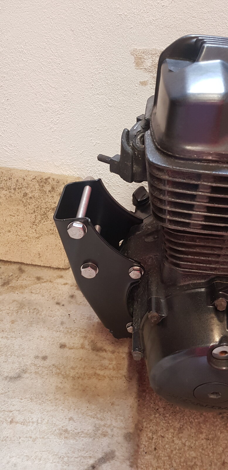

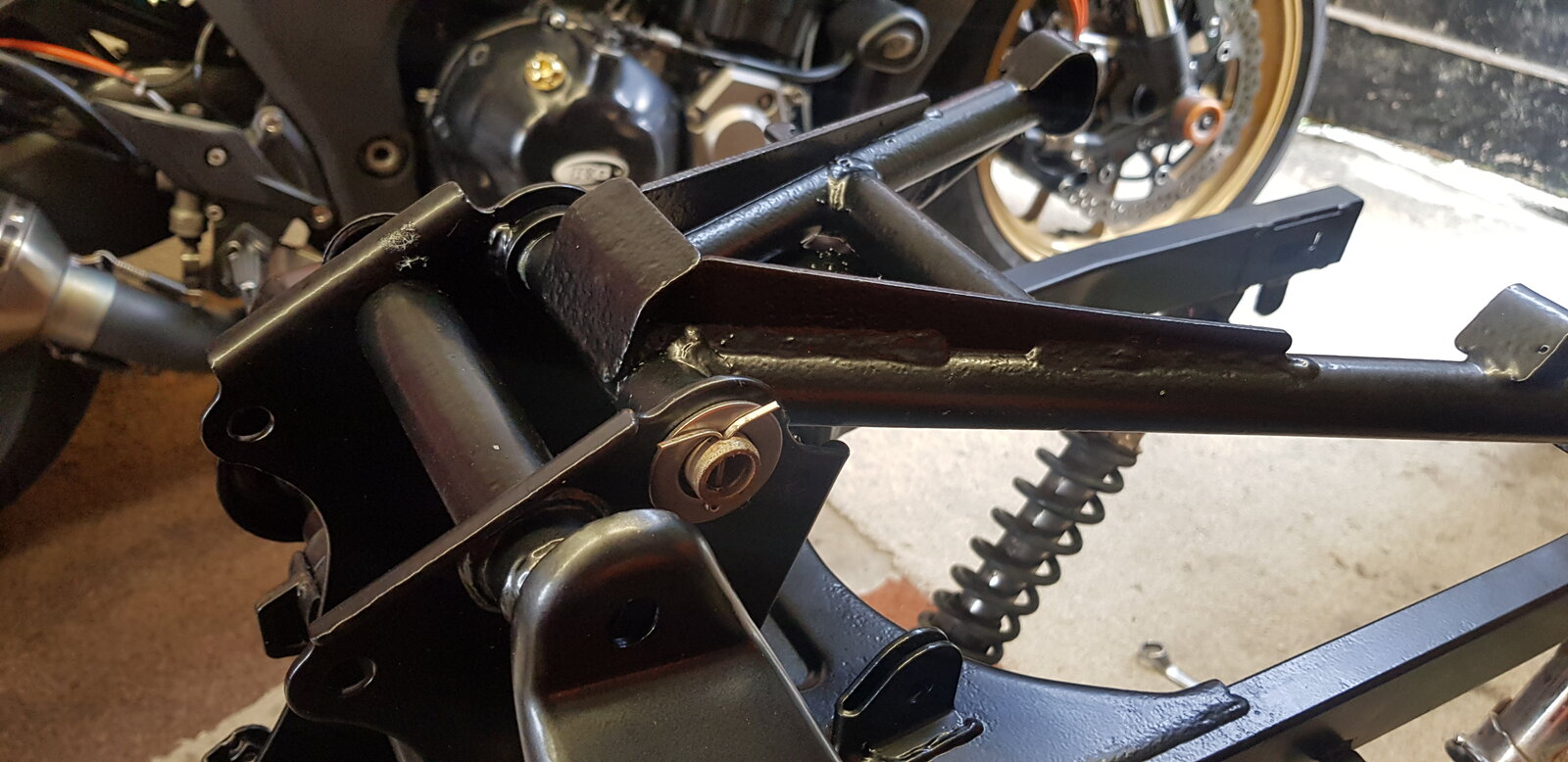

  7. Trying to improve where I can... No washer here before but our stainless spend got us a huge array of extra spares... Using stainless split spins also... Oem were pig iron... 15545478253827706237773642986383.jpg
    #127 comfysofa, Apr 6, 2019

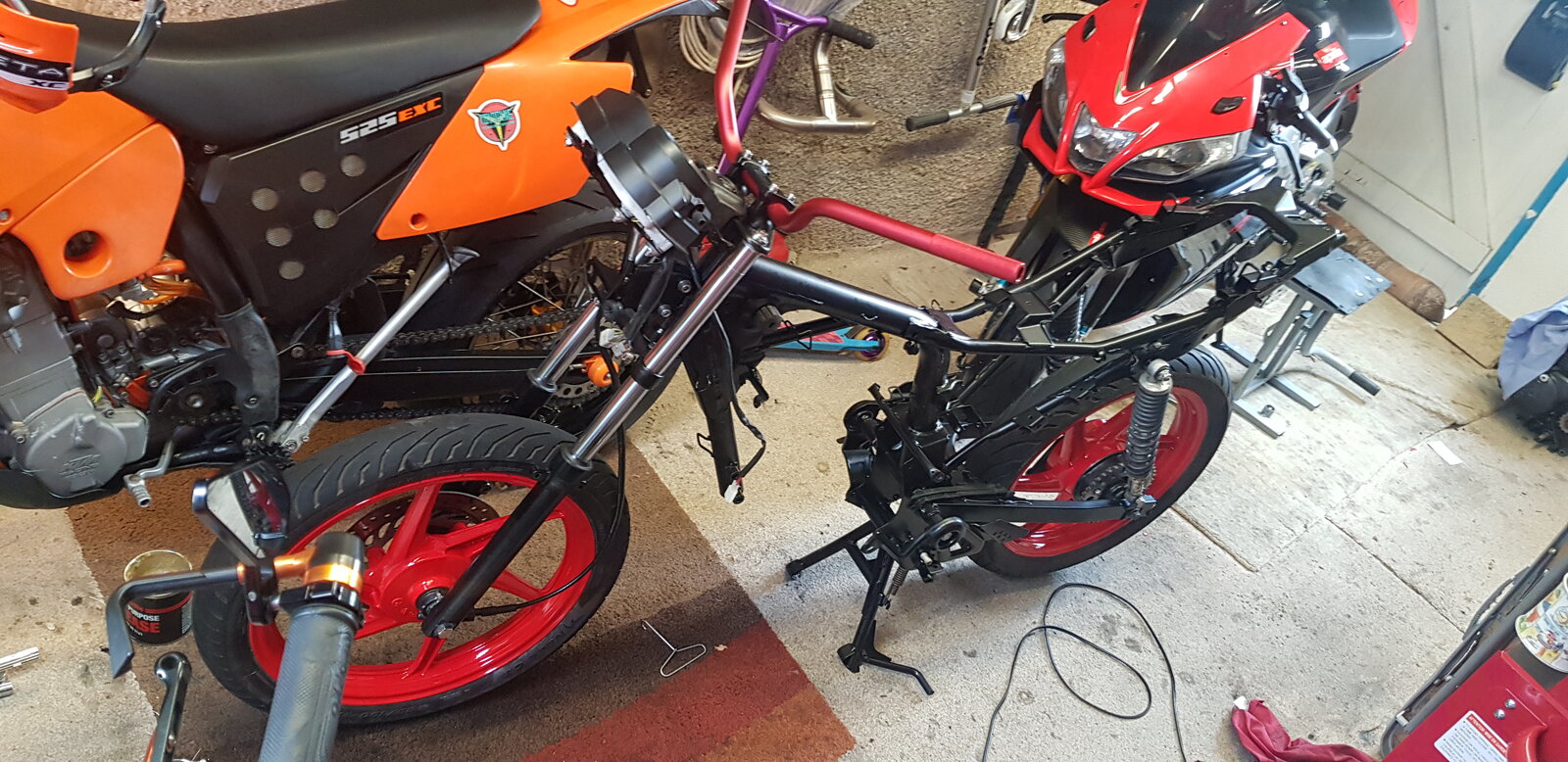

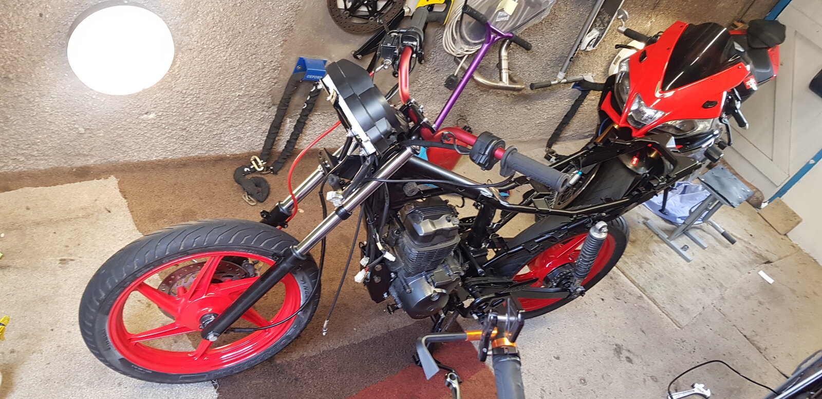

  9. Back on wheels....
  11. Getting there.... Missing a bolt somewhere... Theres a second bolt to secure the footpeg hangers... Meh... It'll turn up...
    • Like Like x 7

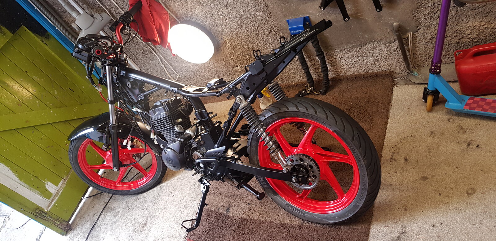

  15. Finished for the day...

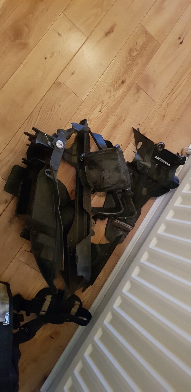

  17. Plastics to go in the dishwasher...
  18. That's what dishwashers are made for,the motorcycle hobbyist :)
  19. Yeah - its got a strip down coming soon also (the dishwasher) - every couple of years i pull it to pieces and clean the whole lot out...its 12 years old now and still works brilliantly...

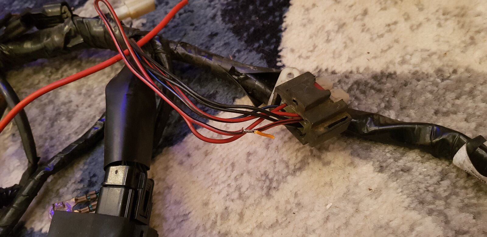

  20. Other half is out.... Thought I'd bring the loom in to extend a live to the front... Gonna take a line from here.. .
