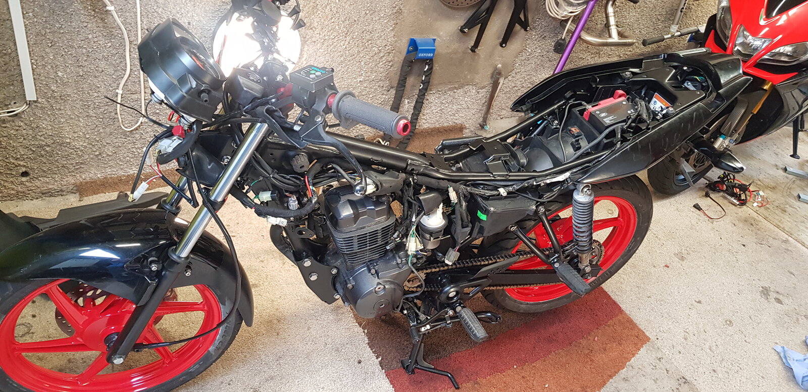

  4. And we're off again... Rear mudguard in..

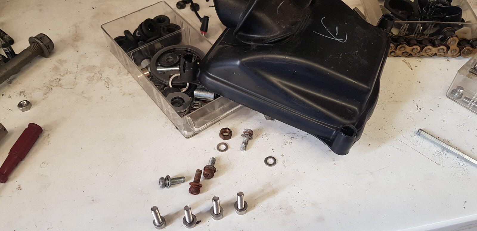

  5. Airbox cover bolts rusted to fuck... Replaced with stainless...

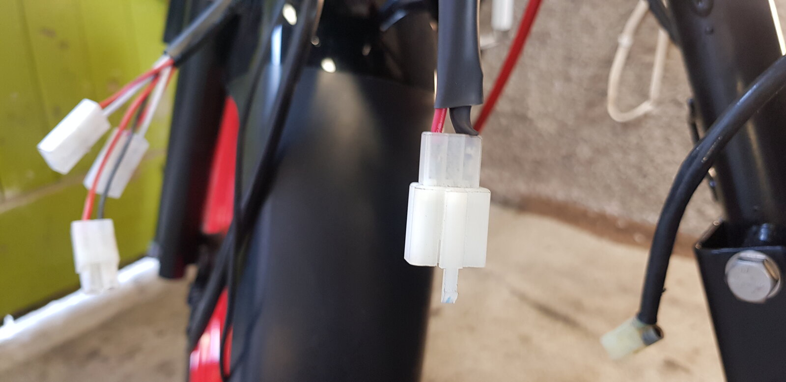

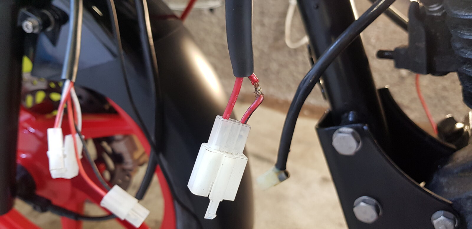

  9. Some quality wiring on here...
    And the bike shop passed this for an mot...
  10. Re soldered and heatshrinked .. Better.

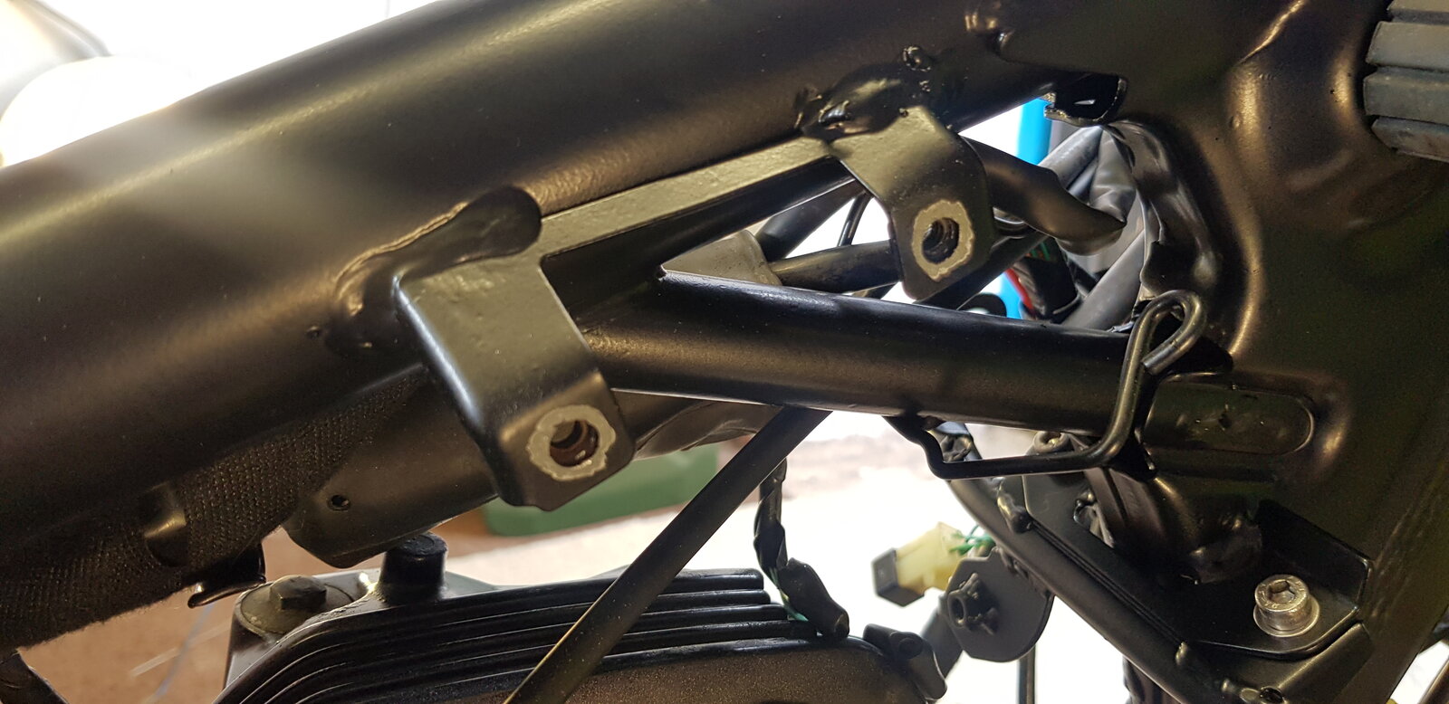

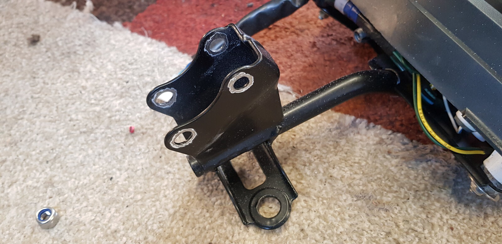

  11. Just in case anyone is going to do something like this... Every grounding point must be ground back with a dremmel or something like otherwise your lovely new resto will be dead as a door nail..! This where the coil will go.. 15546364042588262438951305489045.jpg
    • Useful Useful x 2
  12. That's exactly what we found on my mates newly purchased RD400 last week - no earth at the coil mounts after plastic coating. It had been restored a few years ago but never run even though the seller said it had last run 6 months ago :eyes: Luckily it runs sweet as a nut now and the pistons look new through the plug holes...

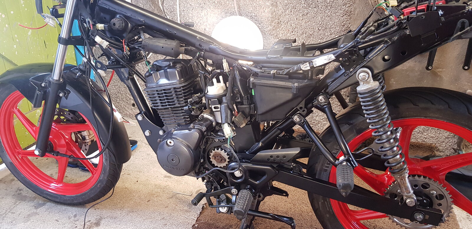

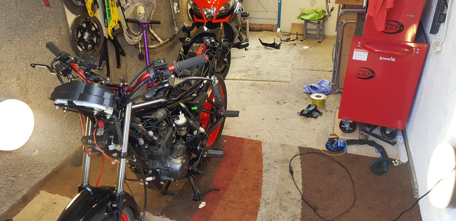

  13. Getti g the wiring in now... Having a bit of a reset and clearing up.... Something I learned from my dad.... Any sizable work will increase the frequency of mess created. Every so often. Stop. Reset and clear up... The whole job will be easier in the long run...

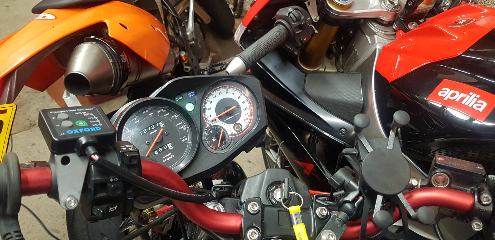

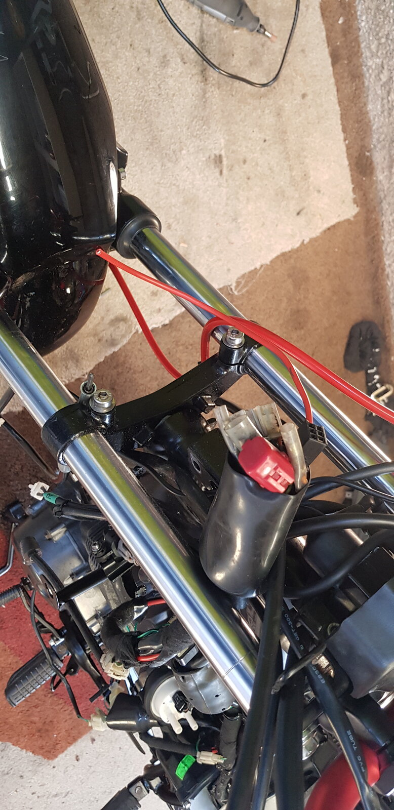

  14. Decided to whip the front headlight frame off to grind it as this will be a good mount point for the ground for the additional electrical stuff... Heated grips, USB sat nav mount etc etc... Ive also got a hid light which can be ran from here also...
    This is the heavy guage wire I taped in last night at the front also...
  15. Can't finish it today... Still have to work out the hid light... Just about to assemble the front fairing.. 20190407_172049.jpg

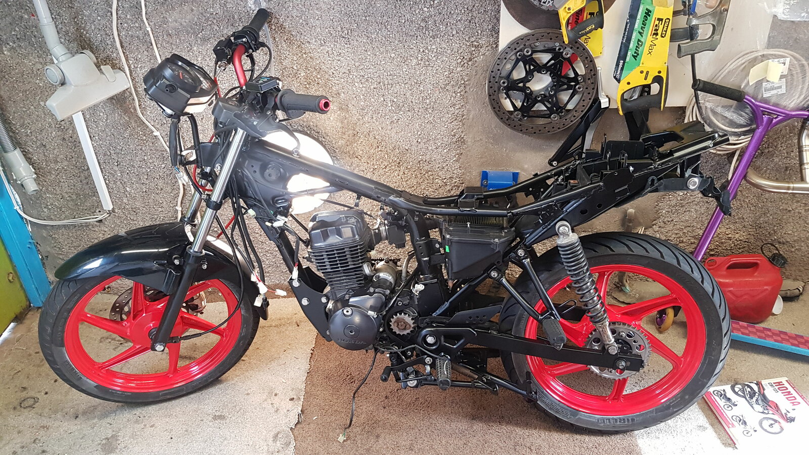

  20. Yep... Only an hour out here tonight but. . Electrically it's alive... 15547556981603320154469741824651.jpg 15547557266769170235265893256058.jpg
    Burnt through all the bownie points with the other half as I was in here all weekend.
