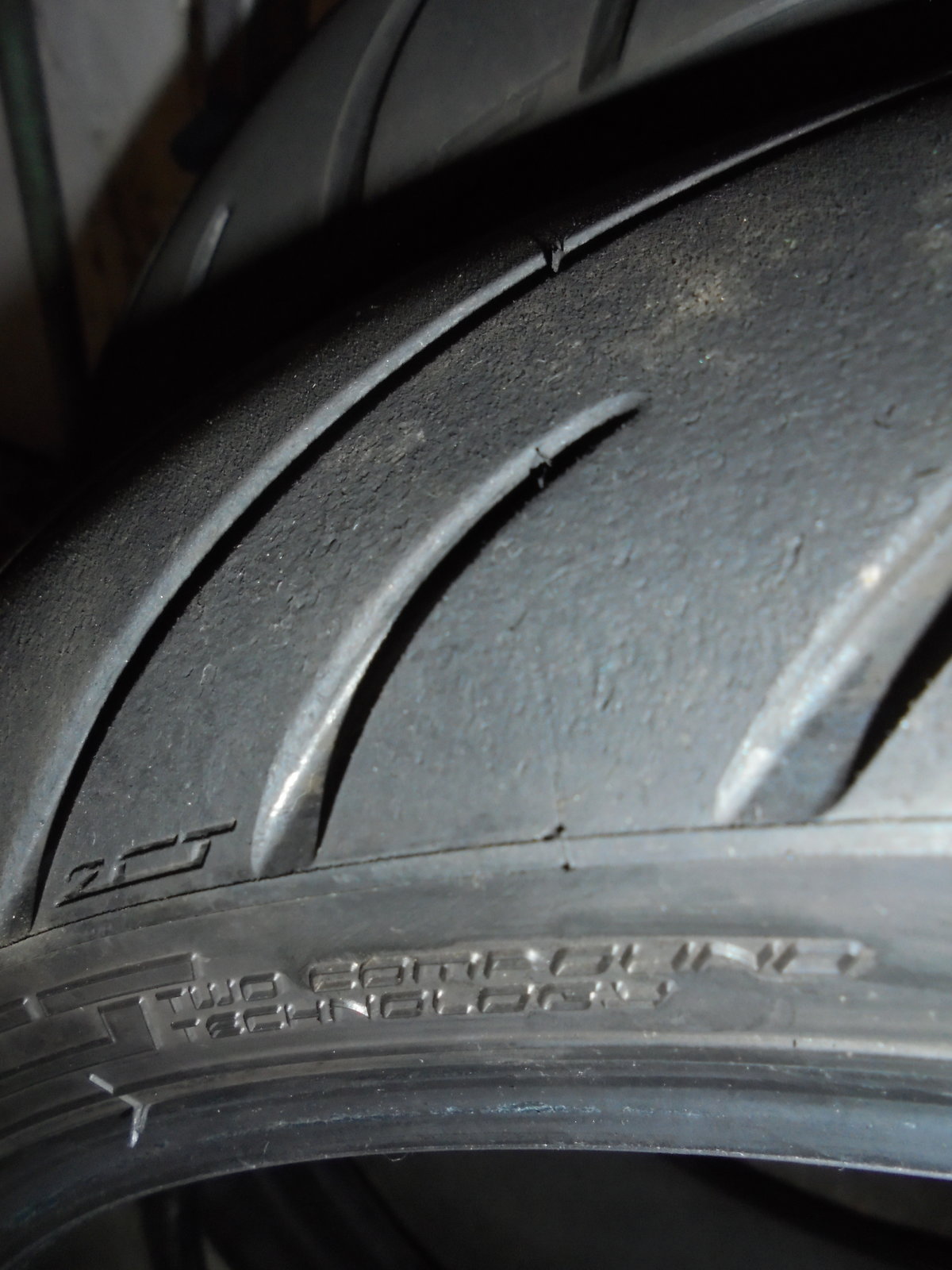

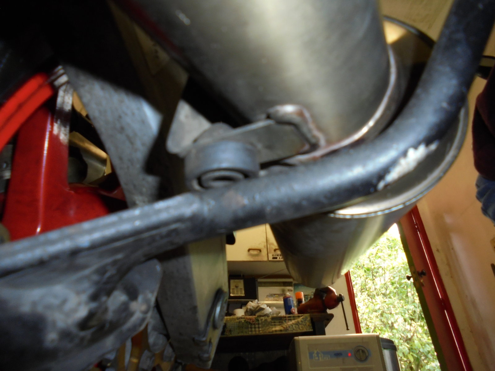

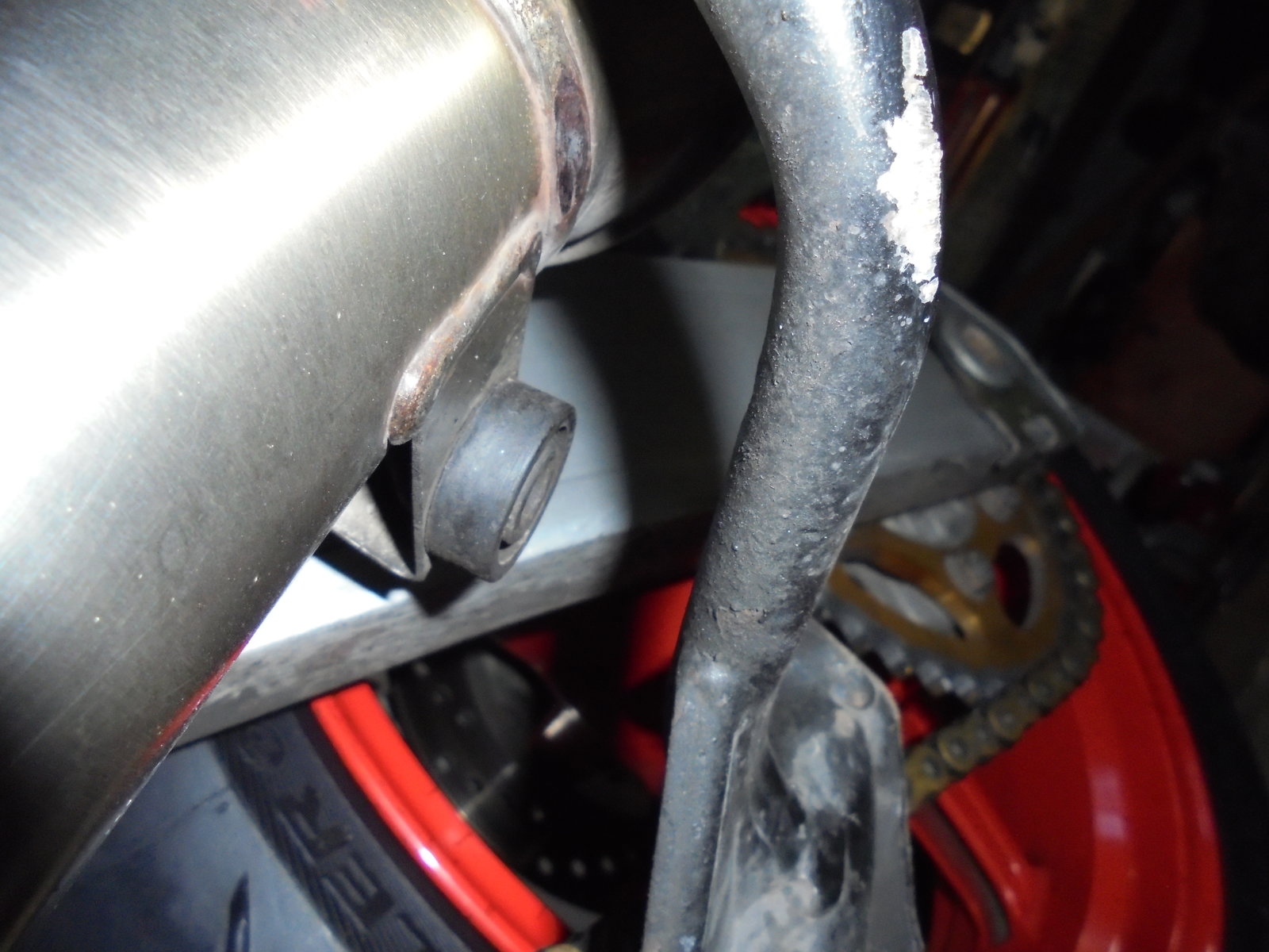

    I have to admit that I thought that the only stand stop was on the silencer ..... doh!
    I've had a more careful look and find that the stand does indeed stop clear of the silencer when in pannier free mode but actually just rests on the bung in pannier fitted mode. See photos. Also the front tyre I've just removed ... you'll see that it gets virtually to the edge before the stand scrapes.
    With the new tyres fitted I had to back the ride height off a smidge and it's now about 8mm.
    Why don't you get the ride height to about 10mm clearance between tyre and ground on the stand and then play with the preload to get the sag right. Try a search on this forum for loaded sag .... from memory about 20mm?
    I still think there's something odd going on with your stand if there's that gap between stand and silencer when the silencer is in the low position.
