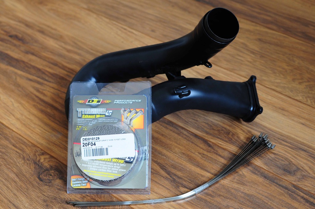

  1. Did you get your ti titanium wrap....
  2. Not yet, hoping it will arrive today/tomorrow.
  3. lol .. im following your lead ... :) ... Ordered mine today off ebay
    Also ordered some bolts that can be lockwired for the exhaust shield once i get my ceramic coated header and a replacement carbon fibre exhaust shield from powerbronze and the ti exhaust wrap.. as my bolts were forever falling out due to the heat... .. Loctite did not work... blue or red...

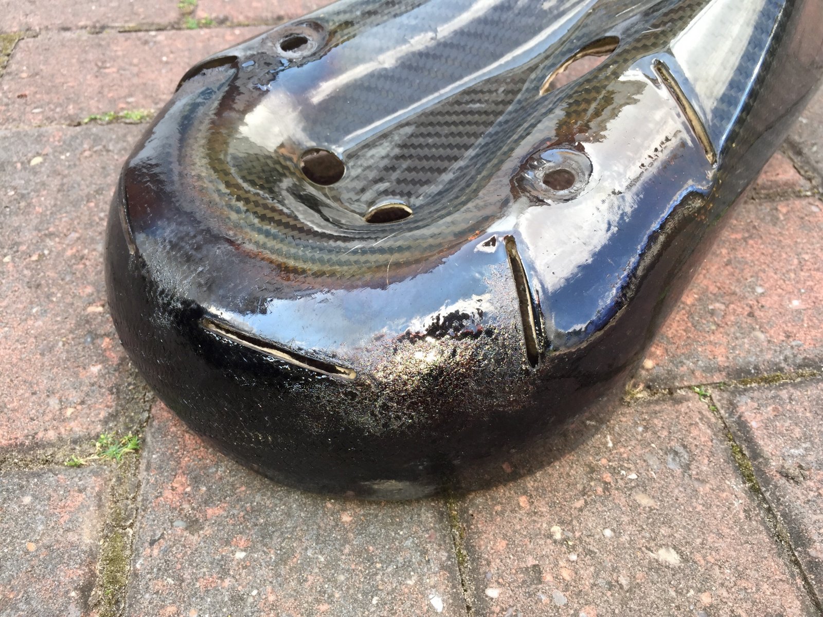

  14. Picture of my current exhaust heatshield ... Proper BBQ ..1k miles later .. Going on down there ... Might fit a grill ... So for all you people thinking about buying the carbon heatshields without any protection then don't .. It don't matter on brand or company supplying .. This one was foil lined .. And fitted on top of a metal heatshield ... Unless of course you like the burnt Matt rat look .. Lol .. Hence before buying carbon heatshields and huggers .. Ceramic coat those pipes and fit exhaust wrap ti titanium ...

  15. Shit that is toast. I have the standard smaller heat shield and I have to be honest I don't think the heat is that bad.
  16. Whoa! That really is burnt!!

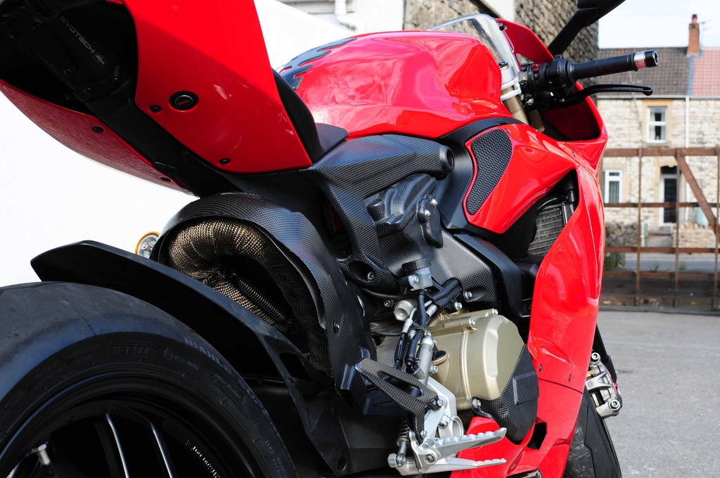

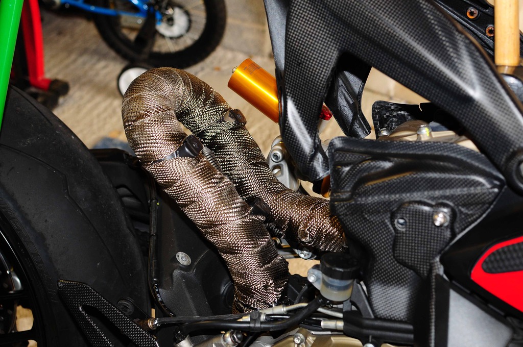

    So my wrap turned up today. I'm so pleased I went with the titanium stuff and not the fibreglass wrap, so I didn't have to worry about soaking it first then wearing gloves and spraying it afterwards. Very easy to wrap, but 15' is almost exactly the correct length, you've got hardly any spare wrap, so don't do what I did and bugger around trying to get rid of the frayed edges and and cut loads off. I just managed to squeeze it on. The fraying was the only thing that annoyed me, hence why I have three clips at the end to try and contain it from getting worse. Oh and the clips I used seemed rubbish, i couldn't really get them to be, what I would call, tight. We'll see how it all holds up.
    Anyway, going to go out and fit it back on in a bit. If nothing else, it looks pretty cool :Cigar:
  17. So the wrapped header is back on, looking good, but still cooking my ass. Hopefully my heat shield won't burn to a crisp now though :upyeah:
  18. I'm hoping that once that wrap has burned in it will start doing something useful in heat retention
