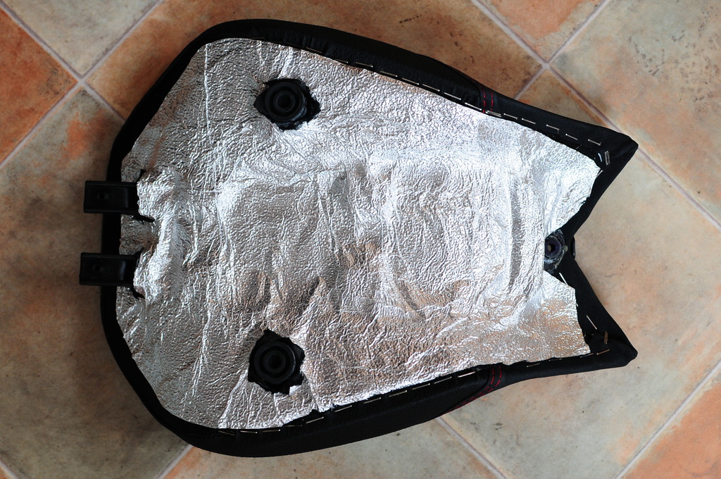

  7. Funny you should say that, I've recently bought myself a sheet of TeknoFibra (Teknofibra Heat Resistant Materials) and lined the underneath of my seat with it. I'm yet to go out and see if this makes a difference, but there's a chap on the 899panigale.org forum who says it's completely cured his hot seat issue, so we'll wait and see!
    On that note, the sheet cost me £120 delivered and I only needed a quarter of it. If anyone out there wants to line the underneath of their seat with it and wants a piece let me know!

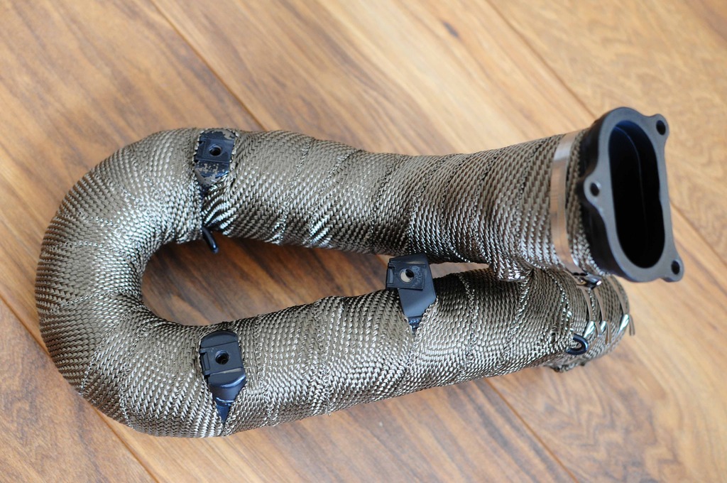

    Yep ceramic coating was a really good job.. and it was quick... 48hr turnaround.
    Fitted the bike backup with the ceramic header and titanium wrap.. What can i say i feel like im cold now when riding... The heat used to keep me warm... I actually miss it ...lol.
    Also put a new carbon fibre hugger on... No burn so far. So all in all im very happy. The hugger does how ever still get hot... but not hot enough to burn it as of yet. been running the engine temps up aswell to 100 - 104 with traffic jams ... So far so good.
    Will stick with the standard small 2012 heatshield for now... will add on the carbon fibre one once the wrap has settled. The wrap was really good too only smoked for the first 20 minutes. and then all good...

  14. So I've finally had the opportunity to get out on the Panigale for the first time since fitting the TeknoFibra to the seat and, at last, I no longer feel I'm going to be burnt to a crisp or sweat to death in my leathers whilst riding it! The heat hasn't totally disappeared but it is so much more comfortable now than when I first got it. It's obviously hard to put any actual science together for this or to make it meaningful other than saying how it feels to ride, but I'd say what I've done has removed something along the lines of 80% of the heat I was feeling beforehand. Maybe 81% at a push ;-)

    Ceramic coated rear exhaust header (internally and externally coated)
    Rear exhaust header wrapped in titanium exhaust wrap

    Ducati Performance comfort seat with TeknoFibra heat shield material applied underneath.

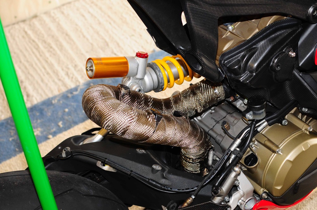

  18. ...just wouldn't have minded seeing a pic of how you applied the heat wrap to the exhaust
    No worries thou
  19. No problem, these are the only pics I have, not sure if this will help...
