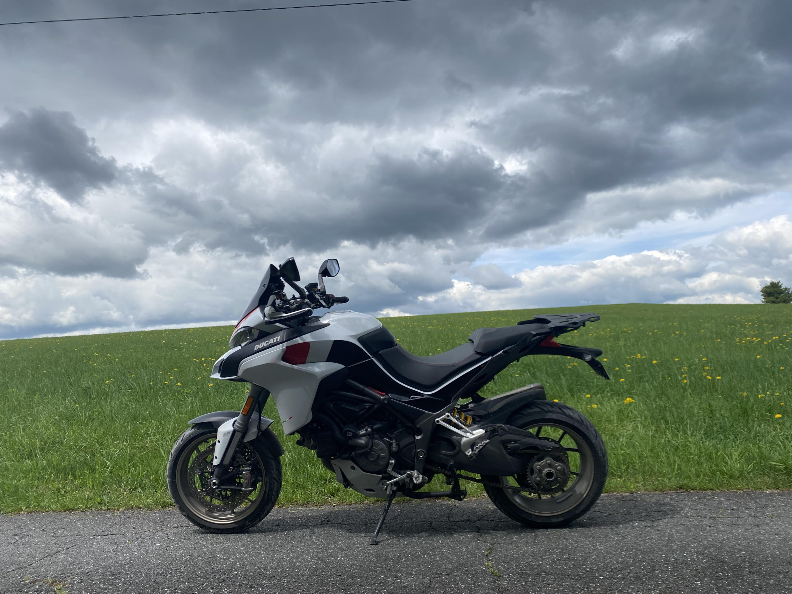

  4. Same prob finding OEM rear from Ducati in the States, back ordered with no real date in site. bought a 14 front and DID 530 ZVMX 114 that I will cut down as necessary - wanted to go 14/40, so just one down in the front for a bit more torquey fun - after market solutions are equally unavailable for rears - not in stock.
    I've included a photo - sorry no bin...
