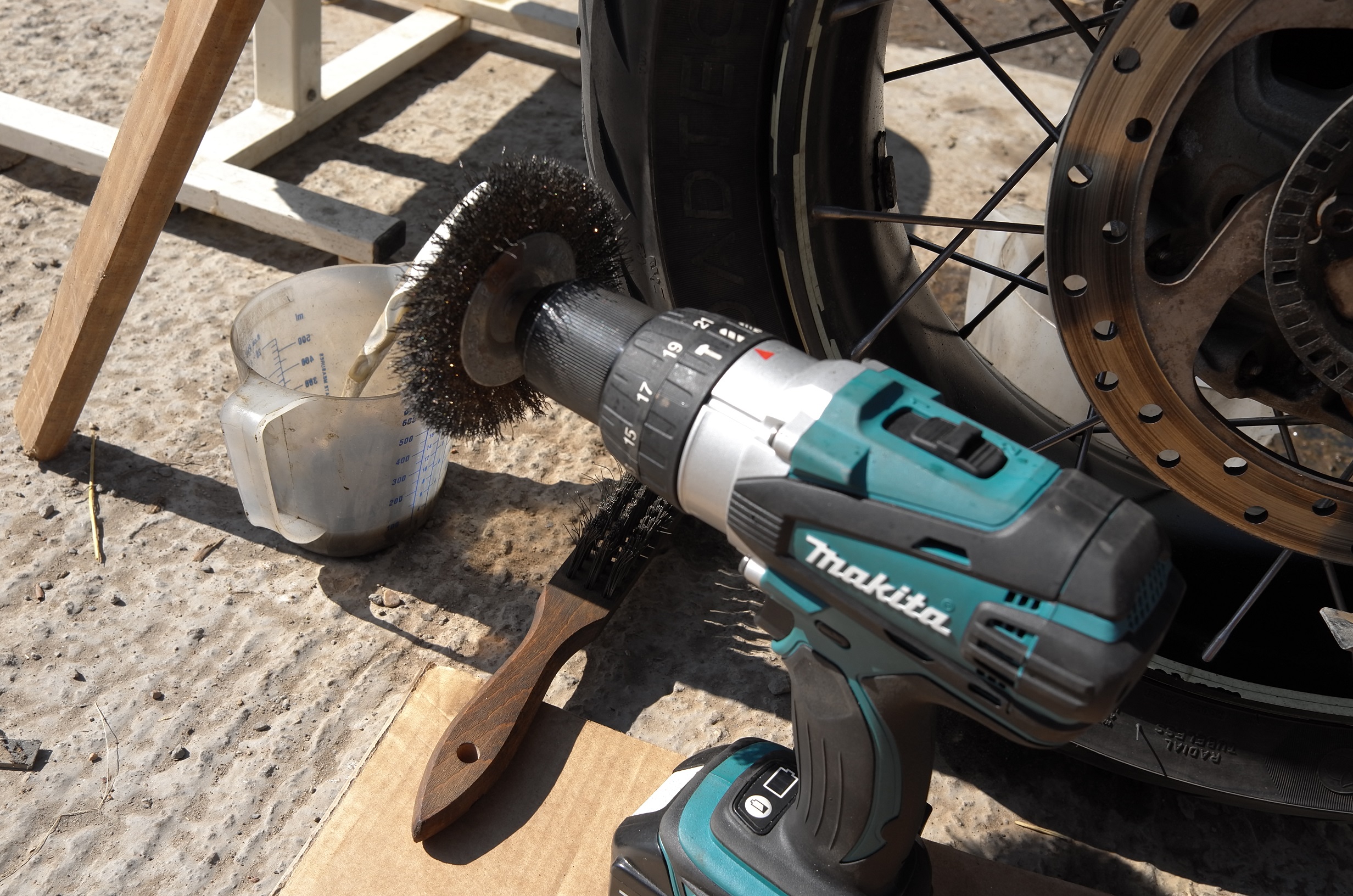

  6. Are you using SDoc100 correctly? You dilute into warm water & pre rince the bike before applying with 1ltr spray bottle (personally). It always takes a good layer off for me each time I use it. Before doing my washing routine & the chain rust or shite gets tidied with this tool.
    However I still use a toothbrush-&-parafin to clean up my chain & prep side links for general overview.
