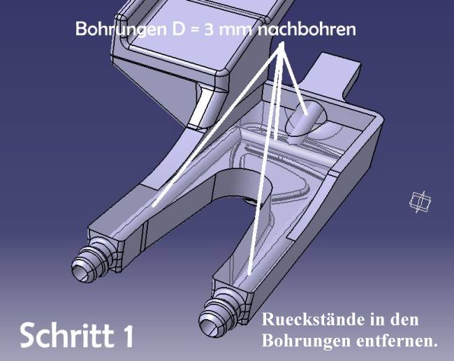

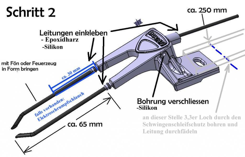

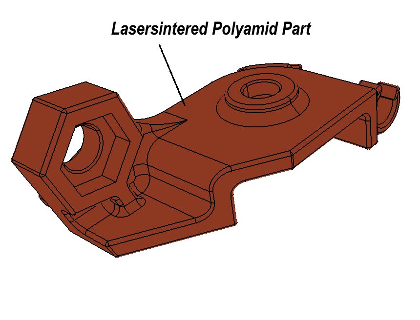

    I Provide only the 3D data there for all available.
    Manufacturer of the laser-sintered part is the Company Shapeways.
    What you can order from Shapeways is just the blank.
    You have to clean the holes with a drill ( There are still residues
    from printing it ). Then you have to fix the oil lines with epoxy resin.
    Then you must close the cross hole with silicone or epoxy resin.
    The line you get, for example, in EBay.
    Check for Scottoiler vacuum line.
    so you should be technically gifted:smile:
    Reiner

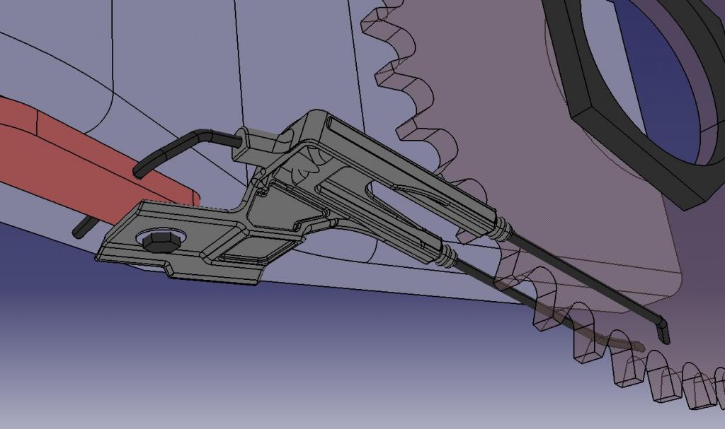

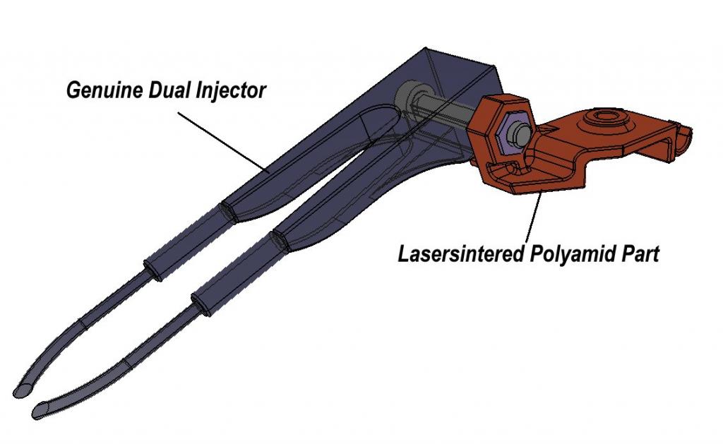

  3. one more picture:
  4. I can see there's a bit of design and engineering gone into this but, come on, drilling and glueing? After paying $37.08? Sorry, I'm out. :rolleyes:

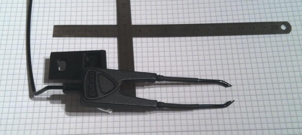

  5. For the genuine dual injector you have to pay the same price and you
    must manufacture a modified mounting.
    Say me whats the difference ?
    Once again:
    I`am not the manufacturer of the print parts and I earn no money with it.
    I just give the Idea and the 3D Datas.
    If you are searching for a solution you can use my ideas if its helpfull.
  6. Understood - which is why I didn't buy the genuine dual injector. I like this alternative design but I thought this was being sold as a complete solution and, imho, for the money shouldn't need any drilling, glueing or anything else? If the manufacturer ever decides to finish the product off (drill, glue etc) before dispatch then I, for one, would buy it. There you go. :upyeah:

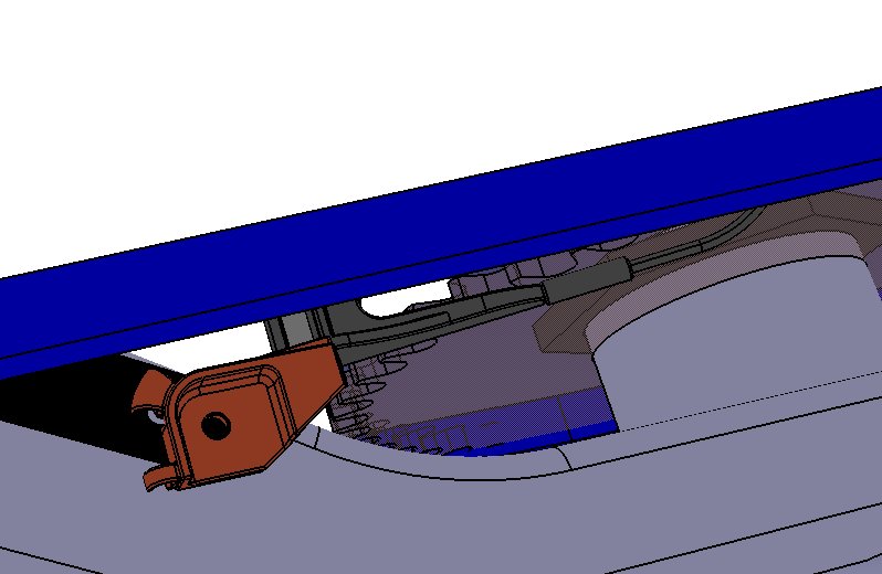

  7. This looks like a neat solution. The only thing I would say is this looks like it has to be mounted on the outside of the chain slide given its shape. I personally think (and have done so) that any fixing should go between the slide and the swing arm. That way any chain bounce would hit the slide and not grab the fixing. I understand that due to the mounting location so near the sprocket the chances are slim to none , but I still could not put something on the outside without having a nagging doubt when I ride. The slight gap created by mounting it between the slide and the swing arm gives you a space to run the oil tube through also, assuming you want to run the feed to follow the abs/brake lines.
    Great design though, you should send scottoiler a note as they are always looking to grow their penetration into the market place with additional mounting options.

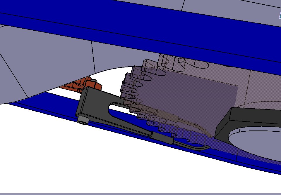

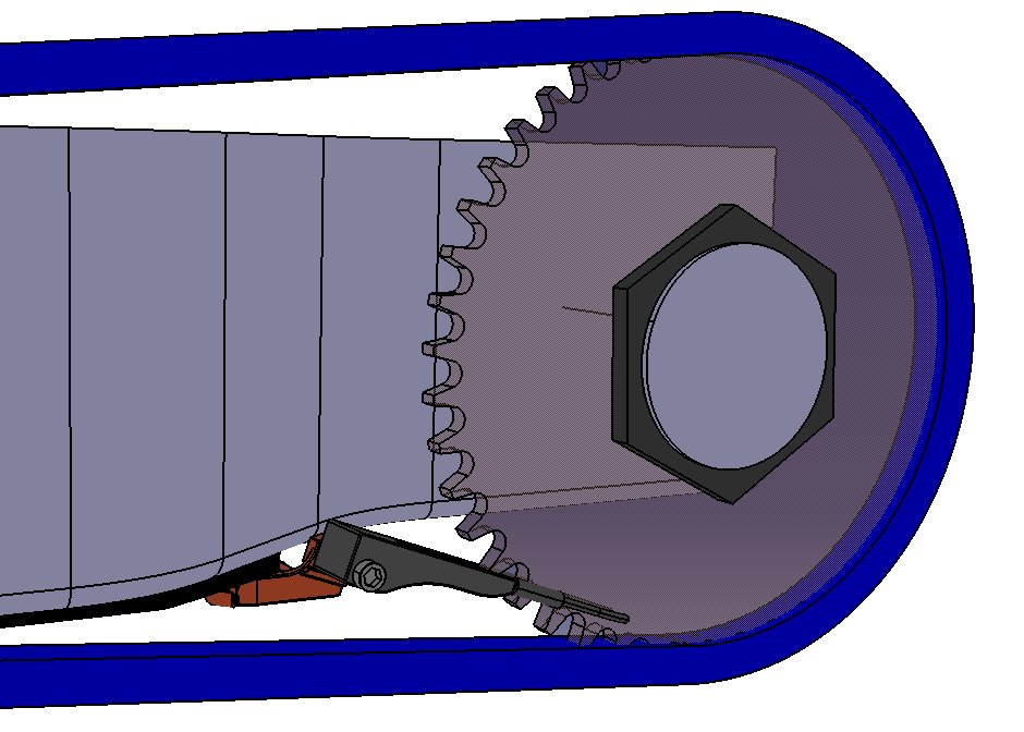

  8. Hello,
    the part is not in the direction of the chain.
    #29 vau, Mar 2, 2014
  9. vau,
    Very interested and my compliments on another neat design. I particularly like the built in clips for the feeder tube. :upyeah: I haven't been able to get on to the Shapeways site so far today (internet is very slow this morning over here unfortunately) but will do so shortly - hopefully.
    One question - when I went on to the Shapeways site last week I didn't spot this accessory for sale? Did you design it very recently as a result of the discussions on this thread or was it already available before (and I'm just blind :rolleyes::wink:)?
    All the best, Mark

  17. Thanks Vau for the design, had a bracket made up to yor drawings, it's a perfect fit & made a nice neat installation.
    #38 colin57, Mar 11, 2014
  18. Thank you, I am pleased !
