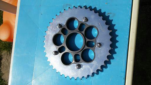

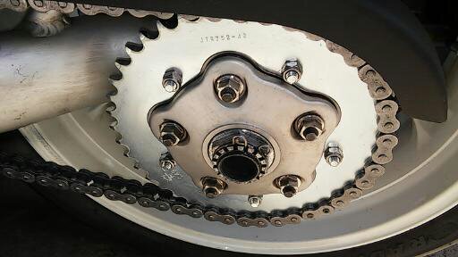

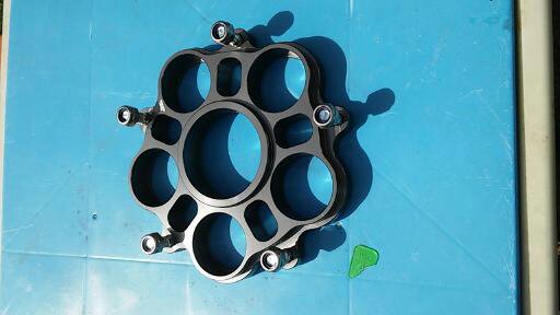

  10. I changed the chain and sprockets on my Monster S4R last winter, I got them from Wemoto and ended up with a sprocket carrier as mentioned. It bolts to the back of the original sprocket carrier and means that in future the sprocket can be changed by just undoing the 5 nuts. 1495023430344.jpg 1495023430521.jpg 1495023430744.jpg
  11. Thanks for the info! This looks like the way to go.
