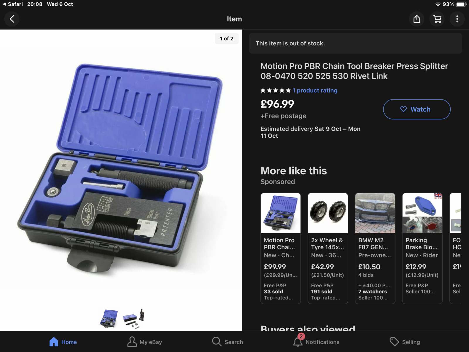

  2. Not sure of the case colour but i bought a Motion pro PBR for around £80, great reliable tool should last forever if treated properly, I have mates that use grinder and ball pein hammers to remove/fit chains on track bikes and never had a problem, personally id be thinking about the chain wrapping around the front sprocket all day :thinkingface:

  5. Andy, I had one on my 2018 Christmas list, it was thought to be quite expensive - but not for me. Easy and accurate chain replacement is pretty much guaranteed now. I still grind off the heads of the old rivet but only to avoid wearing the DID tool unnecessarily

  9. Yeah, I know, I read many of them before purchasing and decided it all depends how many chains it’s going to be used on. I’ve 2 bikes so in my case it’s likely to get used no more than twice/year. Plus, I always use the grinder to remove the mushroom head on the old pin I’m about to extract, thus relieving pressure on the extractor. I’ve only used 2x so far and it’s suffered no damage. For my needs it’s a good, cost effective solution.

  13. That's the same as the motrax one I recommended, only I paid more than you : unamused:
    Having done a few chains with it, it's a cracking tool. I always grind the heads too, it's just easier.
