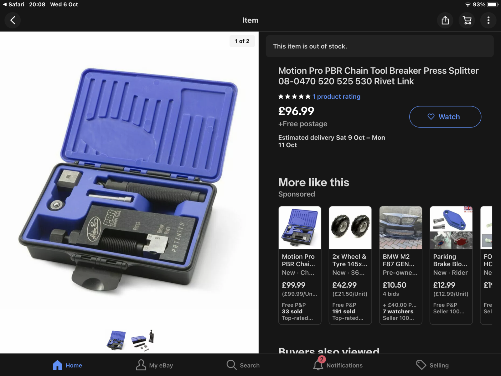

  4. Can anyone recommend a good quality kit that can flare sort links and stake the solid links? Only one I can seem to find is the motion pro PBR?

  7. All the kits seem to be for either soft links or solid links?
