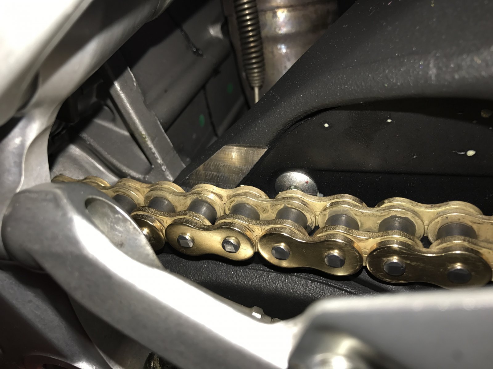

  7. My chain snapped on my 1299s due to rubbing against the swing arm @7k miles! Damaged engine casing and other bits! :(
    Ducati repaired it all under warranty with new replacement engine cases (original numbers stamped at factory on new cases etc). New updated swing arm as well.
    All good now :)
  8. This is 'new' swing arm, it's basically the same as the old one but has been machined where it used to rub. I had a upgraded zvm gold DiD chain to replace the lower spec oem one.

    Pretty clear from the pictures above that Ducati have machined the swinging arm to allow more space so maybe it's that the swinging arms are all a little too big.
