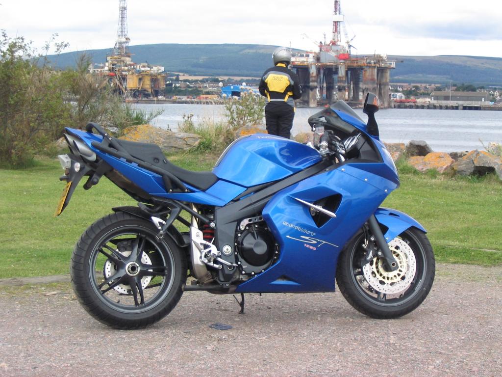

    This was mine:
  6. I loved my ST kept it for over 4 years used to make my smile every time i rode it. But I'm getting on a bit (60) and after about 70 miles my knees would be complaining and my neck would ache from having to tip my head back. I've always fancied a proper sports bike but totally impractable due to age, 2 up riding etc but a multi is a sports bike with comfort so i spent the kids inheritance on my
    sixtieth birthday.
