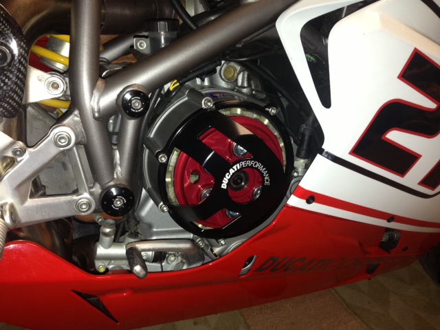

  5. Here it is. First start will be at 0700 tomorrow morning. Hope the neighbours like it!
  6. How were you riding the bike with a broken selector spring?
  7. Pas far as I know I haven't been. You can still ride the bike, the lever just doesn't return to its normal position. Selector spring may be the wrong term. I know there was a lot about this on the old site we used to go on.
  8. Looks great, so how is it?
  9. You will have to speak up a bit Arthur, he can't hear you
  10. Not that loud tbh. Probably get louder as the plates bed in. Clutch action isn't as light but bearable. Still getting used to it, only done 10 miles so quite hard to gauge really.

  15. Sigma out, DP dry slipper in :)

  18. Looking good Arthur, just spay the silver collars black, will contrast nice with the carbon cover and the red pressure plate.
    Did you fit it or Snells ?
    Just wondering what it was like to do.
  19. Rearsets are DP bradders, don't mind them but would not buy them again, did have the corse rearsets but moved them on.. you don't see the linkage when the fairings are mounted..
    Yes Ian I fitted the clutch with some loan tools, you WILL need the Ducati service tool to remove the main gear from the crank, also the nuts need to be tight, 190nm tight... It's a reasonable job takes around three hours, the stack height needs some adjustment as it has a reasonable amount of engine braking as it comes needs some more slip to be in the same ball park as the Sigma, tbh the clutch is as you'd expect for a dry unit, harsh to pull away etc, lever action is a little heavyier even with the DP slave, noise is propper Ducati dry clutch.. Im happy with it but the Sigma is a better ride IMO you get much more slipper action at the lever than he Sigma too.. Overall if you want the look, easy service and correction and the chinky chinky sound then it's worthwhile... :)
