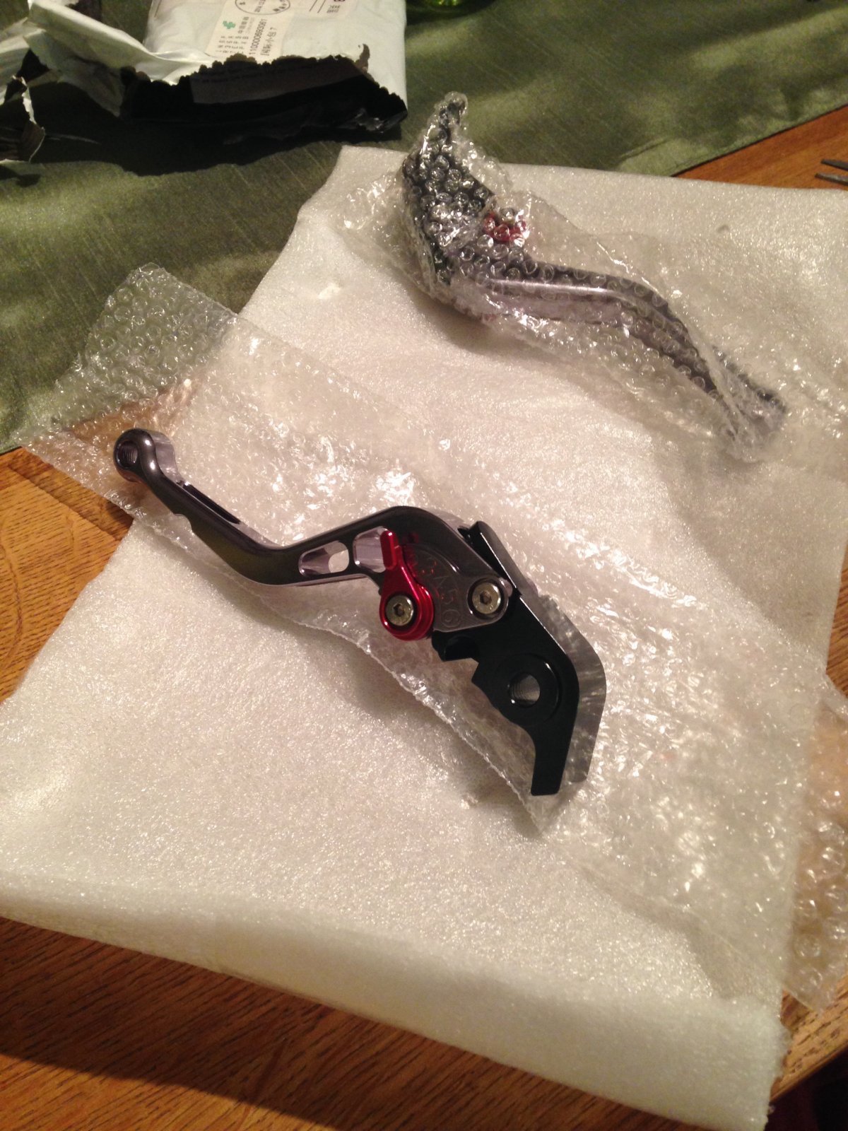

  9. Well,the shortys turned up this morning 10 days after completing the order. No hidden extra shipping fees or hidden import taxes just £15.88 as specified. Inside the small thin plastic bag was a sheet of foam which incased two small bags of bubble wrapped shorty levers. First impressions of the undamaged levers or very good indeed. They appear to be well made. No ruff edges or miss matched plastic anywhere. In fact I'm rather chuffed with these although I'm yet to fit them. If they fit ok and work ok then I think thats £15.88 well spent and if they fail when using them then,well I rather not think of that. I post some pics when I've fitted them. Doesn't look to complicated to do. Just need a dry weekend. Fingers crossed.
  10. They look ok , what was the link?
  11. Check the play in the bolts as you may need to tighten them up a bit, but other than that they shouldn't give you any problems. They look like a nice finish, the colour is good and no obvious cheap machining (marks in the alu caused by over-using the cutting blades) and a bargain at that price!

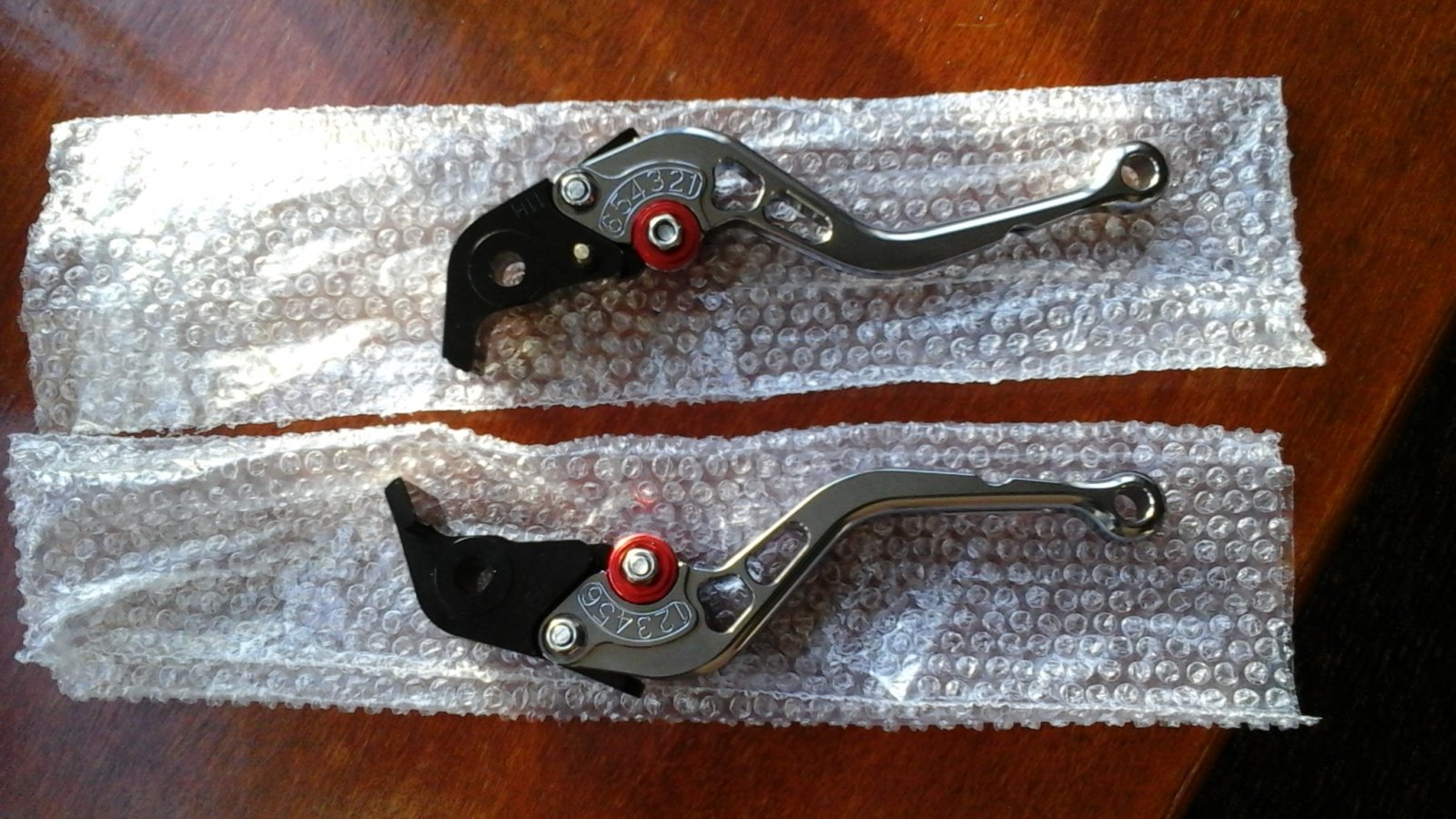

  16. 20141212_135302.jpg Look good to me mongoose, still waiting for mine to show up,and I think I ordered them a couple of days before you,but eBay delivery date does have a pretty wide window!......
    Came this morning, and I have to say I'm quite impressed with them,quality seems very good...god knows how they can knock these out at this price.
