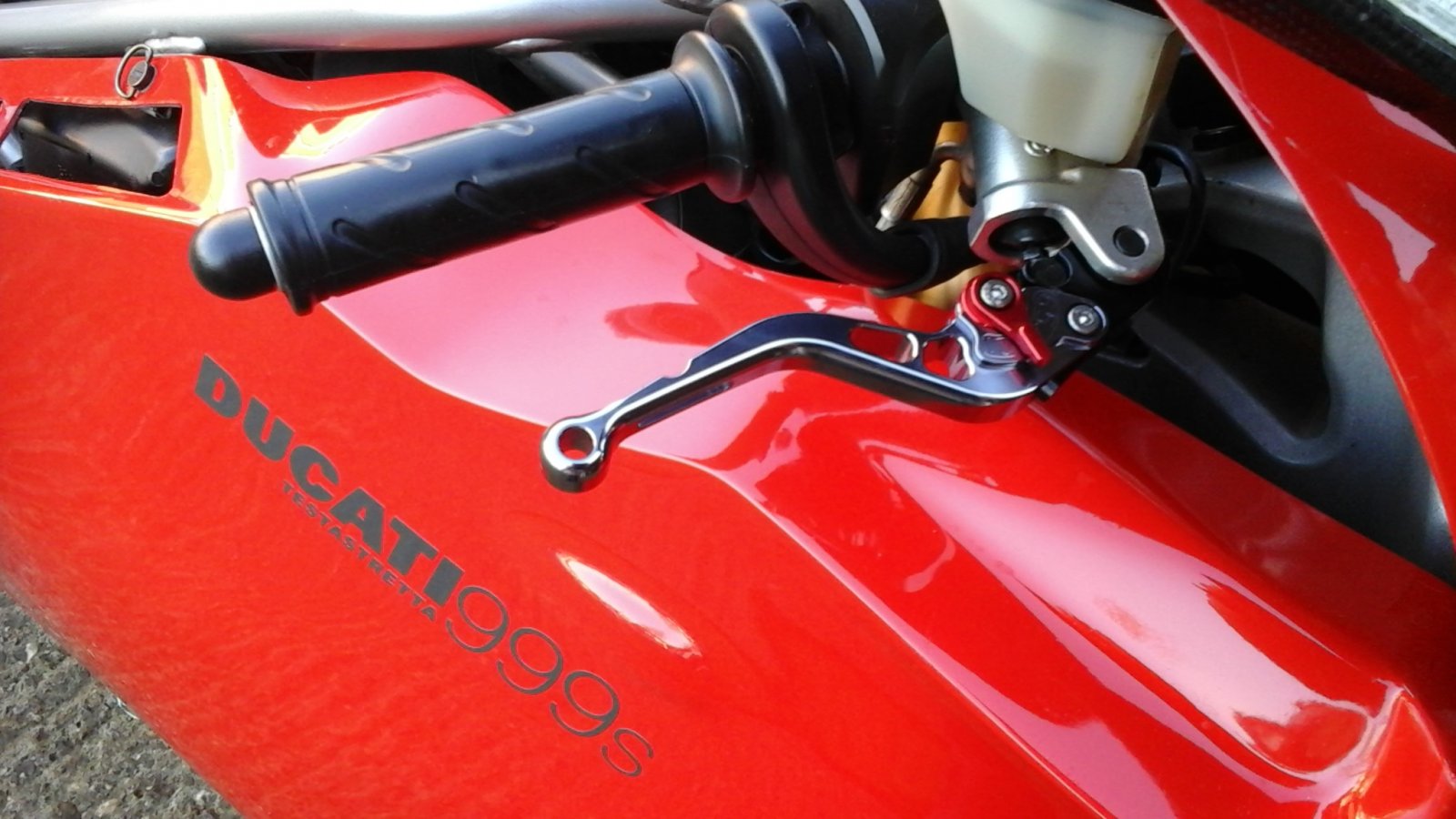

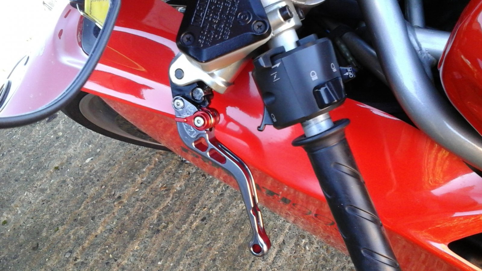

  12. Got mine fitted this morning, fairly straightforward, the most difficult bit was trying to get the pushrod/nipple out of the oe levers, it is a VERY snug fit with almost no room to ease it past the lever ,I managed to get one out okay, but on the clutch side I had to resort to filing a small flat on the nipple so it would go past the lever. ..anyway job done and I'm happy with them. 20141213_122541.jpg 20141213_122613.jpg
