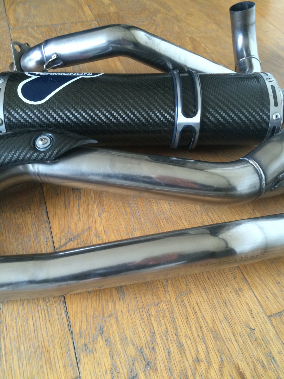

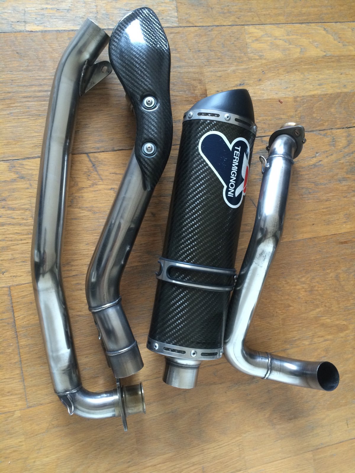

  2. This is mine after a few hours with wet & dry and autosol...... it was a mess before I started, 10k miles in all weather and never cleaned once..... Life's to short to be cleaning exhaust pipes..... or so I thought until I decided to clean it....:)

  6. So is " wet and dry " autosol diferent from normal autosol ? ( stoopid queastion ? )
  7. Oven cleaner spray on stuff make sue it doesn't go anywhere near alloy, works a treat or place in plastic bin bags spray leave for a few minutes hey presto
  8. Hope you're being serious...
    He said wet and dry AND Autosol!
    Wet and dry is the dark grey kind of fine sandpaper that can be used either dry or with water to make it more effective and last longer by washing the dust produced away. So he used that first to get rid of the crud and produce a dullish shine, then finished with Autosol to get the final finish.
    Like normal sandpaper, wet and dry comes in various grades, so it's a good idea to start with a coarser grade first, then a fine one.
  9. Use the wet n dry with autosol. Working up through the grades then autosol on its own. Comes up quicker.
  10. Wow, new one on me...
  11. Autosol is a cutting paste. That's why they don't recommend using it often on chrome plating. By using it on stainless you are speeding up the process of removing the pitting. Still not as good as using mops and soap though.
  12. I'd expect the Autosol to wear the wet and dry faster, as it's harder than the stainless. Never having tried it, I don't know though. I use the mop and soap method.
