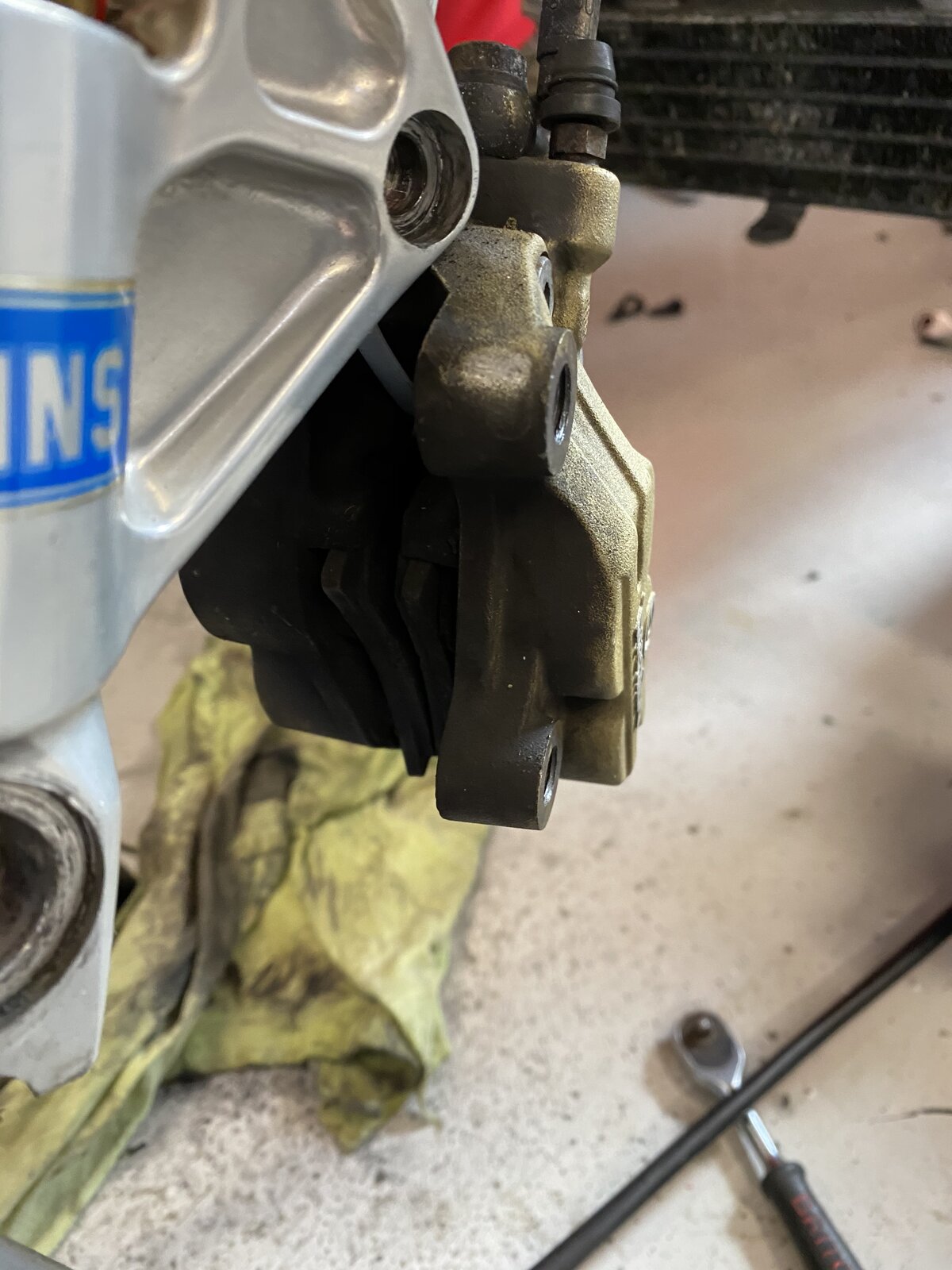

  2. SDOC100. Works a treat.
  3. I have SDOC allready as I swear by the stuff, Wonder Wheels, and now Bilt Hamber Autowheels. I will revert back with some pics, as these are grotty as hell!

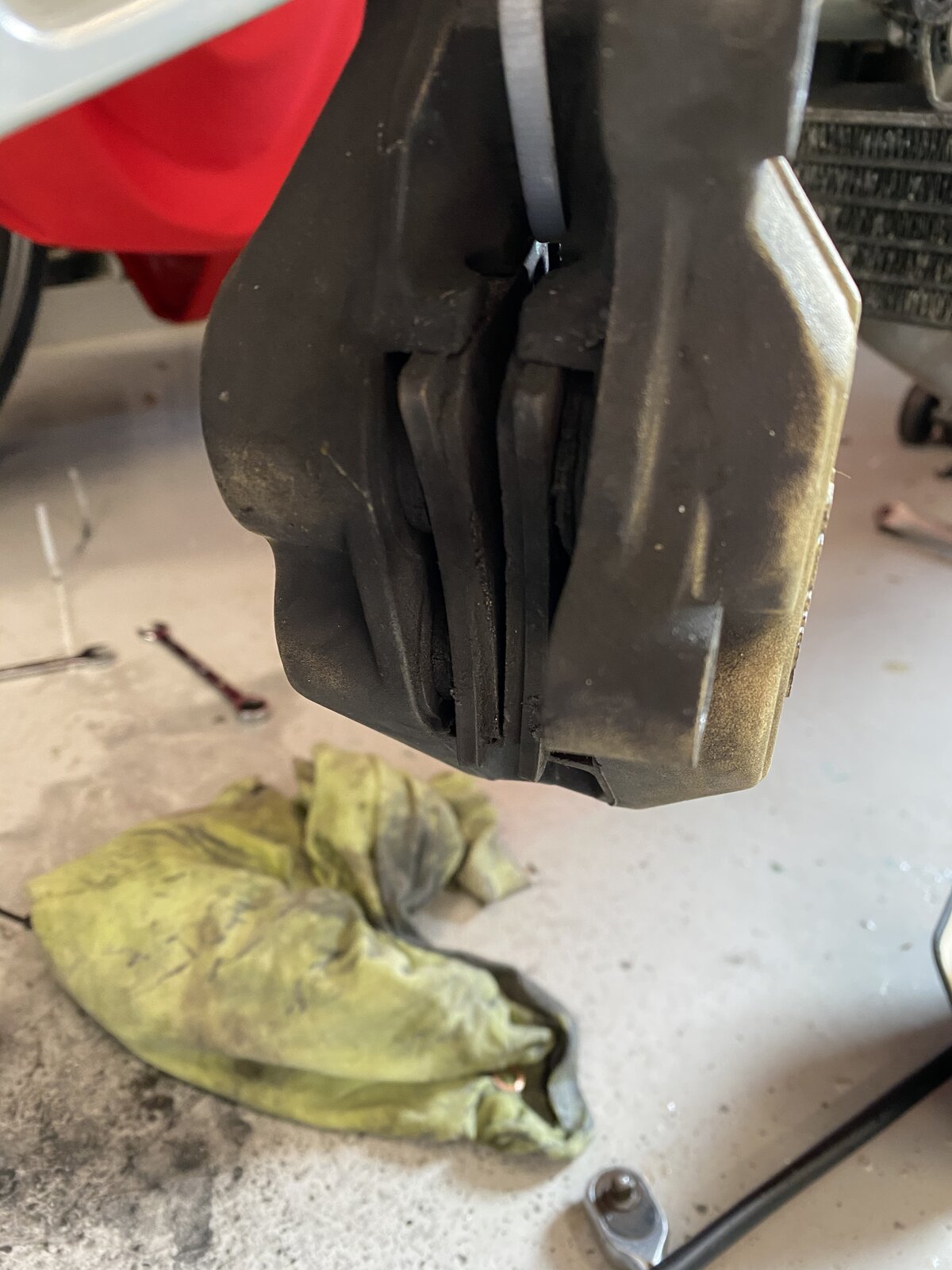

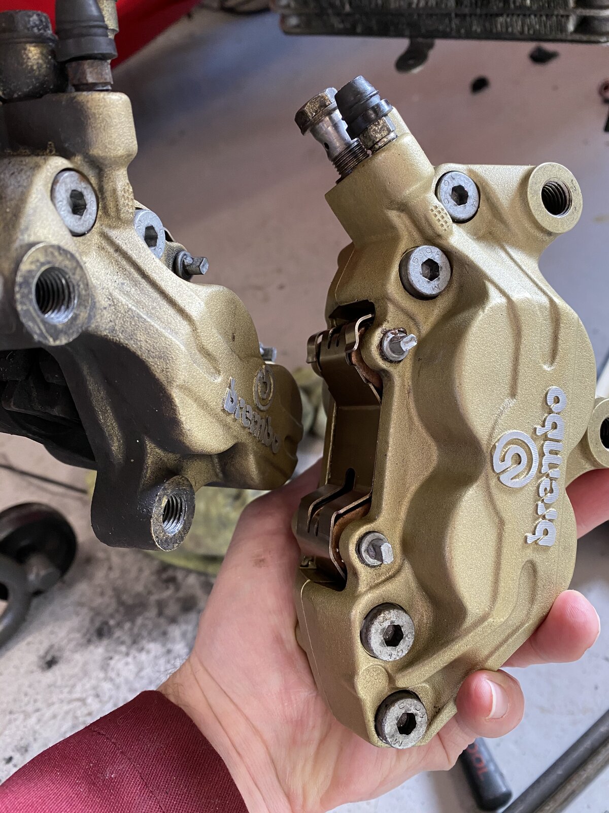

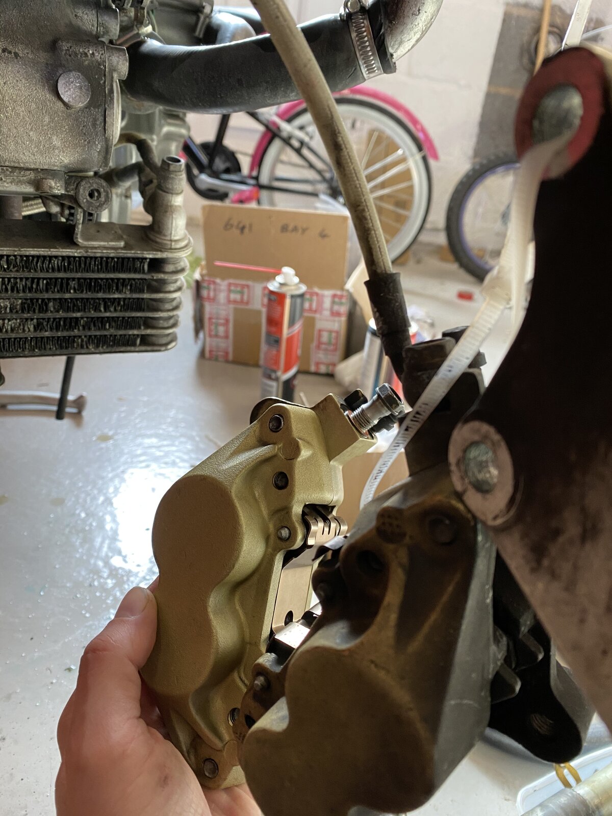

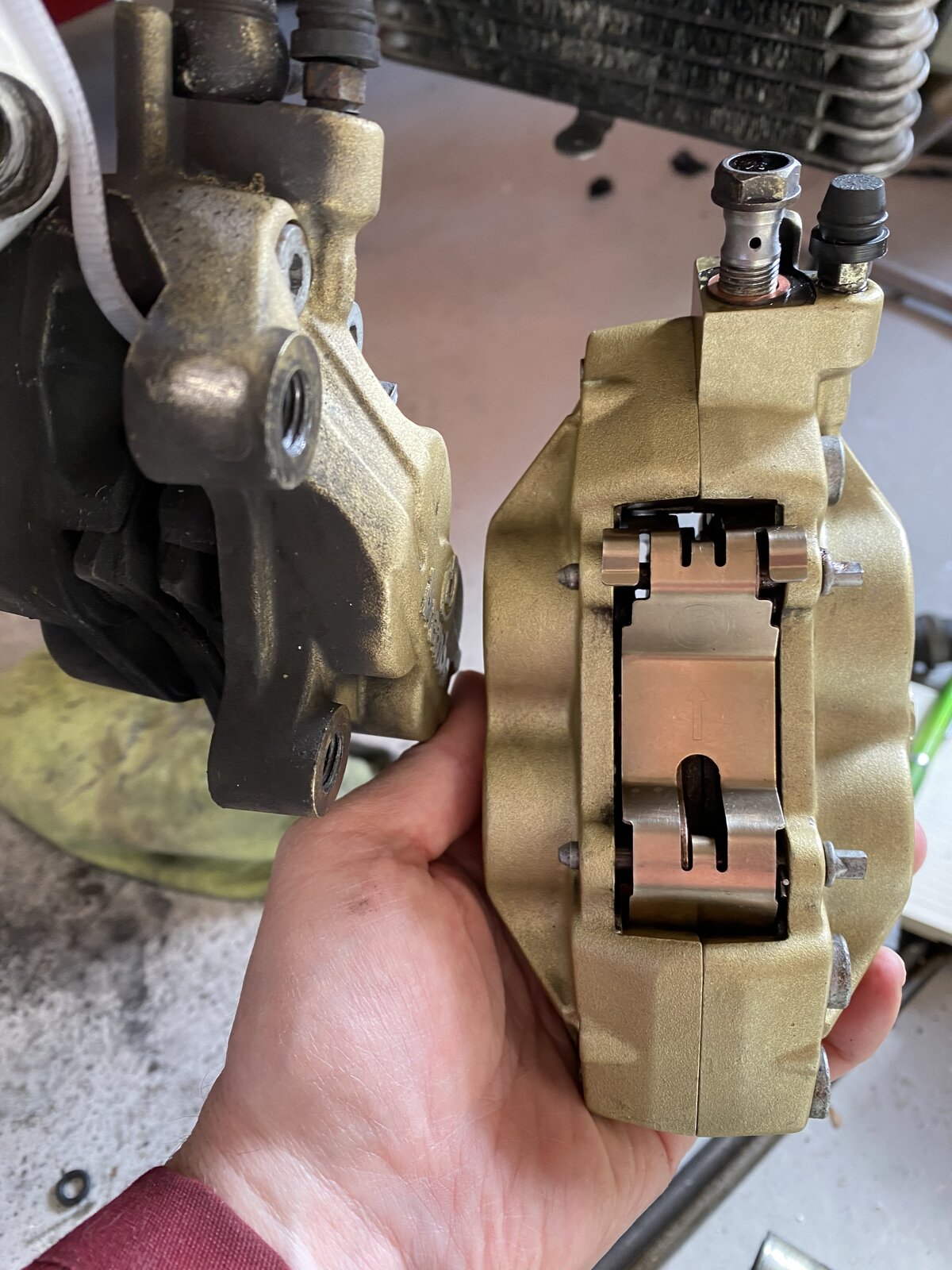

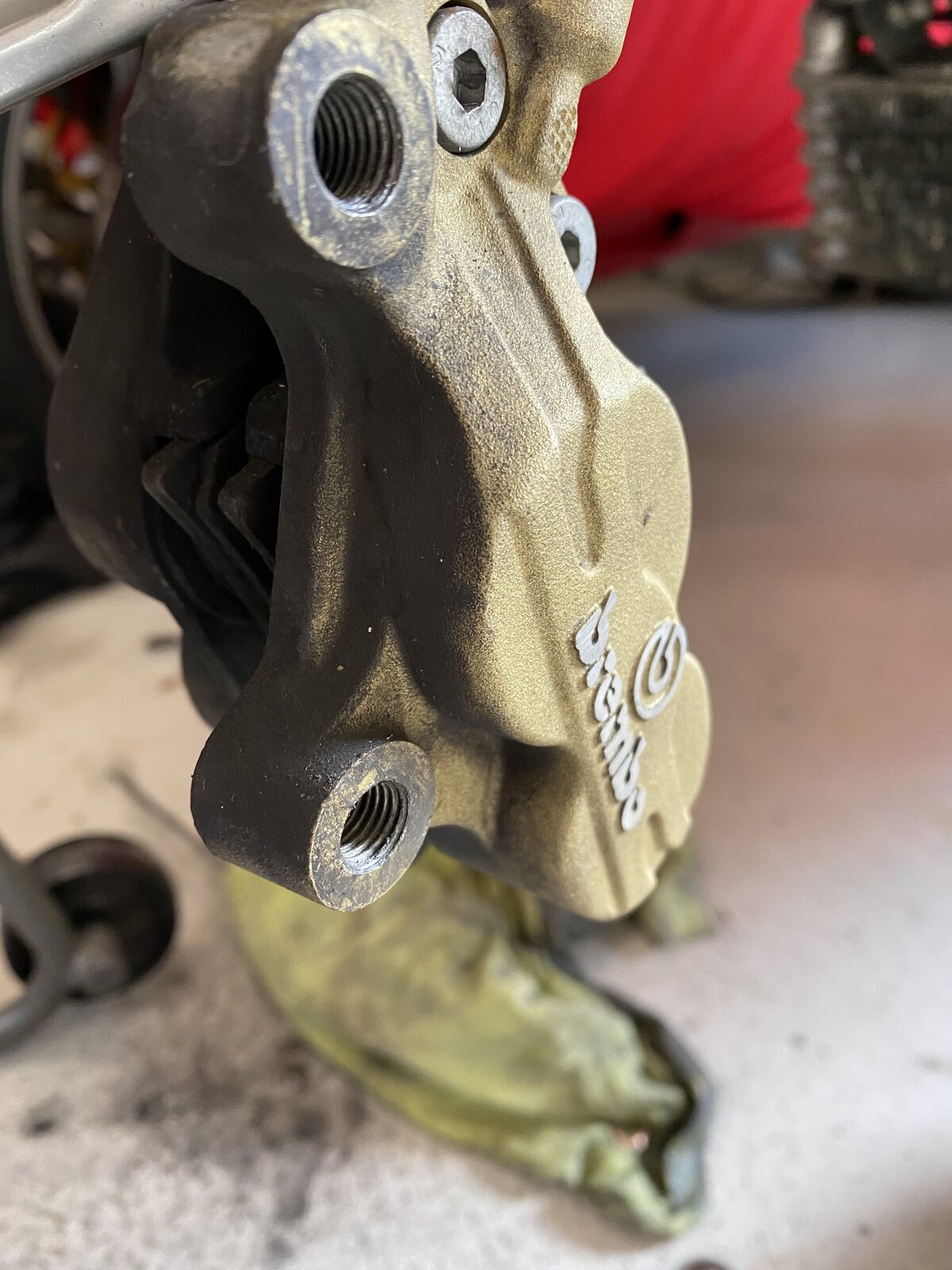

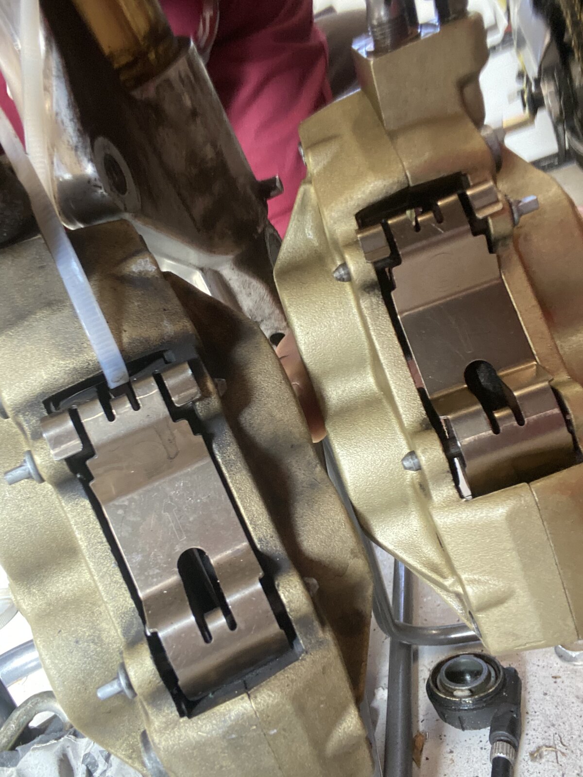

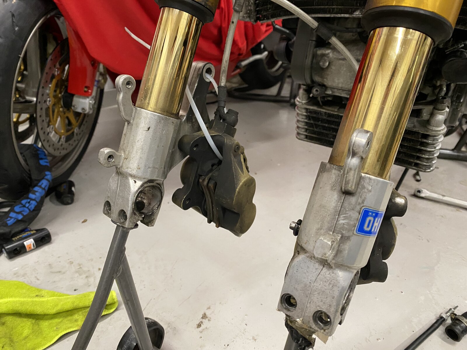

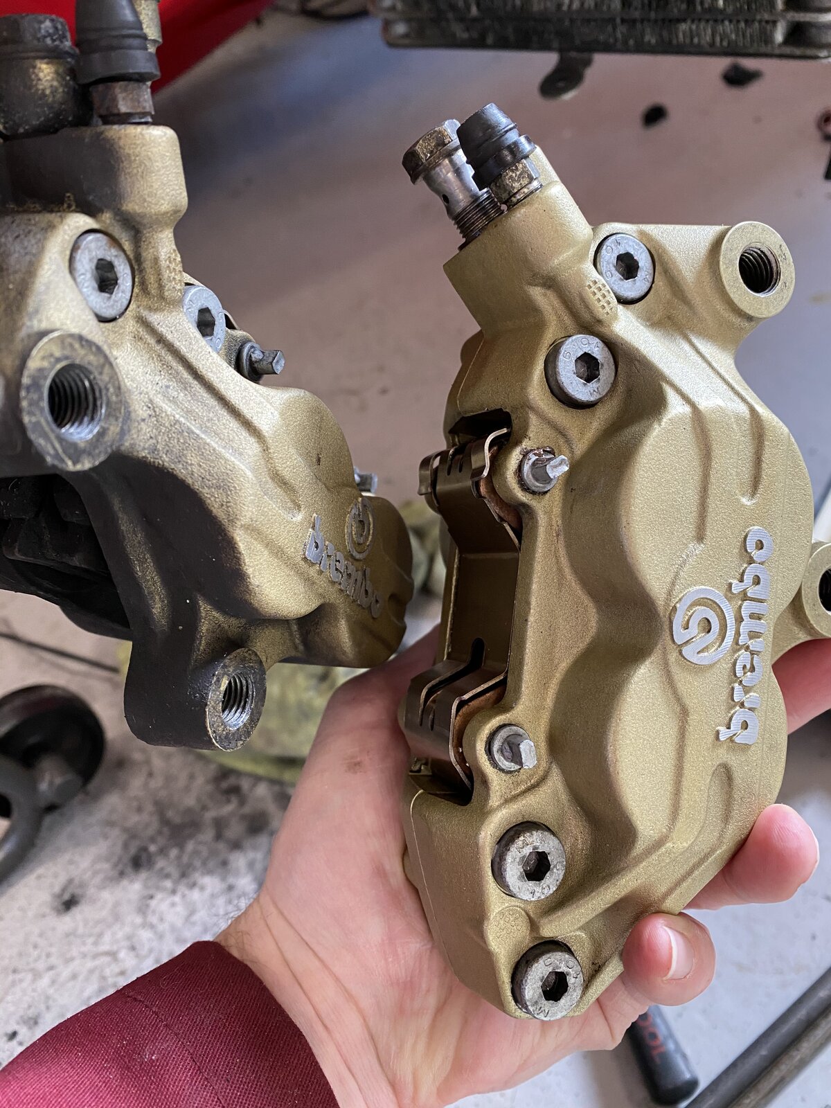

  12. Managed to get one done, but the other needs another go as it’s really baked on!
    this was with a combination of autofiniesse eradicate, wonderwheels and sdoc100. The sdoc did the bulk of the shifting though. Will wait to test out the bilt hamber on the remaining bits of the last calliper,
    • Like Like x 12
  13. Good job mate, that’s come up lovely. Very interested to hear how you get on with the Bilt product. I have the same job on my to do list in my project.
  14. Those fork bottoms have seen better days.
  15. Thankyou for the update images.
  16. Not too bad now they are cleaned up. The bike is just pretty filthy, it’s been sat 10 years

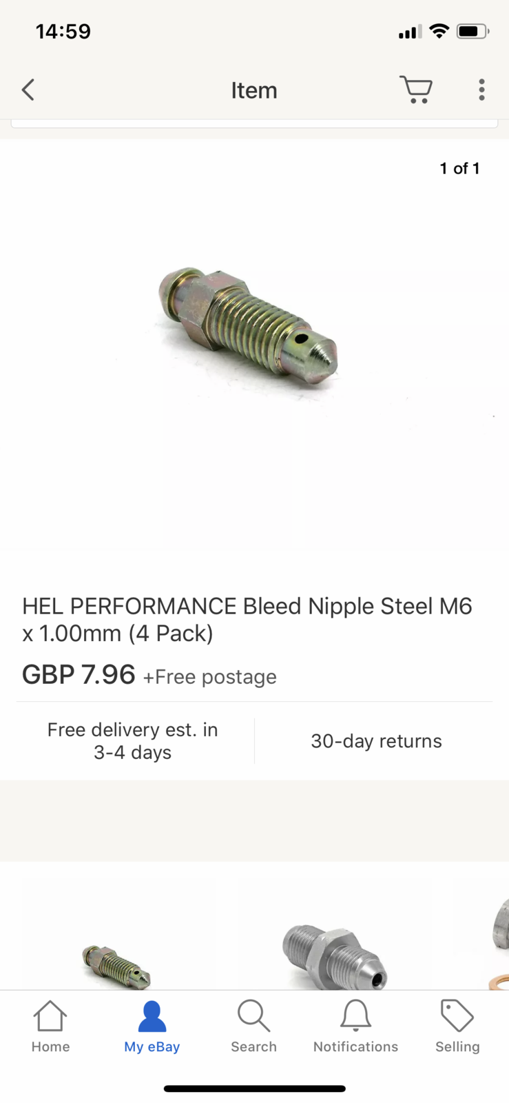

  20. Does anyone know the thread size of the bleed nipples for these?
    I looked about and found a size, ordered them but they are too small.
    this is what I ordered
