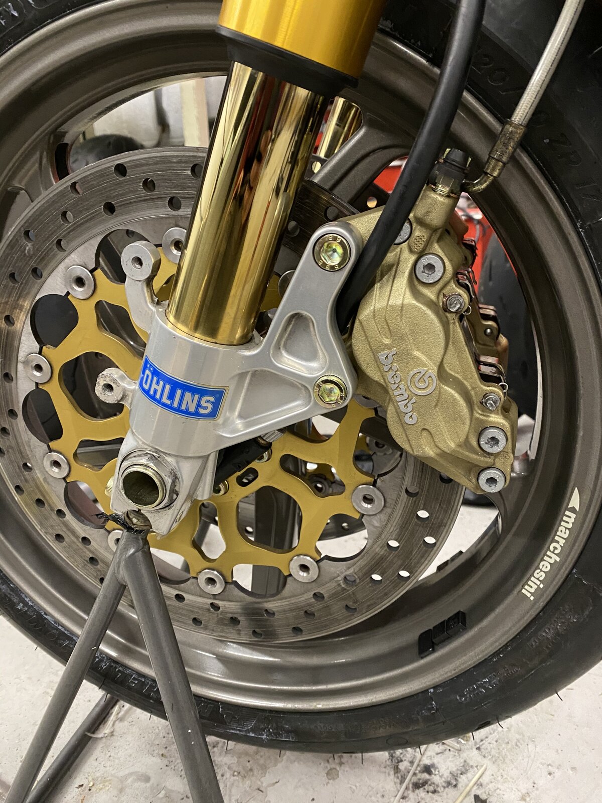

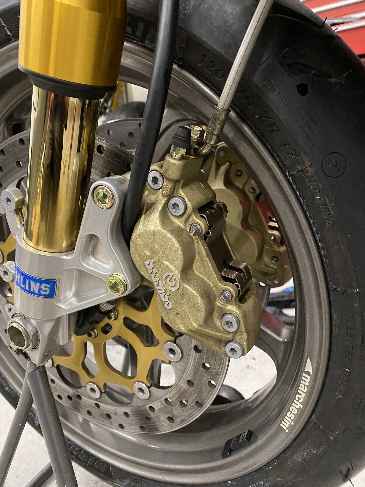

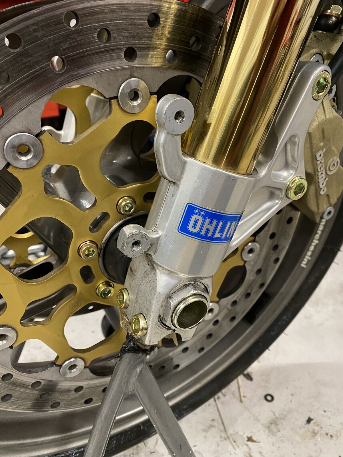

  5. Did you get new bolts for the caliper mounts and disk mounts or are they originals re-plated with yellow zinc?
  6. They are replated, but in honesty they are some of the best plating I’ve seen. So close to original

  7. They look really good, like new original ones, great job:upyeah:
