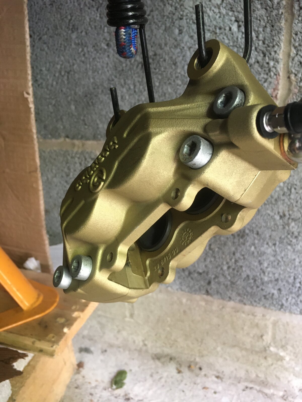

  2. Well, I am impressed. Don‘t say that too often these days as I mature into a semi professional grump. That Bilt Hamber stuff works so well. Cleaned up my callipers and all the goop engrained pads and hardware. It did take the golden anodising off the single spring clip that I had.. opps. Beware.
    What I did learn from my project bike is that the 2 callipers are slightly different, both goldlines, but one with the Brembo Logo skimmed with a milling machine to show the alloy, the other one just a thinner logo under a full gold finish... Hmmmn. A bit more cleaning later, and the pads etc tell me why. Someone has just swapped a calliper at some point, as they have different pads. That will be sorted shortly anyway.

  5. Not anodising, as they're steel not Aluminium. They're not old enough to be Cadmium plated, so they'd have been Zinc plated then passivated (the gold colour).
    Glad the Bilt Hamber stuff works well - bought some myself to try last week.

  7. Yes indeed, not anodising, I was being lazy and not googling the appropriate finishing process. But good to know how it was done. :):upyeah:
    At £25 each I think I will stick with the sliver look on one side..

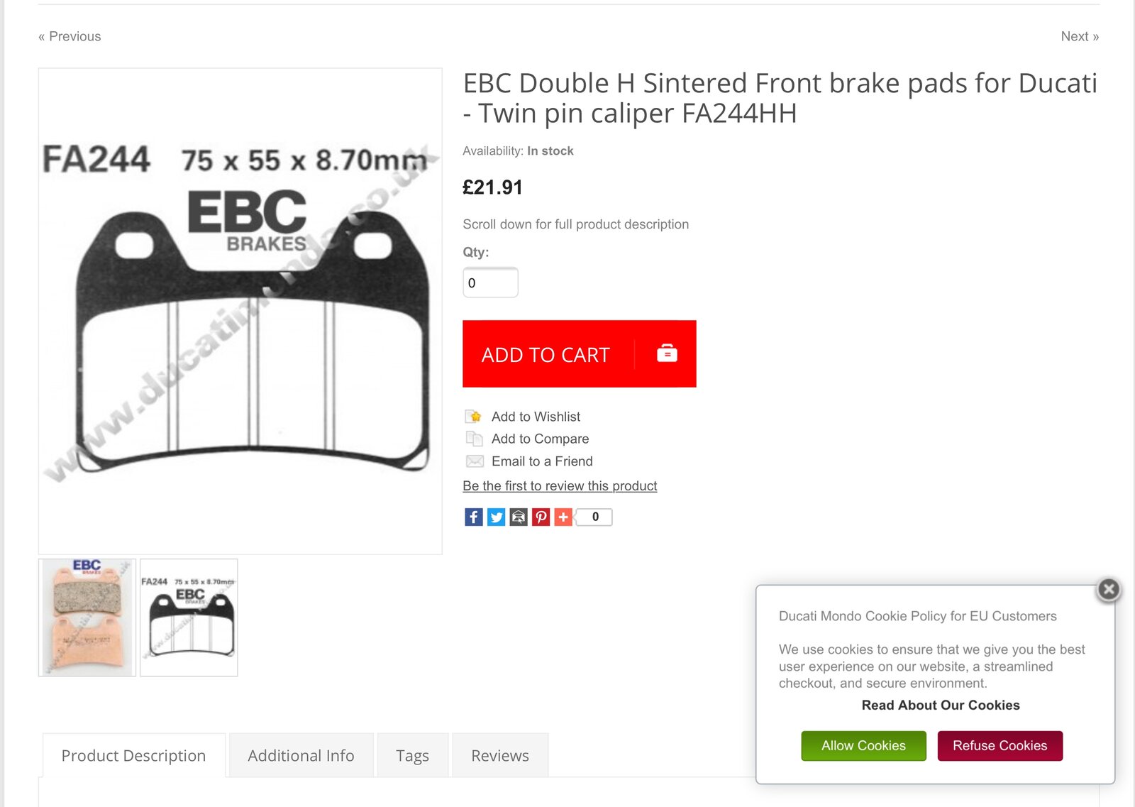

  8. As these Goldlines are non standard on my bike I am not sure which reference bike / year I should use to get the correct pads? Can anyone help there please?
  9. Looks like with a 748 filter, the correct sizes are pretty obvious... FA244..
  10. Yep, that’s what’s on my 99MY 748

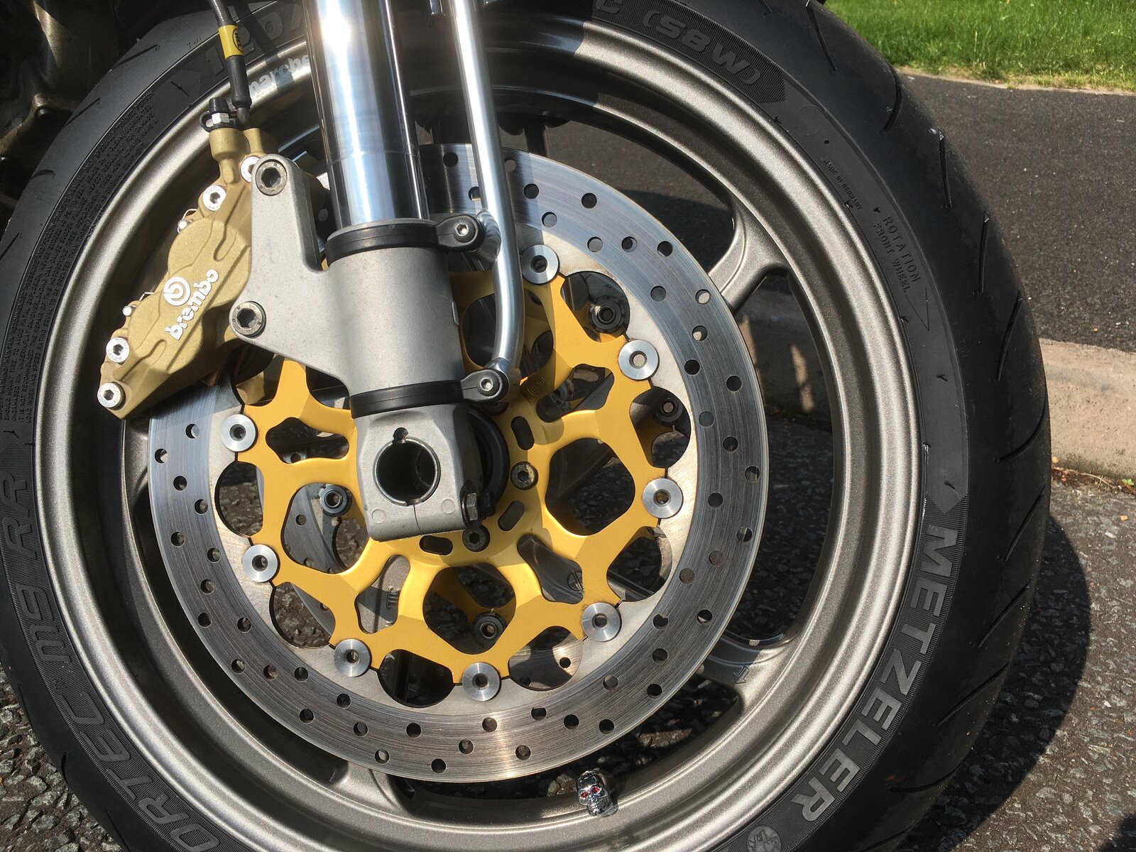

  11. Thanks for all the great tips fellas, out on the bike yesterday with my shiny clean callipers, Accu SS bolts and EBC HH pads and new pins. Great feel to the brakes, much more positive feel.
