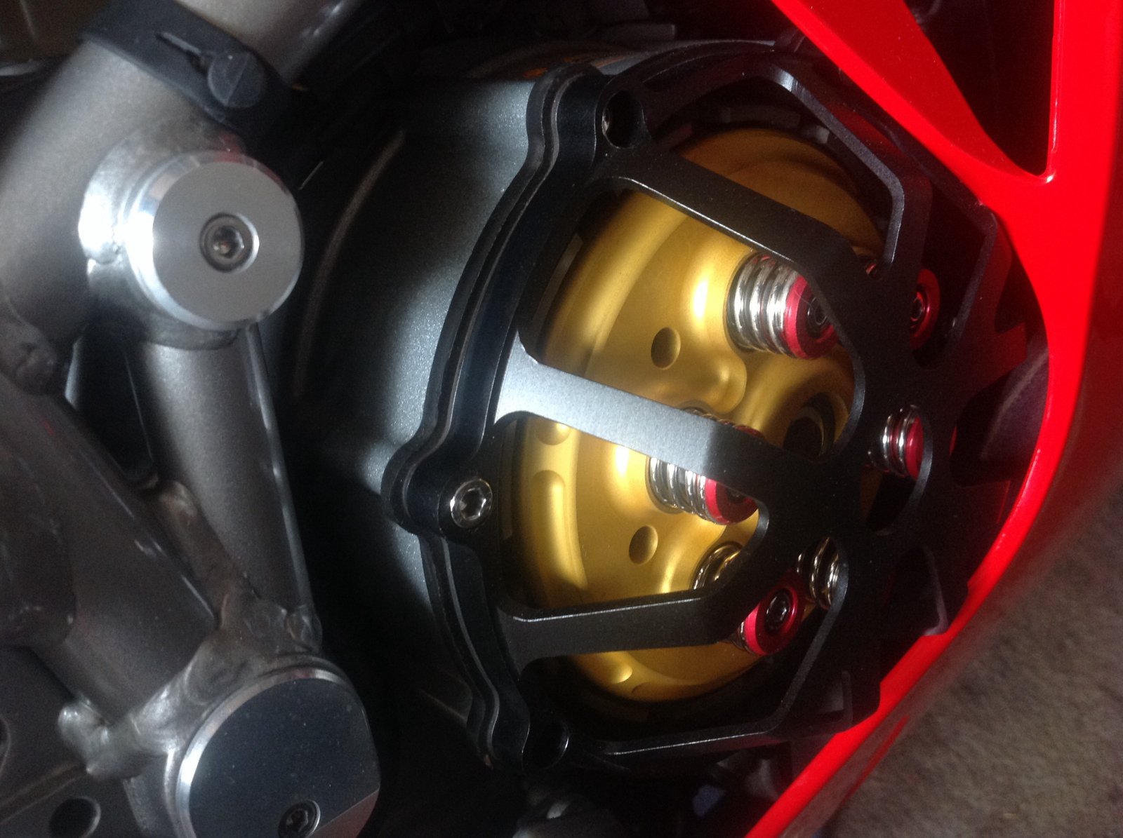

  18. I have rebuilt my clutch and converted it to a blingy open type.
    The plates are Suzuki GS650 pattern plates, which are reputed to be not only much cheaper than oem but much smoother as well.
    They are designed to be run wet though and seem to be prone to absorbing water, so I applied the lithium grease mod for good measure and cooked them at 200c until they stopped smoking as recommended.
    I imagine these plates could also be used in a slipper clutch in order to reduce grabbiness.
    I also stuck an extra friction plate under the first plain plate, as before, for the quiet clutch mod.
    So I'm wondering, am I alone in having a Ducati open dry clutch with Suzuki plates, the quiet clutch mod and the lithium grease mod???? :)
