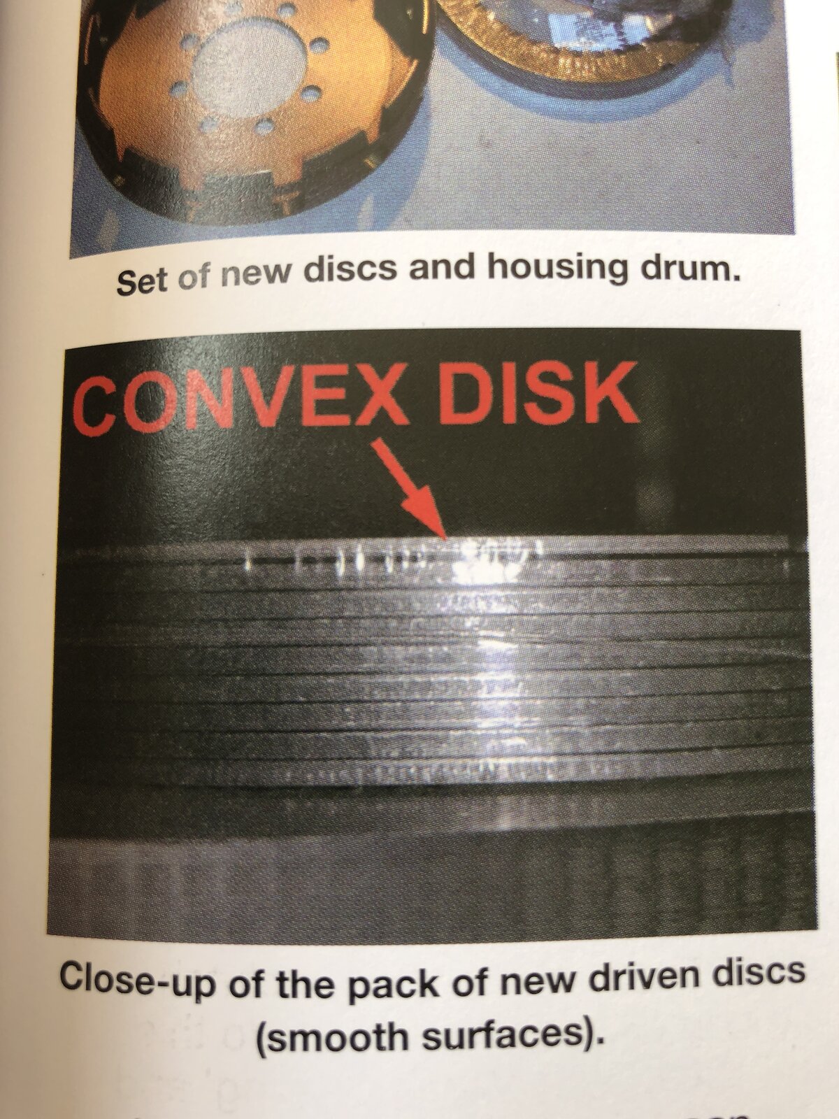

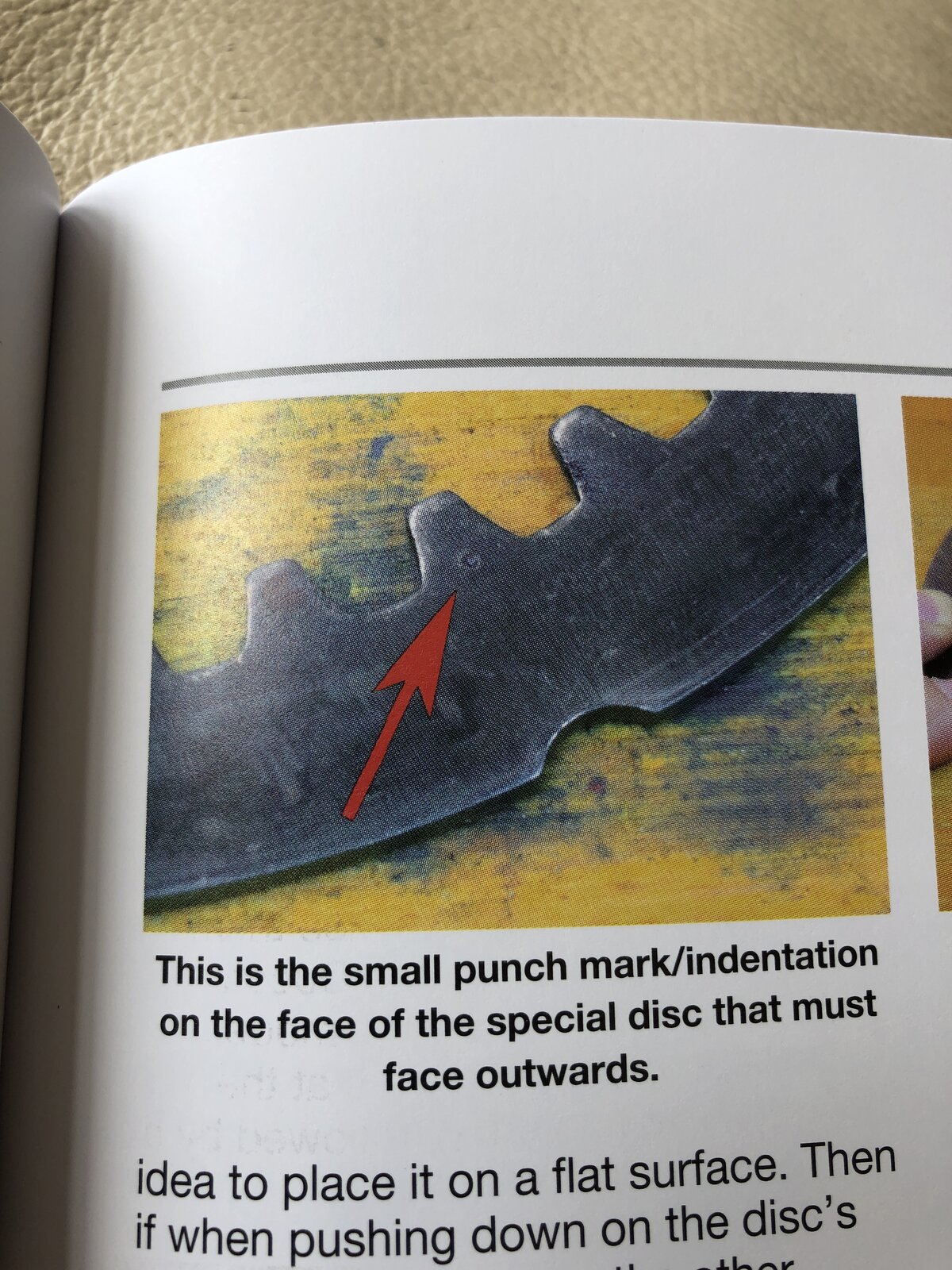

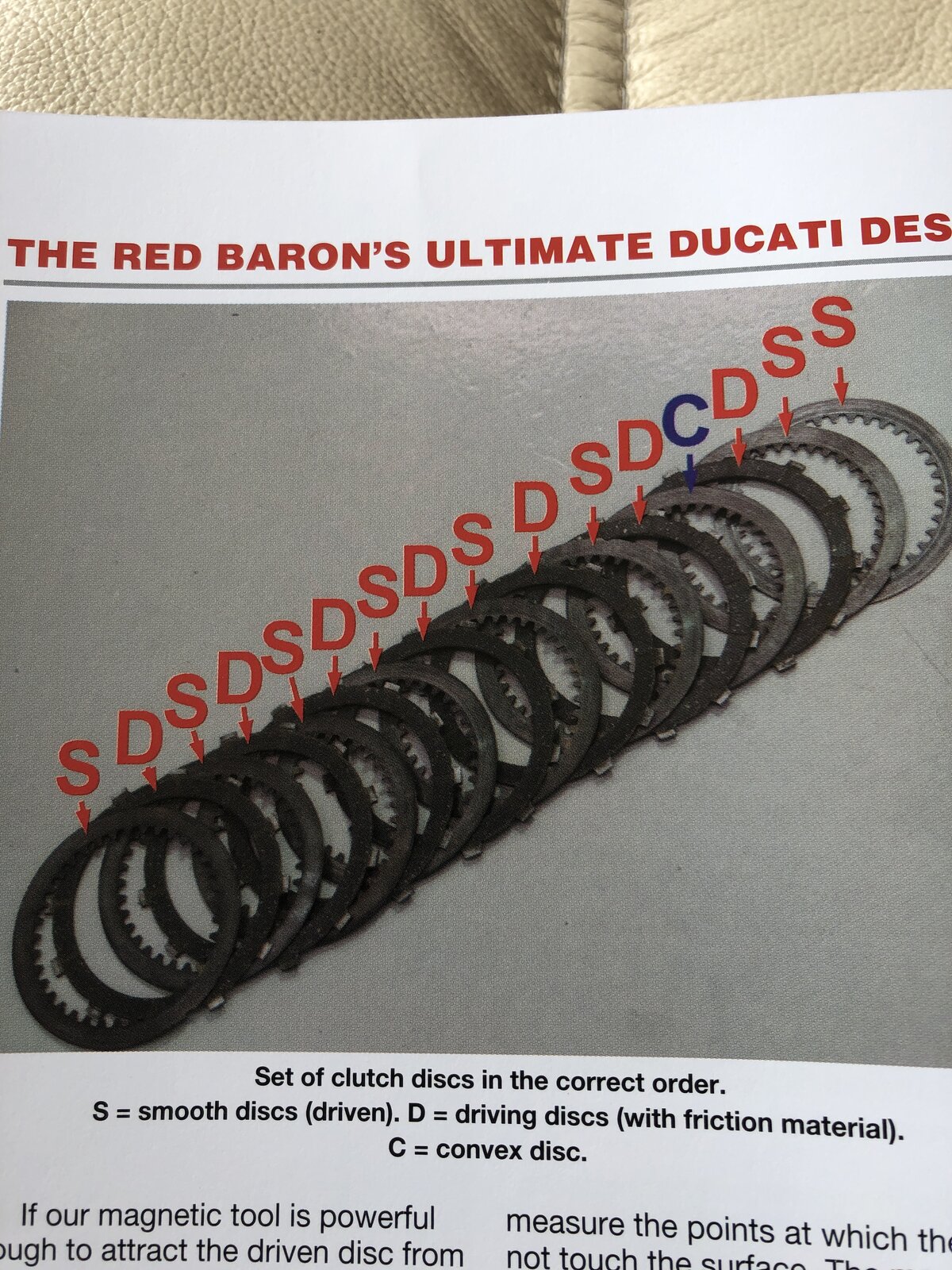

  8. Just to finish off this thread for anyone else reading it in the future @Expat Jack sent me some photos from The Red Baron’s Desmo book which show how to identify the dished plate and where in the stack it should go. Mine is presently in the middle so I’ll rejig it to make it the first after the first friction plate as per the photo.

    Either way I've been using all flat plates for years with no bother.

  15. Are you 100% certain they’re all flat? The difference is imperceptible. Without examining every single drive plate individually, both ways up, against the stack of others could I ascertain it. It is supposed to have a dot and I couldn’t see any dot on any plate. However, having found which of mine was the dished plate the other day when I rejigged them earlier today to get the dished plate into the correct place I found, hidden under some caked on clutch dust the tiniest of dots.
    clearly you know your bikes the best but there just might be one hiding in there you’re unaware of:thinkingface:
