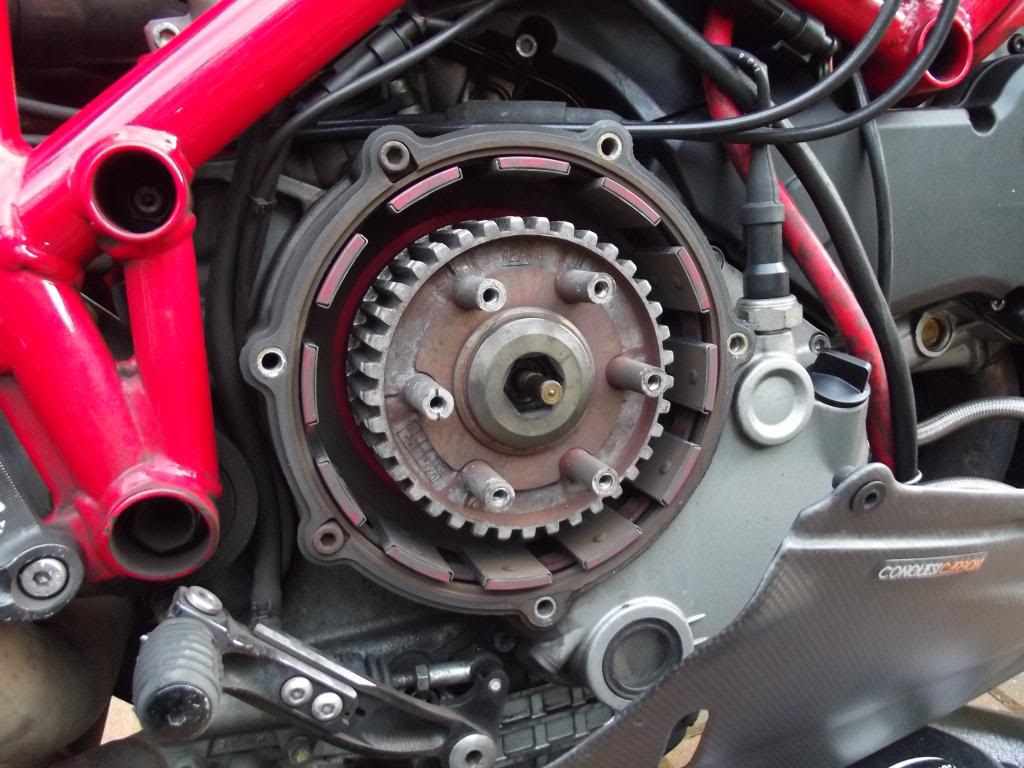

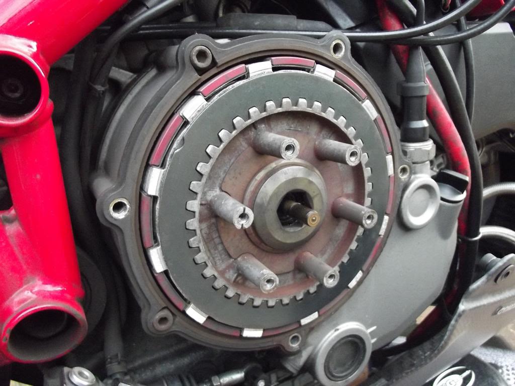

  4. Thats the problem though, the plate is seated as tight as it will go, right up against the plates inside. Got some more pics, but to be honest im fed up with it now :mad:
  5. I will say that is tight fit indeed as there should be bit more of that centre hub out. Take plates out, put only last one in and press on it to make sure it does all the way in.
    Also what kind of basket is it as it has some linear there inside it. If it runs all the way inside the back wall of basket then thickness of it visible on pictures looks about what you are missing.
    Look at manual of that basket is it might say to skip for a plate or to use more 1.5mm steel plates.
    Finally if it is indeed Barnet pack then I guess it came with friction and steel plates.
    Take steel plates (except the dished one) form old one and put them in place of new steel plates.
  6. Its a reinforced Barnetts basket, hence the additional steel, which helps it last about 3 times longer. The hub is the original and its the Barnett plates that have worn out. I picked up a OEM clutch set, so frictions and steels. Seeing as these are supposed to go with the hub, I dont know what the problem is. The only thing I can think of is one or more of the friction plates is a fraction too wide. I measured the steels and they are the same width as the Barnetts ones. Its not a problem with the basket, of that i'm sure.
    Took it out for a ride again and there is no slip, but when in gear, clutch it, the pressure plate goes too far out and stops spinning. It does seem to locate again when moving off, but as you can imagine, I'm not happy with that all. Is it a bedding in issue, ie after a few miles it will close up?
  7. Does the pressure plate seat properly with no clutch plates fitted? thus determining it is the plates at fault.
    Is the centre hub nut tight and the hub solid - I had one where the large washer between hub and nut 'ate' into the hub, allowing the hub to come away from the shaft a couple of mm but it would push back in.
    Don't get too hung up about plate quantities and layout, I don't use any 'dished' plates and even have 1 extra friction - I removed one of the first 2 plain and 'shuffled' some thinner plain plates (to get more) into the thicker one's spaces to get the right pack thickness - doesn't make any difference to operation.
  8. Yep, the PP sits fine up against the hub when I take out the last steel. So from my reckoning the only place I can take a steel out is from back of the stack where the two go together. My only concern is that there must be a reason why they need two steels.
