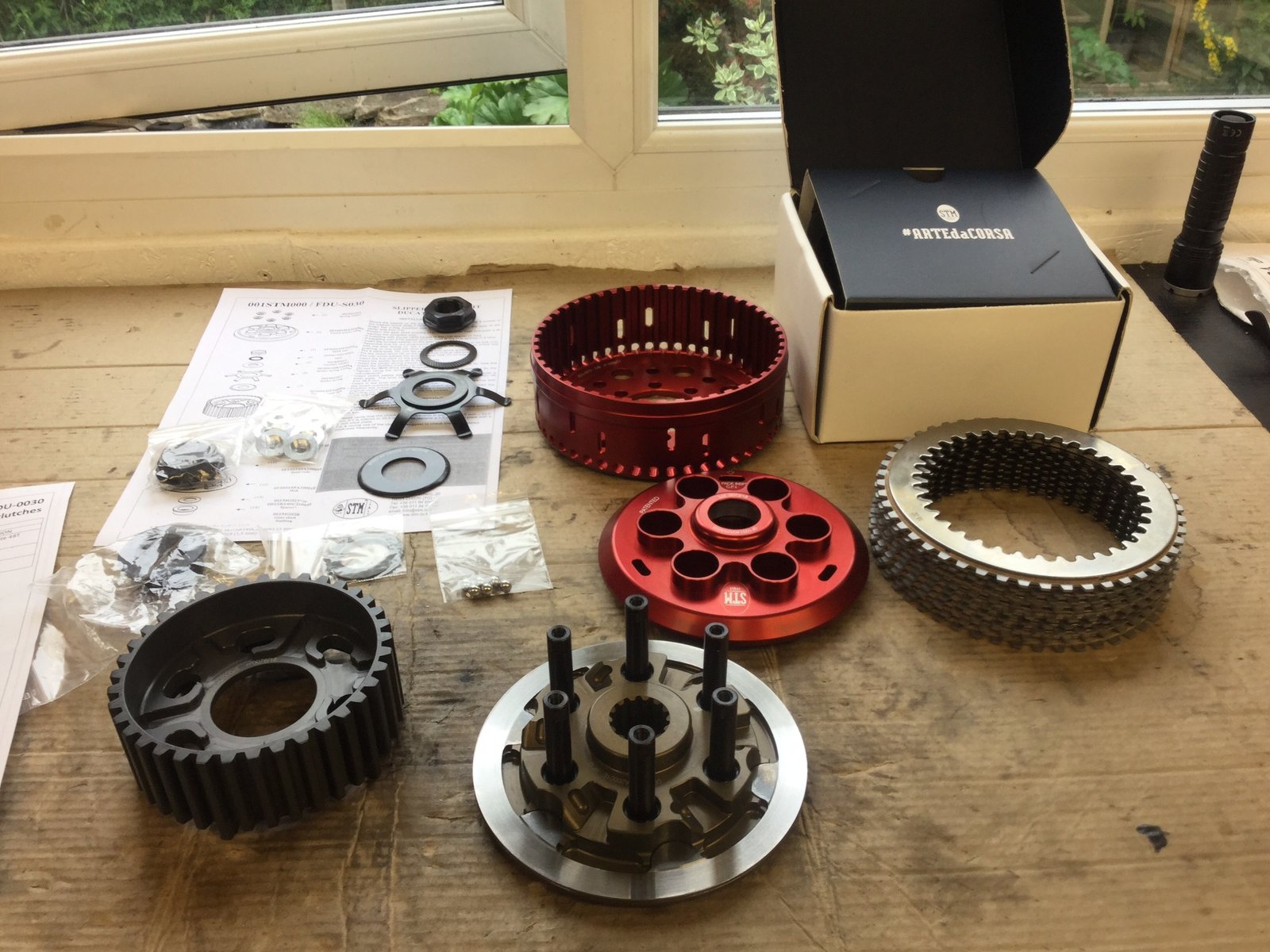

  12. Alright RickyX I have just come back from a long time away with work and unwrapped my new clutch and stood staring at it lovingly. Did yours come with 6 springs and bolts to hold them in with?
  13. Yes.
    Does yours?
  14. No looks like I will have to email them. This could only happen to me.
  15. D148F6E1-74C3-44DD-A3BD-86A2172CCD93.jpeg Actually, I just looked at the pic of what was in the box and it appears that springs and bolts were not included.
    I re-used the ones I already had.

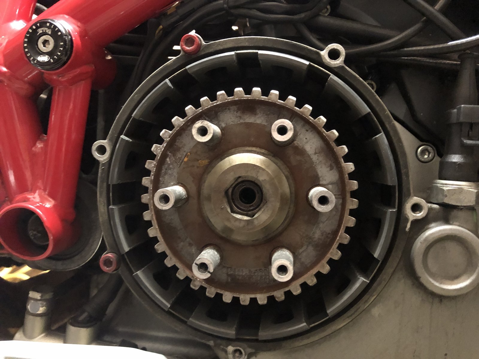

  16. Yep when I looked at the instructions and thought I need to brush up on my Italian, I then turned over the page and found it in English which said use your old ones lol. However I got cracking on it tonight until I come to release the nut to find it isn't a conventional nut it has a hex key at the size of 19mm, the one tool I don't have is anyone else come across this?
  17. I've never seen that before. :confused:
  18. Nope, not seen that before.
    Still, the new clutch comes with a proper hex nut.
  19. Use a bit of 19mm hex bar with a 19mm socket ontop.
