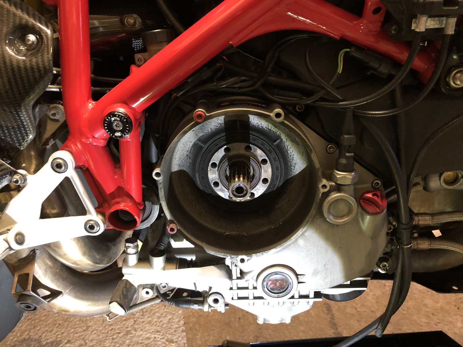

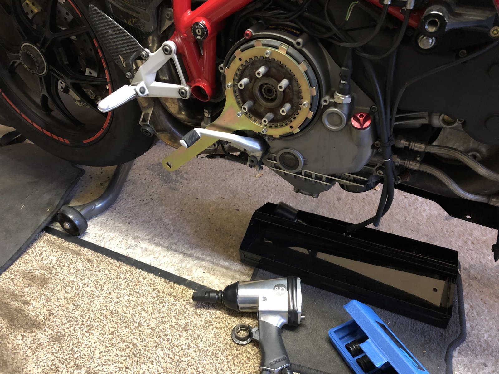

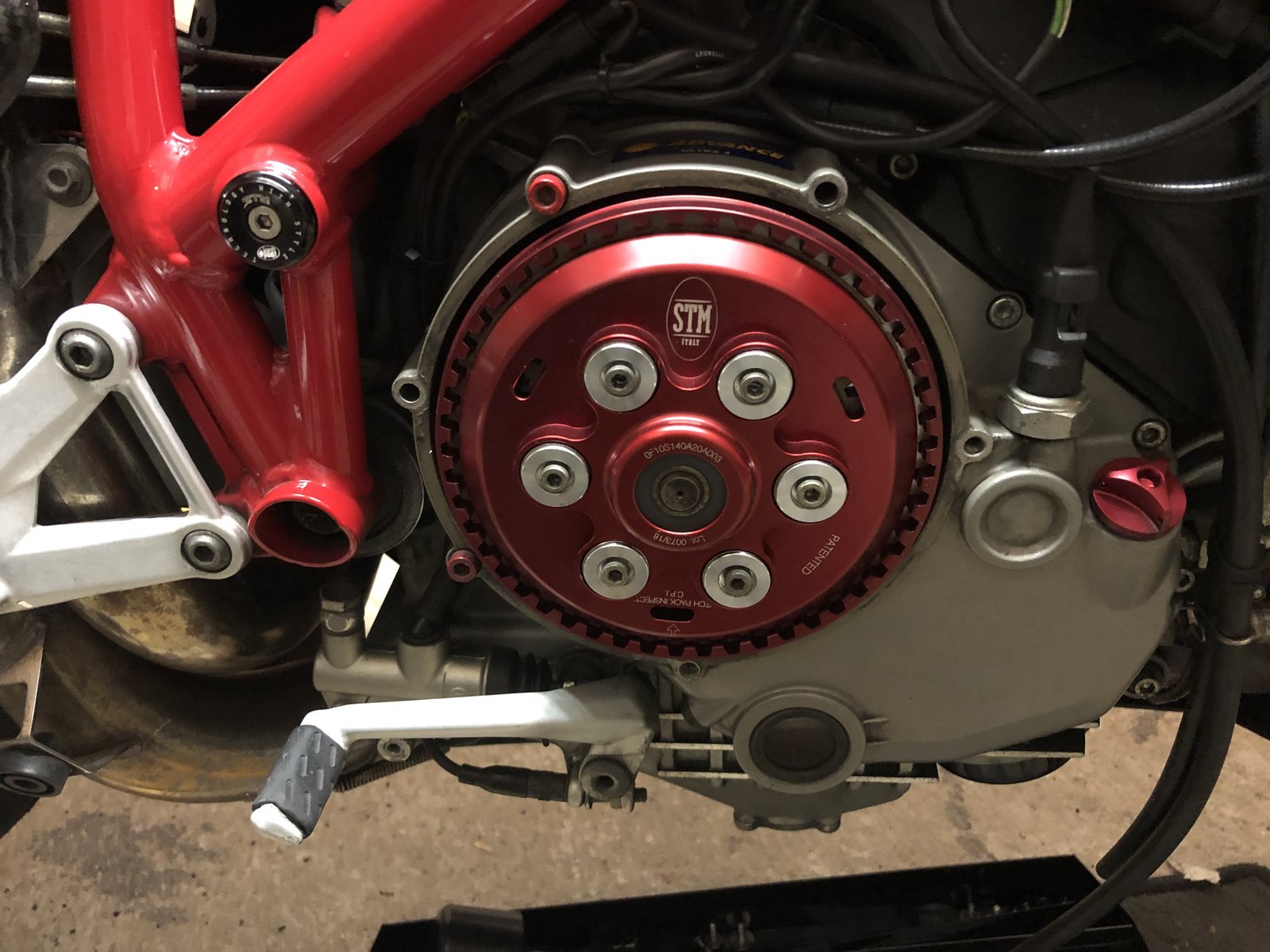

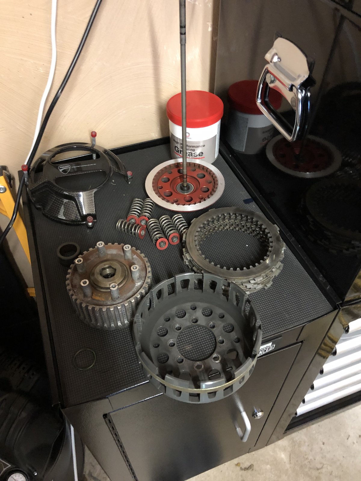

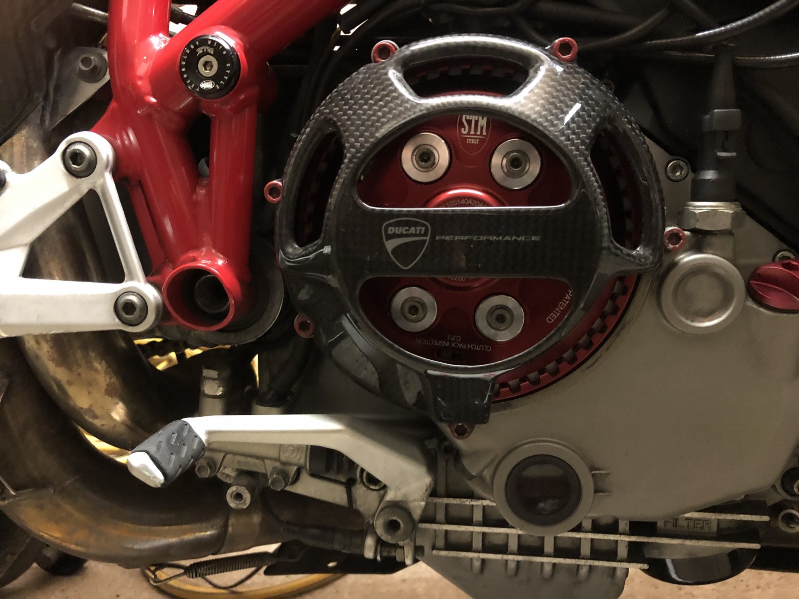

  2. 6711CA32-A060-480E-9DC7-CB687E70045B.jpeg 6A5F7829-785D-43FA-99D0-DB7C7DE9981C.jpeg Mission accomplished and not a lot of effort required at all, does anyone know what Ducati charge in labour for a clutch change?
  3. Test ride complete and what a difference I should have changed it ages ago, if anyone is after a new clutch then get one of them. I can actually pull off from the lights knowing it won't stall on me and I can actually hear my Termis not a rattling clutch. Massive thanks to RickyX and everyone who has contributed to this thread.
