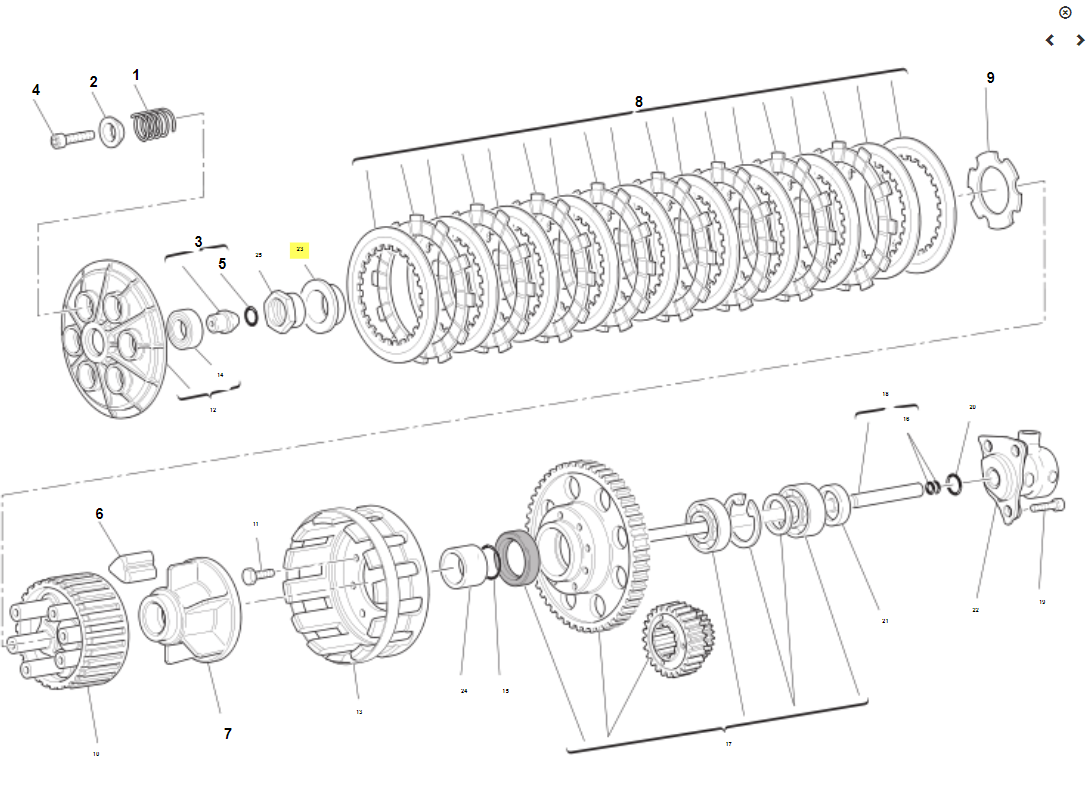

  7. Who mounted your clutch? Is the large spacer under the clutch hub installed?
    #27 jusutus, Apr 28, 2020
  8. Sorry, highlighted the wrong spacer - meant #23. Pic now edited.

  13. never stripped yours with cushdrive but looks similar to that fitted to earlier belt 2v, just a hunch, but wondering if drum (10) has become loose on cushdrive hub (7), enough to move separately from it? managed a closer look on vid below (if the same).
