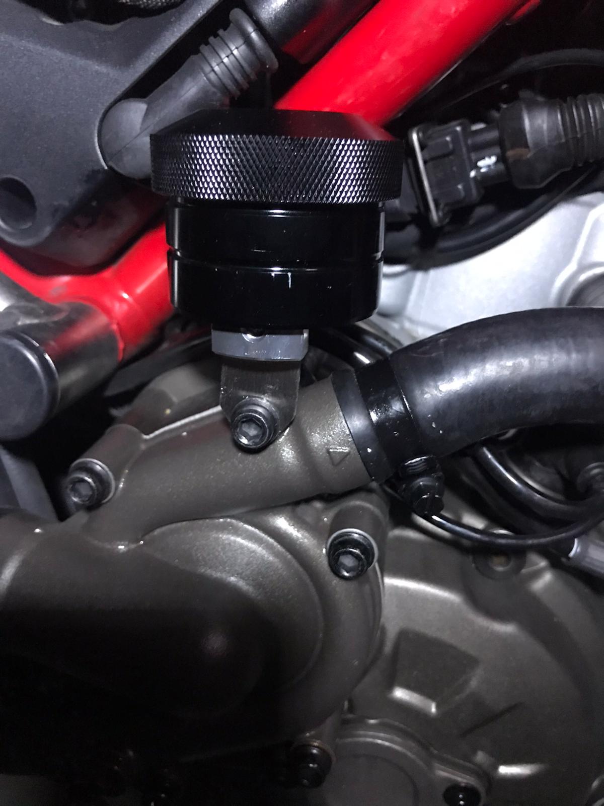

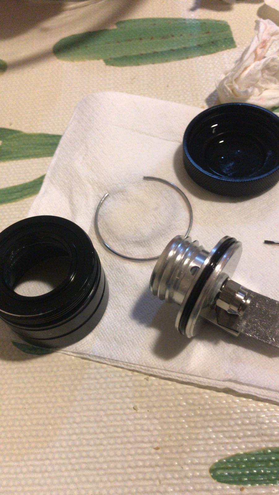

  2. O-ring changed for a little bit thicker, and nothing comes out

  3. Was it leaking?
  4. yes, when I turned it to give it pressure, I lost a small drop every several minutes between the two walls, but it comes apart easily, and changing the O-ring is a 1 minute and 5 cent euro job, very easy, once this is done Happy with the work he does, easy, clean, and on a 3,000km trip, you don't have to be aware of carrying grease for the chain. every 300km approx. stop to fuel and turn it 1/4 turn, and happy

  12. Even Ducati say to use gear oil on the chain ...

  15. Sorry for the delay, when you have the oiler screwed to the maximum, underneath you have access to a metal ring that is seen in the photo that I put disassembled, it goes in a recess simply by pressing it comes out, with the tip of a small screwdriver, and already You can unscrew until you see the O-ring, the two outer and inner bodies remain independent and as seen in the photo that hangs.

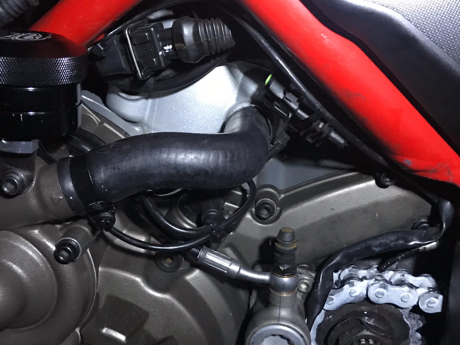

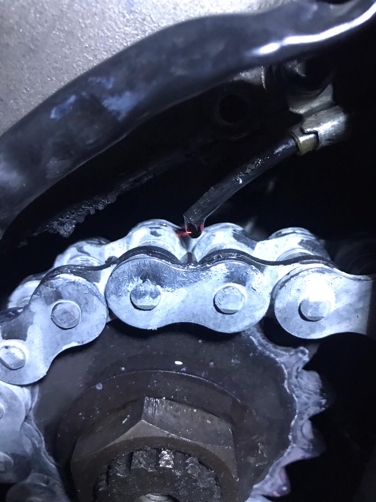

  16. Chuki , oiling the chain on the top run of the front sprocket , doesn't that tend to throw oil off as it goes round the sprocket on normal drive direction, I've fitted mine so it drips oil onto the lower chain run going away from the drive sprocket, just wondered......
  17. if it accelerates strongly when it gives pressure to the oil can, if it can spill drops wildly, but what I do as I put it, is to raise it in the central support, give it pressure 1/4 of a turn, and push the wheel 2 minutes with the boot without walking, on the same central support, when this time passes, there are hardly any drops anymore, and the chain is well oiled, is what you see in the video posted in this post. It doesn't mess, for sure
